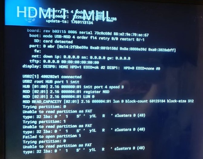

The image shows exactly what is happening. Your EEPROM configuration is correct - the bootloader IS attempting USB first (“mode USB-MSD 4 order f14”). The USB drive IS detected and enumerated:
USB3[3] 00281203 connected enabled
MSD [02:00] 3.32 0000e003 register MSD
MSD READ_CAPACITY... block-count 60125184 block-size 512
The 30GB SanDisk is recognized at hardware level. However, partition reads fail:
Trying partition: 0
Unable to read partition as FAT
type: 32 lba: 0 ' 1 S' y1L R ' clusters 0 (48)
This is garbled partition data. The bootloader cannot read valid FAT partition structure, so it falls back to SD card.
This is a known problem with SanDisk Ultra Fit drives. These drives have firmware quirks that prevent proper reinitialization during warm reboot because USB power does not cycle - the drive remains powered but does not reset its internal state. Cold boot works because full power cycle forces complete reinitialization.
Had you mentioned the exact USB hardware in your initial post, this would have saved time and effort - SanDisk Ultra Fit compatibility issues with Raspberry Pi bootloaders are well documented.

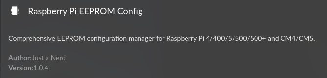

  1. Use the Raspberry Pi EEPROM Config plugin (shown in screenshot)
    This plugin provides a GUI interface to modify EEPROM bootloader parameters. Install it from the Volumio plugin store, then navigate to its settings page. Add the timing parameters there and apply.

The plugin method is cleaner and provides validation. The SSH method is faster if you are comfortable with command line.
