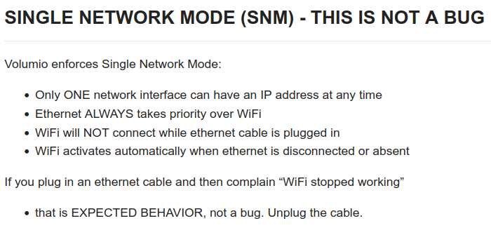

Cable now unplugged, system power cycled and still showing the same screen. I originally plugged Ethernet in after the WiFi/Hotspot did not work. I should have added that there is an Edimax WiFi dongle plugged in - it has a blue light on it - but this illuminates after the 127.0.0.1 is displayed.

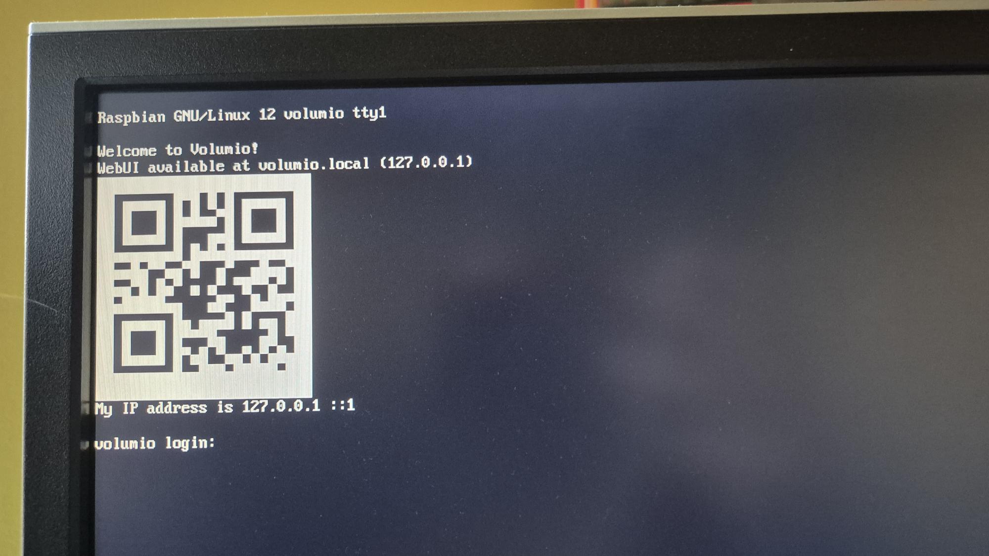

  1. Actual symptom
    It stuck at “please wait to finish startup” and the animation above was continous rebulding
    it freeze at that point but the animation was moving on
    I was waiting for five minutes and then i powered off and on and the symptom has repeated.

Did you try to connect a keyboard directly to Pi and press “TAB” or “ESC” key to see the output message?

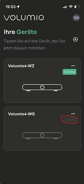

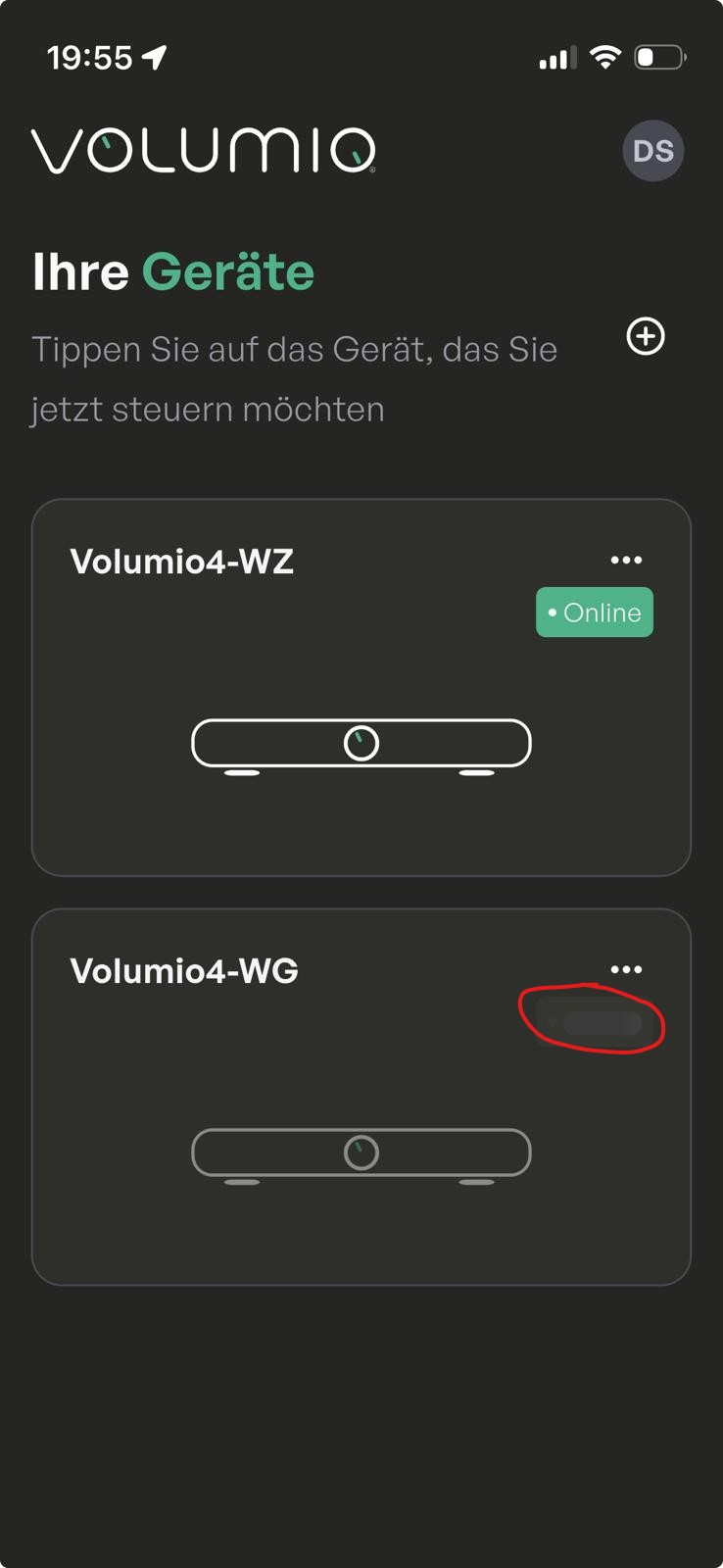

Thirst I have noticed (only PI4b): The icon marked red in the ios app is blinking Green/White:
This happens in the same frequency as the following sequnce appears in the log:

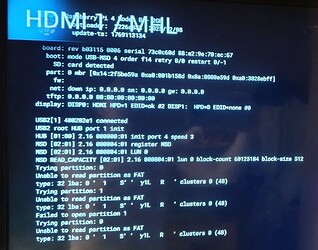

Hi.
I tried to do it according to point 1.
Anyway, with a warm reboot, it won’t boot from USB, but volumio will load from SD. It is loaded from USB during a cold start.
[all]
BOOT_ORDER=0xf14
BOOT_UART=0
WAKE_ON_GPIO=1
POWER_OFF_ON_HALT=0
USB_MSD_DISCOVER_TIMEOUT=10000
USB_MSD_PWR_OFF_TIME=2000
USB_MSD_STARTUP_DELAY=2000
USB_MSD_BOOT_MAX_RETRIES=2
ENABLE_SELF_UPDATE=1
Hey @maxxxmm,
The EEPROM timing parameters confirmed what I suspected - this is a hardware limitation that cannot be resolved through software configuration.

Hey @MisterP,
This was previously discussed in this thread:
We need diagnostic logs before we can investigate. The wireless debug log will show exactly what wireless.service decides during boot and why.
  1. Boot with ethernet cable connected to router
  2. Check your router’s DHCP client list for Volumio’s IP address
  3. Access GUI at http://volumio-ip
  4. Enable wireless debug via SSH:
sudo sed -i 's/DEBUG_WIRELESS=false/DEBUG_WIRELESS=true/' /volumio/.env
  1. Reboot:
sudo reboot
  1. After reboot, unplug ethernet cable
  2. Wait 30 seconds - check with your smartphone for a WiFi network called “Volumio-xxxxx” (the hotspot)
  3. Plug ethernet cable back in
  4. Generate log link via http://volumio-ip/dev
  5. Download wireless.log via SFTP:
    • Download FileZilla (or any SFTP client)
    • Host: your Volumio IP
    • Username: volumio
    • Password: volumio
    • Port: 22
    • Navigate to /tmp/
    • Download wireless.log to your computer
  6. Zip the file on your computer and upload to file transfer service of your choice like https://wetransfer.com or https://catbox.moe
  7. Share both the log link and the zip file link here
The timestamps must be from the same session so we can correlate events between both logs.
Hey @becool,
The screen not showing expected output does not mean the system is not running. Volumio backend may be fully operational - we need logs to see what is actually happening.
Do NOT reboot or power cycle before retrieving logs - /tmp and /var/log are volatile and contents are lost on reboot.
If connected via ethernet:
  1. From another device on same network, open browser
  2. Go to http://volumio.local/dev or http://<IP_address>/dev
  3. Send logs and paste the URL here
If not connected via ethernet:
  1. Check if Volumio hotspot appears in your WiFi networks on a phone or laptop
  2. Connect to the hotspot
  3. Complete network configuration via the setup wizard
  4. Once connected to your network, go to http://volumio.local/dev
  5. Send logs and paste the URL here
Until we have logs, we cannot determine what is causing the startup to hang while the animation continues.

Sonos: This logs are after changing the Sonos setting as written above and a fresh restart. On my Sonos device all three were off. Changing it to your settings solved the problem → Thanks
wireless.js CPU consumption: Sorry - I do not know what I should confirm or check here. How can I see if it uses 99%? The Pi4B is on ethernet with wifi disabled in the GUI → So could this also a problem from the updates of this device? The PIZero is only on wifi
upmpdcli service failure (both devices): I have disabled UPNP on both devices - could this be the cause? If not - which function is affected by this problem?
volumio5-onboarding BLE failure (PI4B only): Ok → means here is nothing to do for me - you must fix this?
Why is the system trying to update all the time?: You can see that this sequence loops on the PI4B every few seconds - in the same frequnency the Online button in the app is flashing. I had this after every reboot - and it looped forever. Gone since the fresh install (I think).
