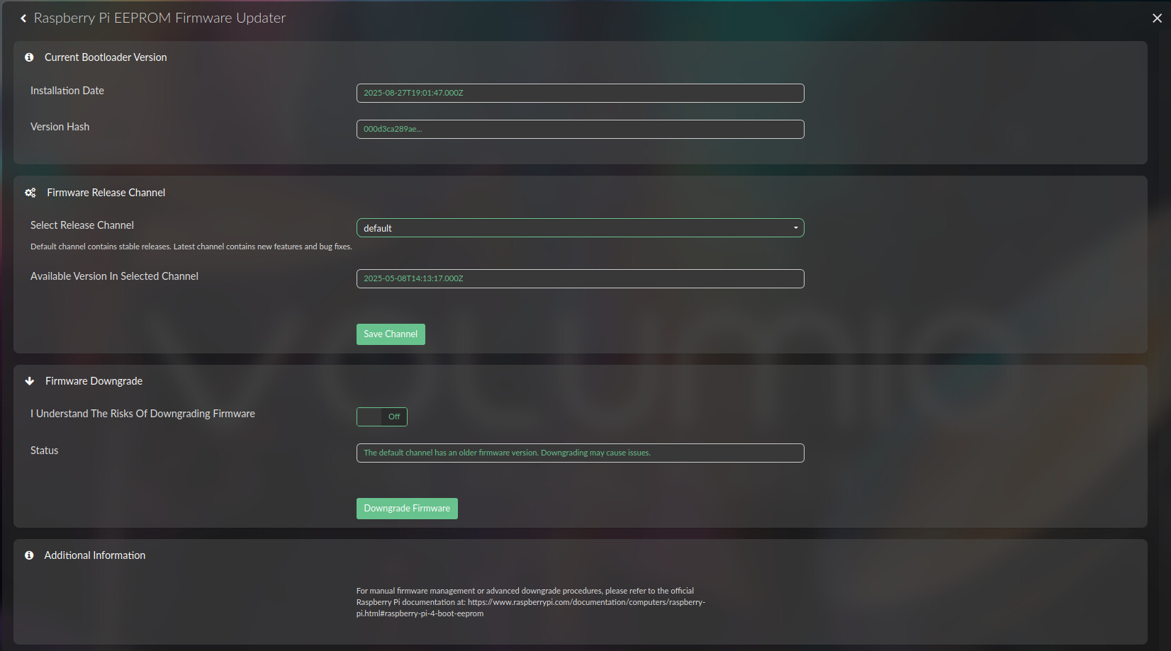

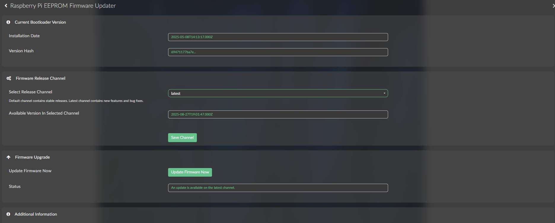

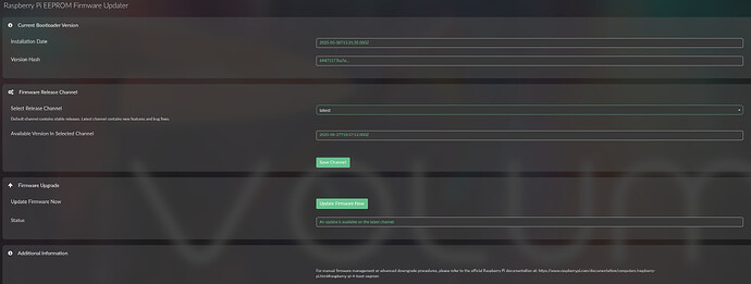

Screenshots:

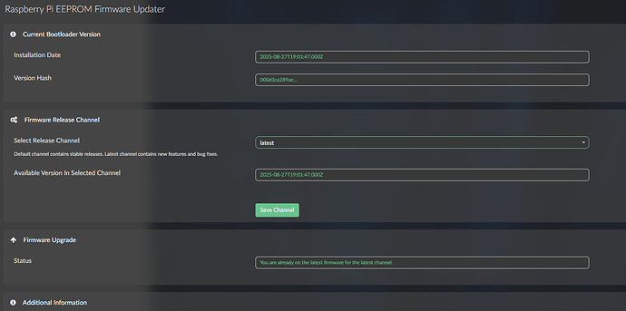

Upgrade Available:

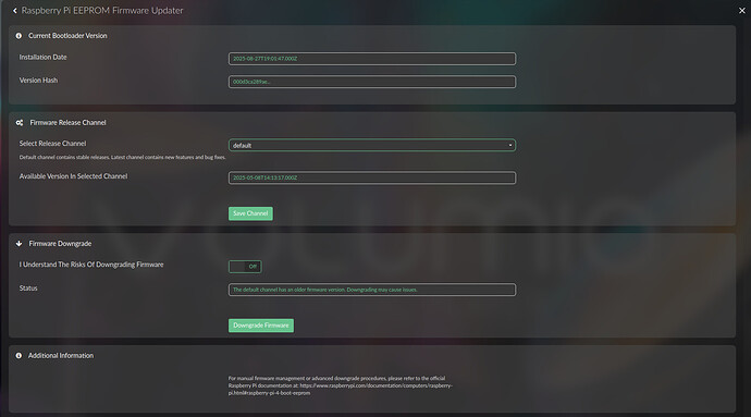

Downgrade with Safety Confirmation:

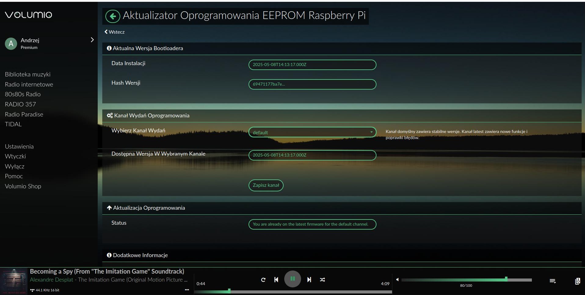

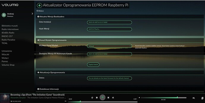

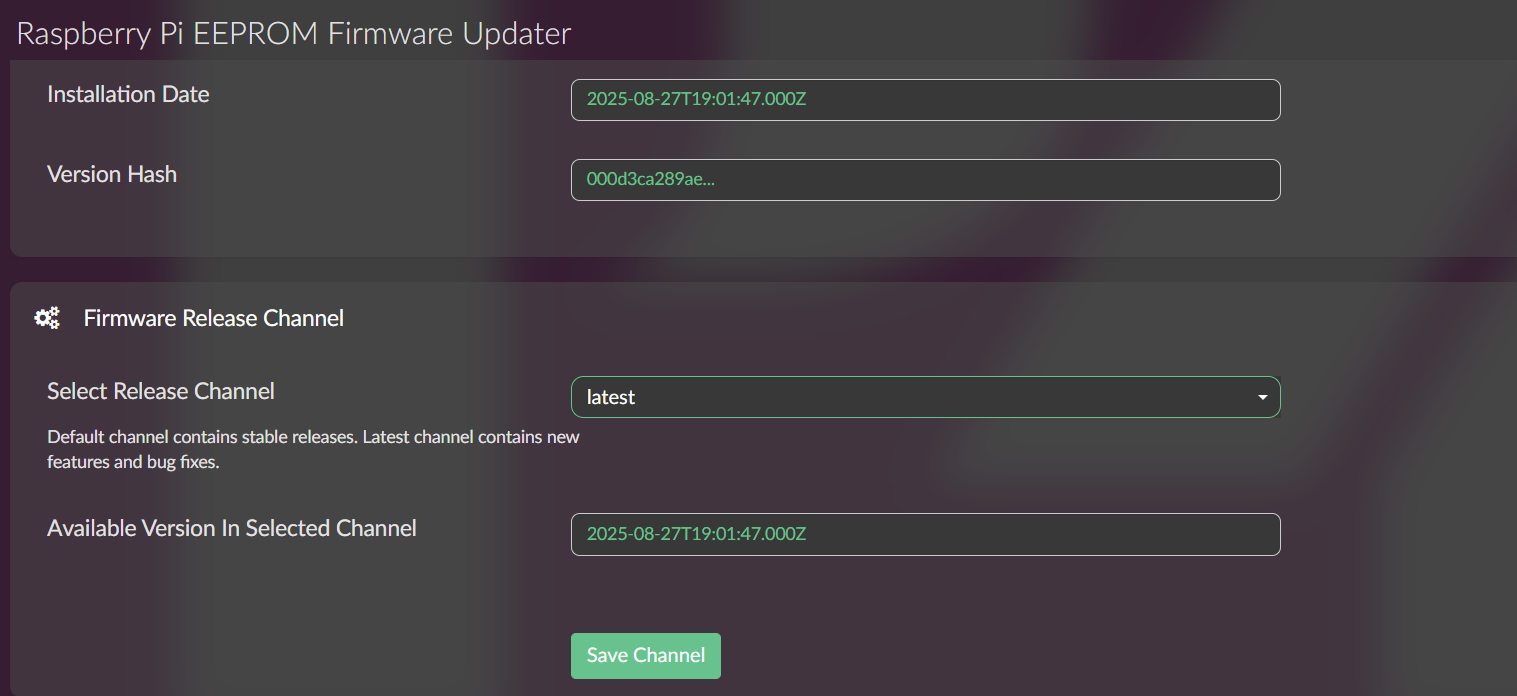

Looking good, great addition. Thanks !!!
And it did it’s job:

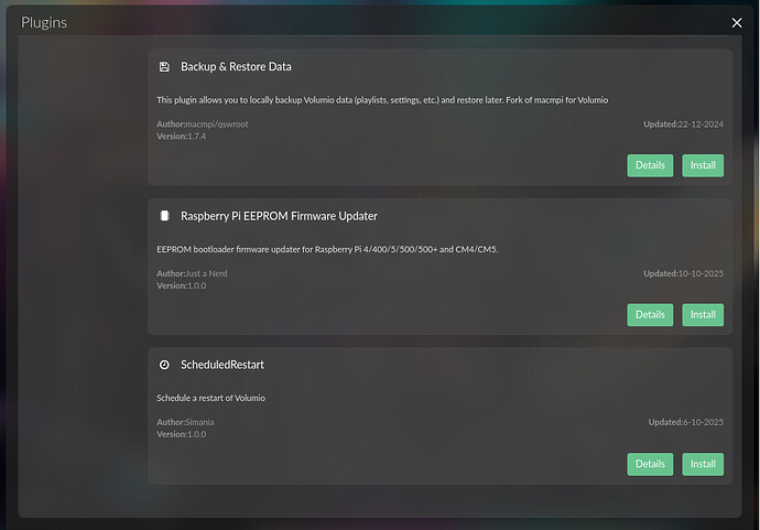

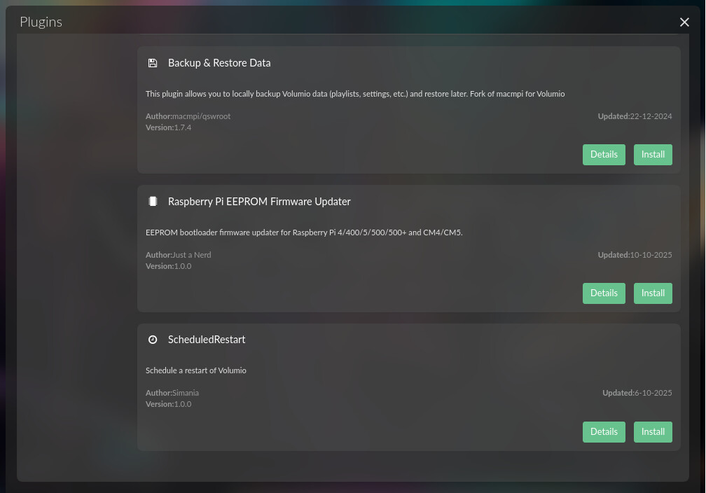

the plugin is now available in the store as beta in System_tools
Thank you @nerd !!! :wink:

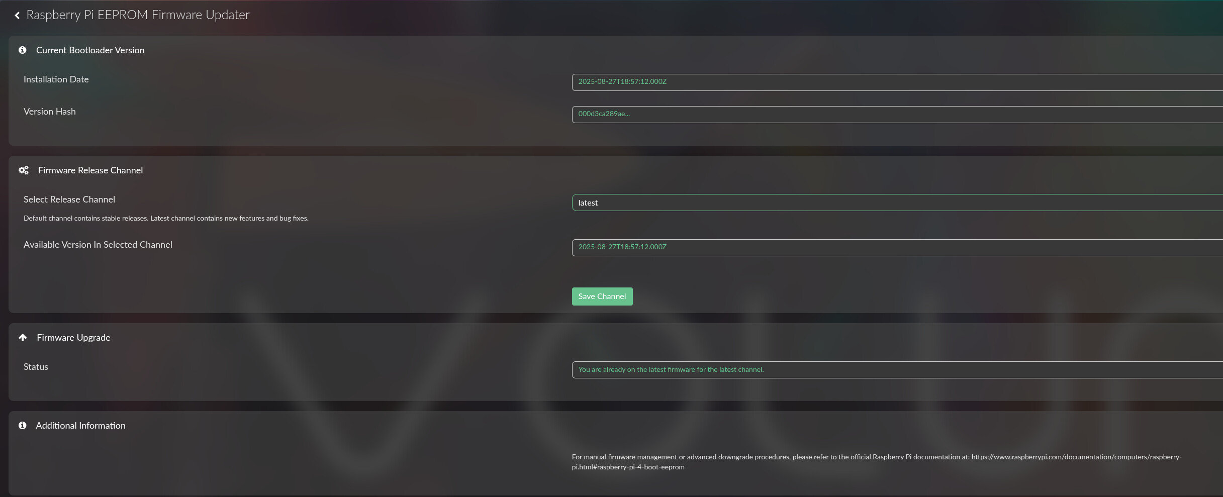

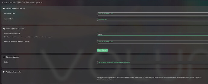

Hello!

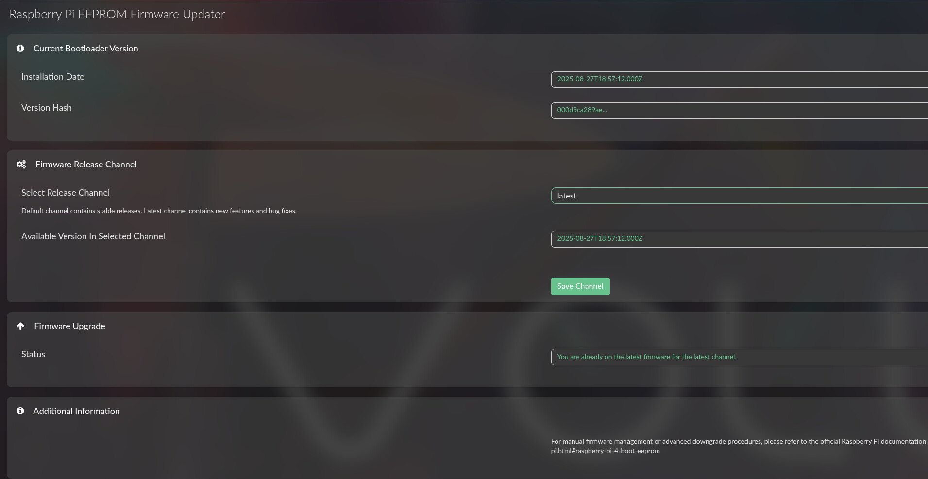

This is really a brilliant plugin. It makes maintaining my Raspberry Pi:s much easier. It’s nice not to have to mess around with SD cards. It works very good!
Thanks a lot for this one!
Both images after firmware update!
Best regards / C

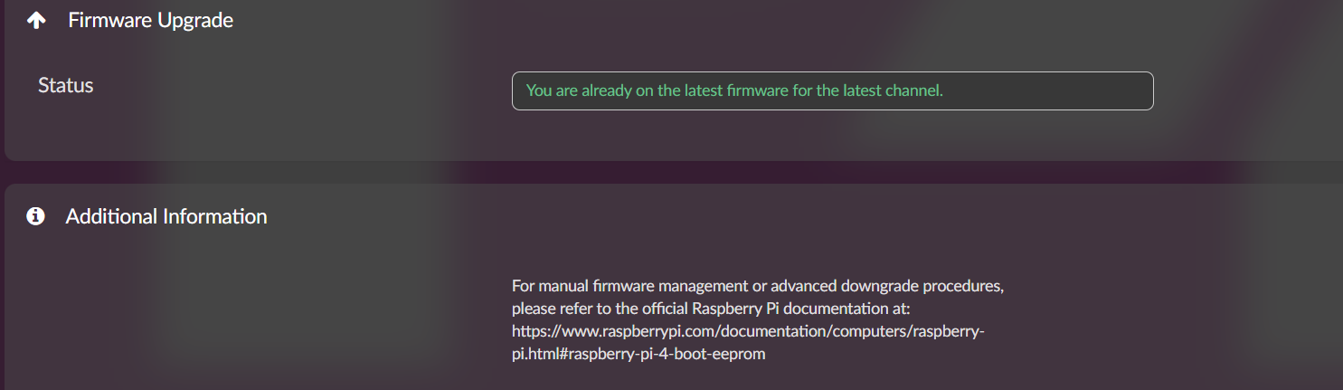

Updated both Pi4 and 5. Thanks!

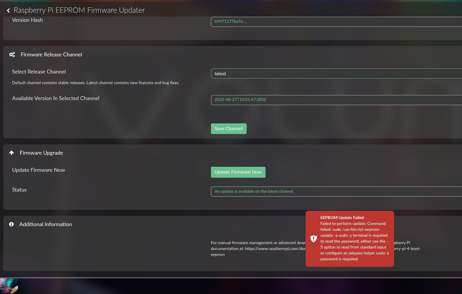

Today I had the very same problem with the plugin, fresh Volumio Bookworm install on SD (v4.062), I got the error message when trying to update the EEPROM of a RPi5
Of course I did not change the password
I’ve pushed an important update to the Raspberry Pi EEPROM Firmware Updater plugin:
What’s New:
  • Fixed the “EEPROM Update Failed” error that some users experienced
  • Added full support for Compute Module 4 (requires 3 reboots for update)
  • Improved handling for unsupported hardware (shows clear message instead of errors)
  • Simplified the UI to show only relevant version information
What’s Fixed:
  • Plugin now correctly handles the rpi-eeprom-update command’s exit codes
  • Sudo permissions are properly configured during installation
  • Package updates ensure you have the latest firmware files
For CM4 Users:
The plugin now handles CM4’s special requirements automatically. When you update, the system will reboot three times - this is normal and required for CM4.
Installation:
The update will be available in the plugin repository shortly. Existing users can update through the plugin manager.
Thanks to everyone who reported issues and helped with testing!

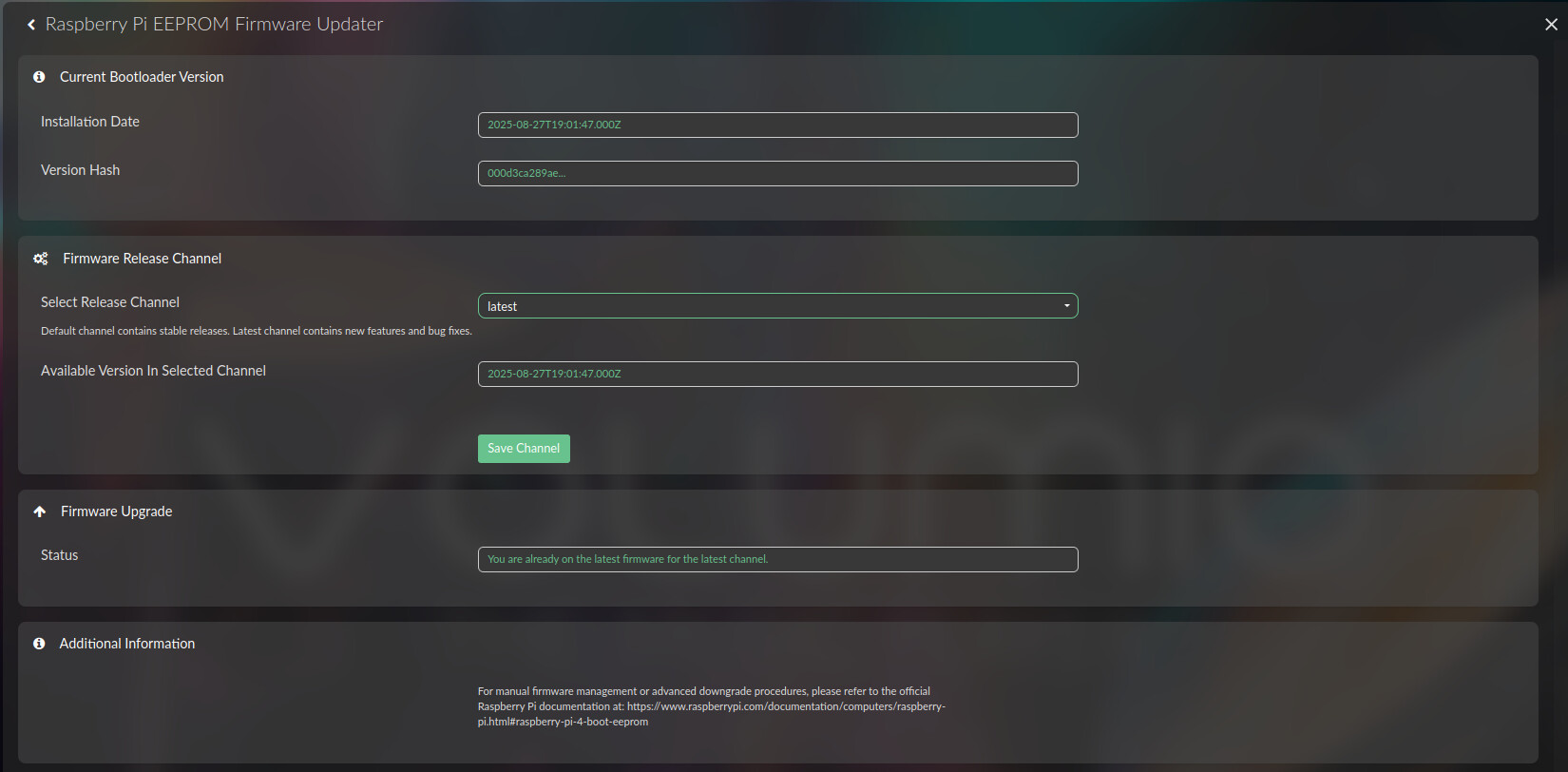

yesterday I prepared a SD-card with Volumio 4 v4.062, to test this plugin on different RPI devices.
this SD-card was used yesterday on a RPI5 and a CM4, very helpful to report some issues to @nerd
Today I plugged the SD-card on a RPi4 that it’s not used since long time (several months), I uninstalled the version 1.0.0 of this plugin and then installed the version 1.0.1 with a reboot in between.
To my surprise, the “currently installed version” was reported as up-to-date, but this is not possible since this RPi4 was not used since very long time, and the latest update is from 27th August 2025
I tried to select the “default” channel and the plugin proposed a downgrade, I executed it (no errors) and after the reboot the recognized version was still the most recent from 27th August 2025

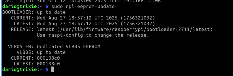

here the log after a reboot and loading the plugin, later on I will check what version in on this RPi4 with RaspiOS and post the result
http://logs.volumio.org/volumio/S8vumWN.html
That’s very weird, the bootloader has been updated to the latest version from 27th August, but I never triggered that.
The only bootloader change I triggered from the plugin was to downgrade to the “default channel” version
Is it possible that somehow the update was done behind the scenes, having used this SD-card with other devices yesterday?
After downgrading the bootloader with RaspiOS trixie to the version from 8th May 2025, the plugin recognizes a new update available from the “latest” channel
I updated the bootloader with the plugin and after the reboot I got the version from 27th Aug 2025 installed
