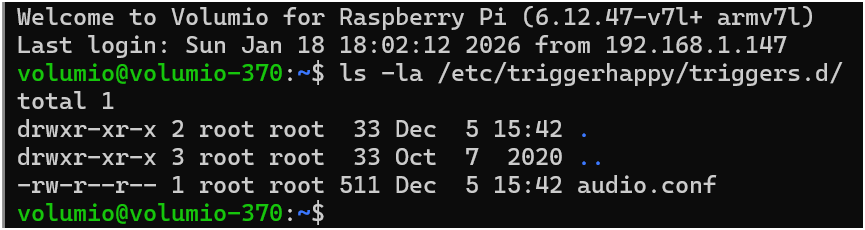

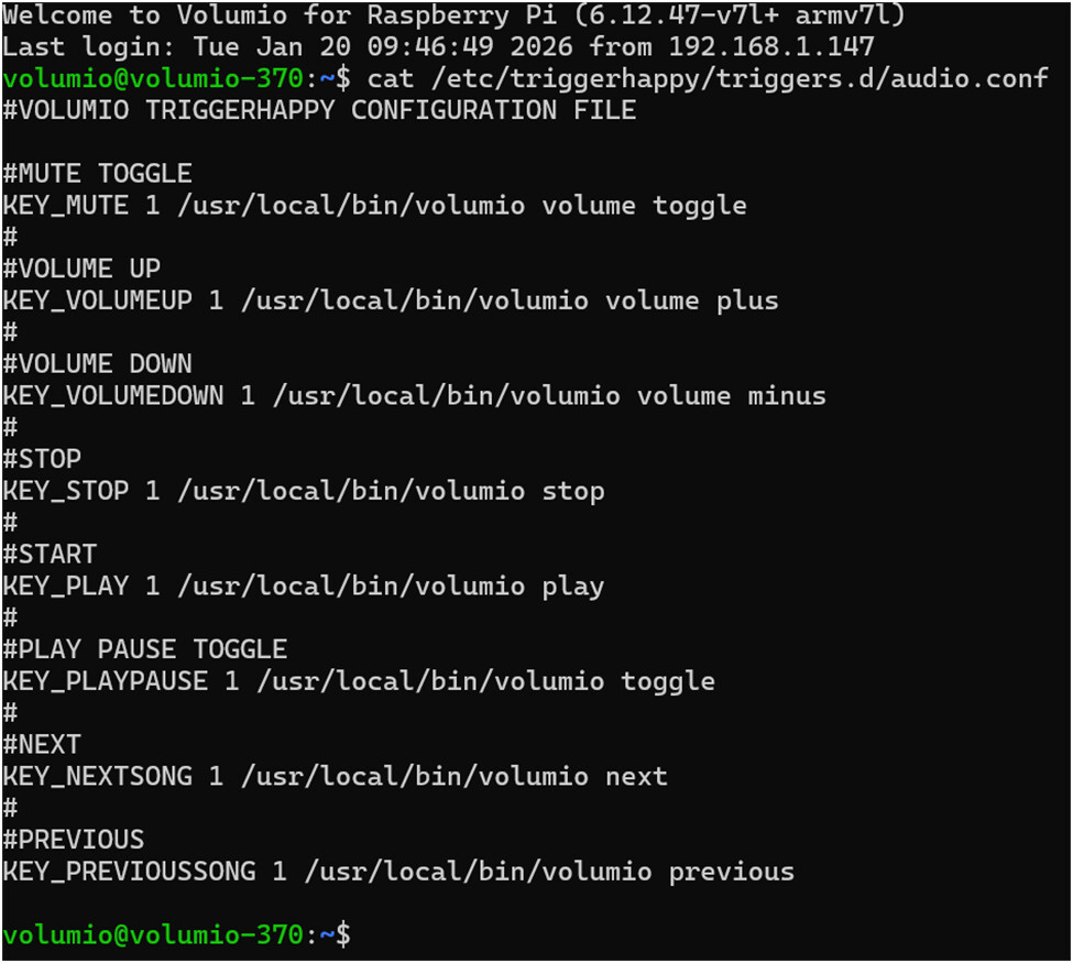

@nerd I think i did all four correctly and here is what i got, thank you for all your help.

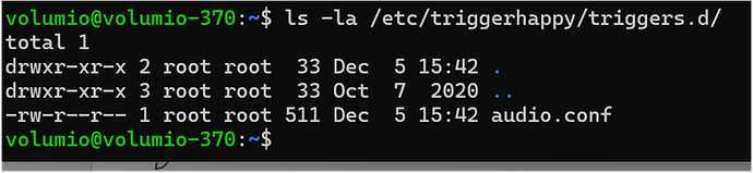

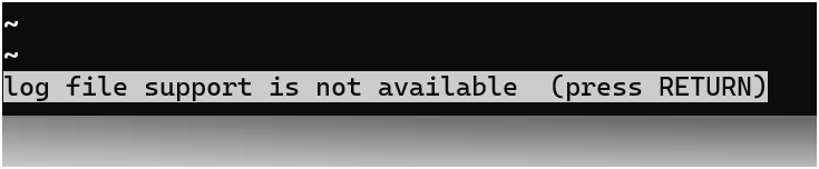

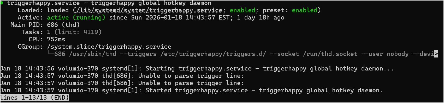

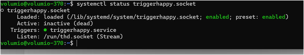

@nerd I did the last two again and got the following:

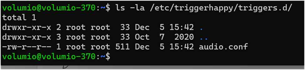

Hey @backenst,

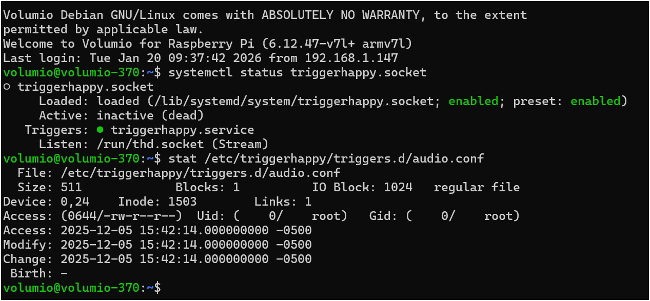

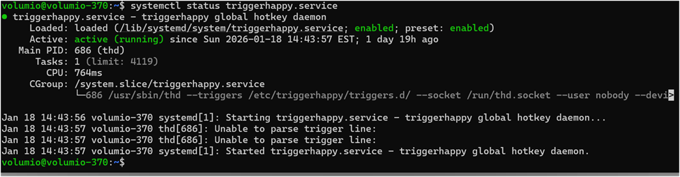

The diagnostics got mixed up. When running commands like thd --dump, you need to press Ctrl+C to exit before running the next command. When running systemctl status, press q to exit the pager.
Please run these tests again, one at a time:
cat /etc/triggerhappy/triggers.d/audio.conf
(should show text content, press Ctrl+C if it hangs)
ls -la /etc/triggerhappy/triggers.d/
systemctl status triggerhappy.service
(press q to exit)
systemctl status triggerhappy.socket
(press q to exit)
The stat output you provided shows the file is 511 bytes and was last modified 2025-12-05 - this is the Volumio build date, meaning the file has never been altered. It should contain the default key mappings.

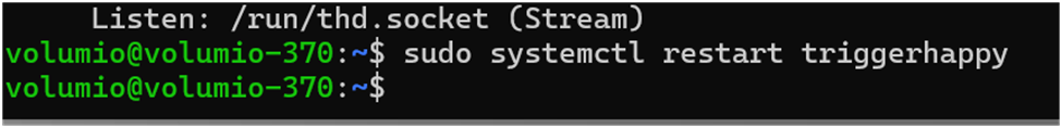

Once you confirm the file content displays correctly with cat, restart the service:
sudo systemctl restart triggerhappy
Then re-test your FLIRC remote.

Thanks @nerd here is all the output, but it still did not work after i rebotooted the pi.

Hey @backenst,
Good news - this is a confirmed regression and the fix is now submitted.
The problem: triggerhappy runs as user “nobody” which is not a member of the “input” group. Since /dev/input/event* devices have permissions 660 (root:input), triggerhappy cannot read any input events. This affects all USB HID devices - FLIRC, keyboards, remotes, DACs with HID controls.
Last known working build was 4.062 pre-release.
Workaround (immediate fix for your system):
sudo usermod -a -G input nobody
No reboot required. Your FLIRC should work immediately after running these commands.
Note: This change persists across reboots but will be lost on factory reset. Once the fix reaches the build system, a factory reset will be required before OTA update can apply it - the build script only runs during fresh image installation, not during OTA.
PR submitted: fix: add nobody user to input group for triggerhappy by foonerd · Pull Request #344 · volumio/volumio-os · GitHub
Thanks for reporting this and providing the diagnostic information - it was essential for tracking down the root cause.

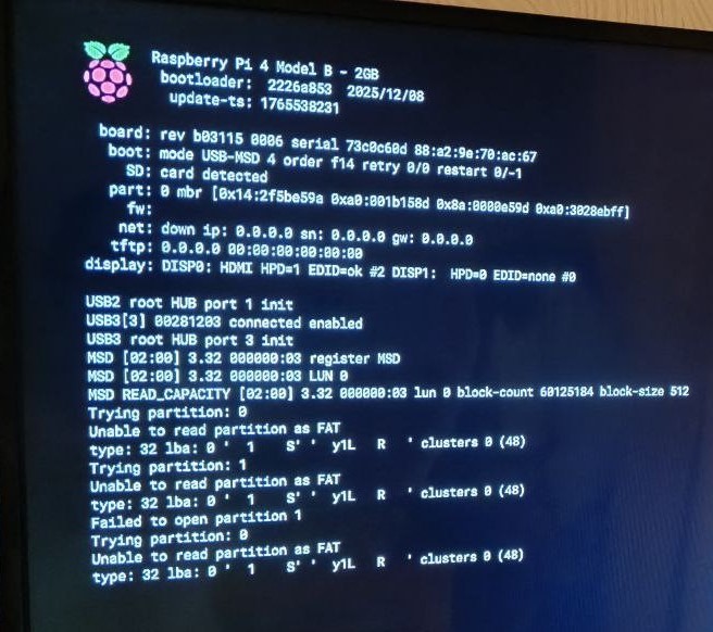

Hi.
Volumio 4.073
volumio@volumio:~$ vcgencmd bootloader_version
2025/12/08 19:23:42
version 2226a853bb9f5fd80392e3a4a89e457aeca88008 (release)
timestamp 1765221822
update-time 1765538231
capabilities 0x0000007f
volumio@volumio:~$ vcgencmd bootloader_config
[all]
BOOT_UART=0
WAKE_ON_GPIO=1
ENABLE_SELF_UPDATE=1
BOOT_ORDER=0xf14
NET_INSTALL_AT_POWER_ON=1
volumio@volumio:~$ cat /proc/cpuinfo | grep Revision
Revision : b03115
volumio@volumio:~$
USB SanDisk Ultra Fit 32 Gb
