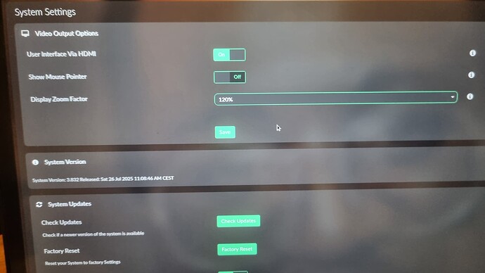

Volumio on x64 touchscreen tablet, mouse pointer is disablet but is still there!
Please read the opening post of this thread.
There are thousands of different PC configurations, so without more info about your setup, nobody will be able to help.
Also, how did you try to disable the cursor?

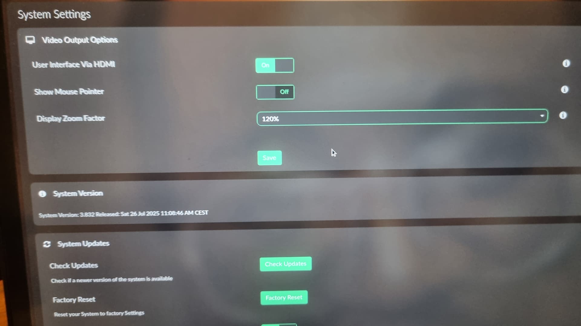

So i disablet in volumio under HDMI "Show Mouse Pointer " Set it off,rebot but is still there!
Is a windows tablet,Fujitsu Q7310 FUJITSU Tablet STYLISTIC Q7310 - Fujitsu Hong Kong
Yes i was reading lots of stuff here but no Chance!
Last Volumio x64 image.
Thanks for your answer!

Edit: afaik we used “unclutter” for this when setting up the kiosk function. It hides the cursor (well, it should) when there is no mouse activity.

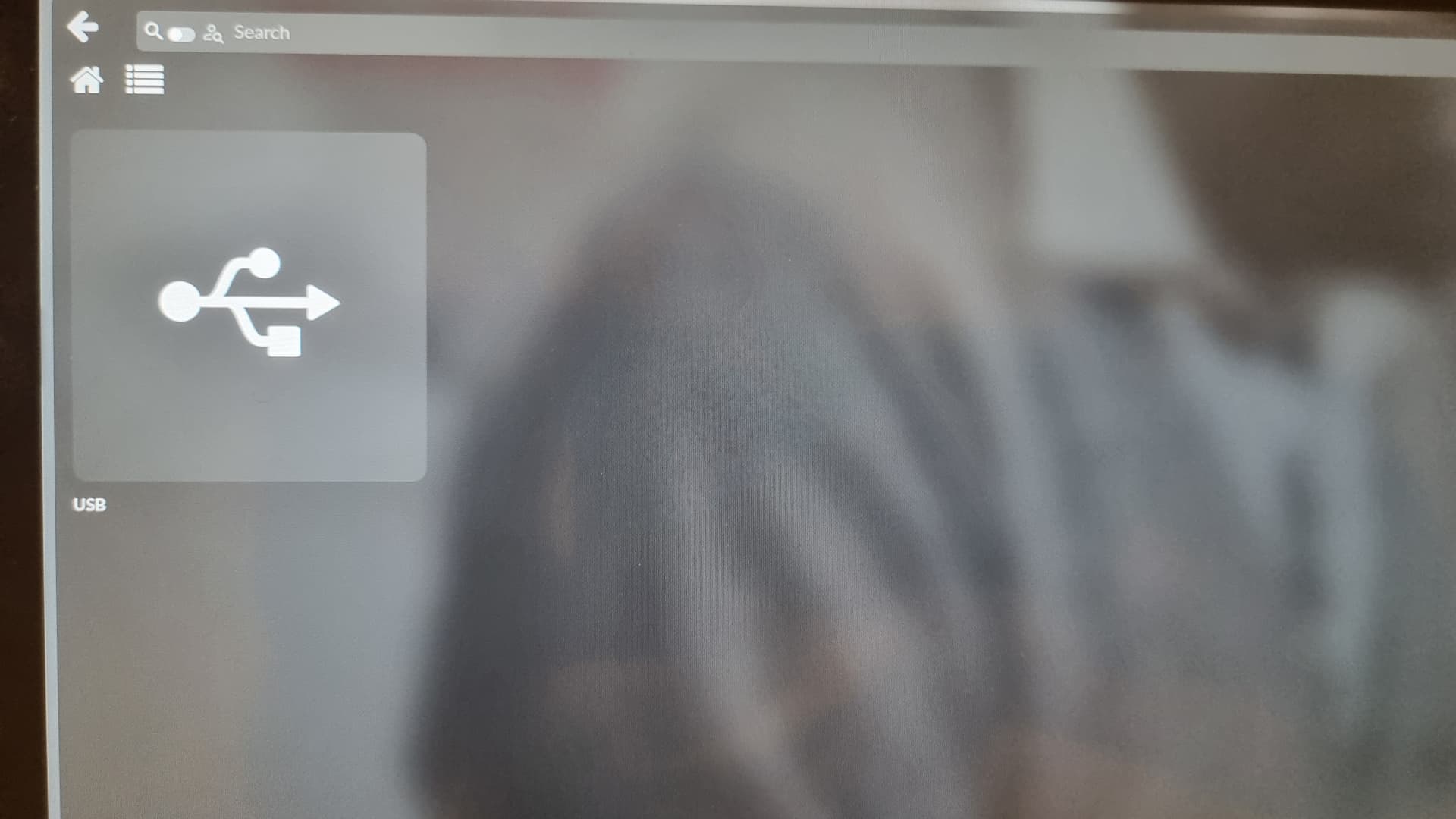

Ok no pb,thanks anyway.And this tablet got a sdcard reader,inside is a 512gb card with music(ntfs).The problem is i can see this in setings,but not in my music library!this is odd too!
After re-checking the code, it seems “unclutter” is still being installed, but I did not find any reference anymore of it being used in the kiosk startup. It may have been removed, this needs to be checked.

This is not “odd”, but by design.
Any storage is being skipped by Volumio, unless is is labeled “issd” or “ihdd” (and a few similar ones). This has been done on purpose to avoid Volumio scanning all internal devices for music.
So I suggest you just re-label your SD card as “ihdd”, then it should work.

Tested with Dell Latitude 3189:
  • Volumio x86-V3.818 => unclutter is installed and working (1)
  • Volumio x86-V3.832 => unclutter is installed and working (1)
Tested with Toshiba Click Mini:
(1): The mouse is visible when you touch the screen, but will hide after 1-2 seconds
That was intended behavior, still looking for unclutter being called, just for my own peace😉
ihdd is not working, still not showing!Is “ihdd” or just ihdd?issd not working too!
Is the same problem (Tinkerboard S) Can't play music from micro SD card
So i can forget about reading music from sdcard.
Thanks for helping me.
