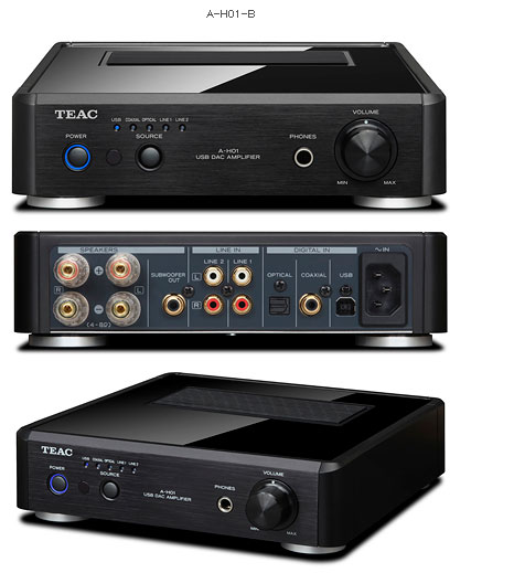

Receiver:
DAC: Burr-Brown PCM5102
Async: Yes…?
Working with Volumio: Yes
Tested Versions and Platforms: Rasberry Pi B+ and Volumio 1.41
Harware Mixer on Volumio:
HW Mixer string:
Comments:
Buying Link:
