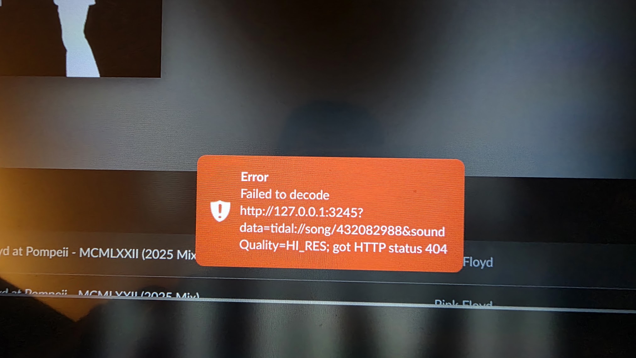

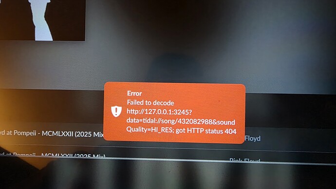

Just started to have some error with TIDAL when try to play music. The error message is the following
"Failed to decode http://1271.0.0.1:3245?data=tidal://song/ (…) Quality=HI_RES; got HTTP status 404”
Tried to change the Quality setting, but the error continues. This started when changed the Quality to best available.
Can anyone help?
Thanks!
a new version with the fix for Tidal and Tidal Connect has been released, please update your devices
Many thanks. I’ll give feedback after the update.

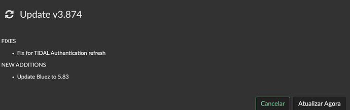

Just made the update to version v3.874 and everyhting is working fine again!
