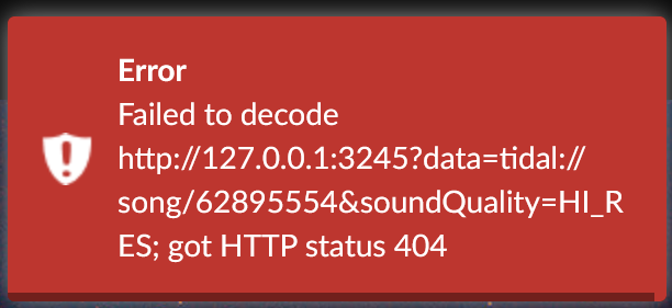

Hello everyone! I am a new Rivo+ owner, just purchased. I also have the strange issue when using Tidal with Volumio app. The problem is that after exactly 1 hour appear the error “Failed to decode ……got HTTP status 404” and TIDAL doesn’t work furthermore. The only solution to resolve this is to restart the Rivo+, then TIDAL works another 1 hour and so on. It’s very frustrating to restart the device after every hour to play TIDAL. I mention that the connection with router is wired and there is no problem with Ethernet. I didn’t try TIDAL Connect to see if the same problem persists, as I don’t like sound quality on this connection. I had other devices (Blue Node, Eversolo) which have no problems with connection to TIDAL by their own app. Is this a serious issue of Volumio app which can not be fixed? Is there any chance that the problem will be solved?

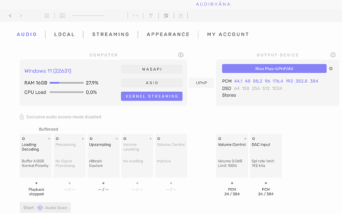

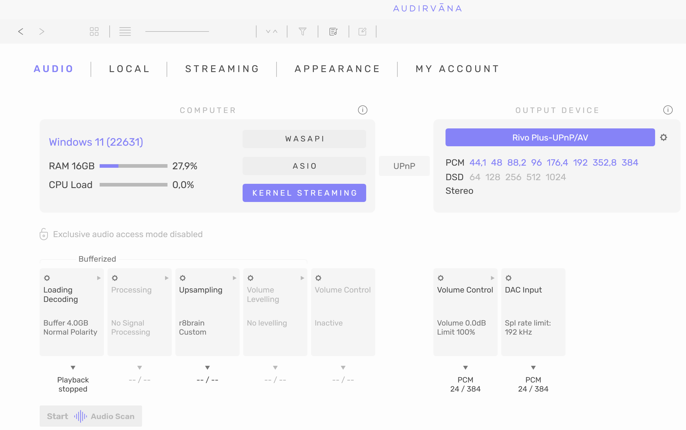

Normally, via UPNP Rendering, I use the RIVO Plus (over a wired LAN not a Wireless one) as the AUDIRVANA Studio End-Point, which allows me to apply both room correction filters and advanced upsampling.
But in this situation, when streaming with TIDAL is managed by AUDIRVANA and not by VOLUMIO, I have no problems whatsoever and music streaming works well without any interruptions, thus ruling out any network or connectivity issues.
However, when I listen to TIDAL streaming via VOLUMIO integrated into the RIVO streamer, after normally playing a few songs, everything crashes irreparably with an error message, forcing me to restart the streamer.
Screenshot 2025-11-11 100319
This morning, with the update to the newly released system version 3.872, I was hoping for a resolution to the problem but unfortunately nothing changed.
Adding the observation that streaming also works wonderfully well with the proprietary TIDAL Connect App, it therefore seems quite clear and evident that the problem is attributable to the way in which VOLUMIO manages streaming access permissions with TIDAL, which may have changed some rules.
