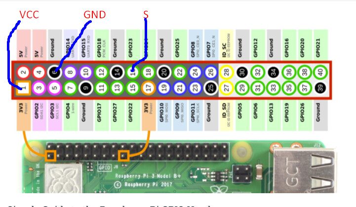

On the plugins, i went over and selected the JustBoom profile and on the GPIO configuration, i selected GPIO24.
From the IR sensor module
I connected the volt pin to the 3.3v on the Pi 4
I connected the S pin to the GPIO24 that i have selected on the volumio gpio configuration.
I connected the - pin to the ground pin on the Pi
I rebooted the player and tried the JustBoom remote and there was nothing happening. So do i need to access the SSH on the laptop to enable the gpio24.
no you only need to connect 3.3 volts, ground and data to gpio 24, of course this may not be used by another function.

First, after reimaging the volumio on sd card and placed back into my SmartiPi Touch 2. I booted it up and can to this here.
The gpio is set to gpio25 by default, do i need to change or enable any of the other setting

I left the selected GPIO on default, do the select "Pull-Up/Down setting or the configuration " Active State Of The Input all have to be enable for the JustBoom IR Remote to work
if you connect the S to GPIO24, why would you put the plugin to GPIO25?

So it’s on the default gpio25 and connected the s wire from the IR sensor modular to the gpio25 on the Pi 4.
Do i need the select the Pull-Up / or down setting, which i have it set to down.
Do the Active state need to be turn on/off

I left everything to default and it works
(besides I connected it to GPIO23, GPIO25 didn’t work for me.)

So if you connect it to the rPi, you can change the last 2 options and test.
And please check which GPIO are being used by your soundcard.

But just connect the S to GPIO23.
Add this line to the /boot/userconfig.txt
dtoverlay=gpio-ir,gpio_pin=23
Select your remote in the plugin. (Note the settings will be gone
If it still doesn’t work, the receiver is broken.
