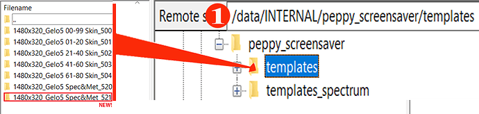

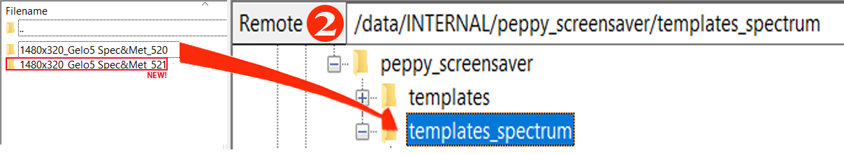

Updated skins 1480x320 Enjoy!
All skins + 16 New!
1480x320

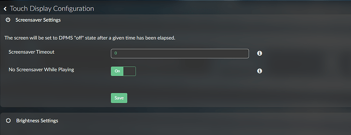

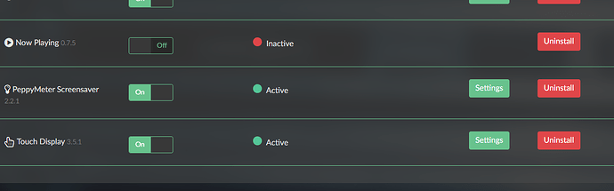

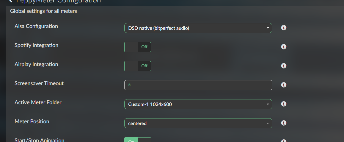

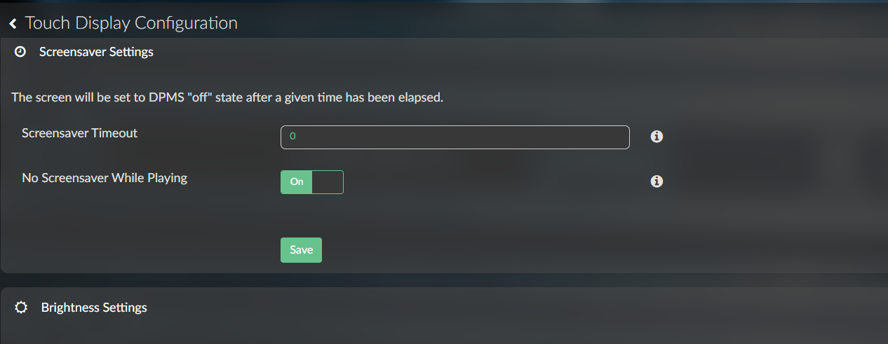

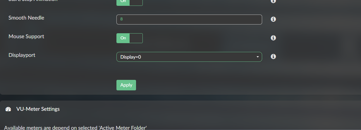

Hi @Gelo5! Can you help me with this? I’m having a hardtime to work with my peppymeter. I am using
Rpi3b+
7inch touch display
Volumio 3.779
Dachat
Touch display plugin is working well and i did the instructions above.
Pepperscreensaver 2.2.1 and these are my settings.
Thanks,
it’s not adviced to run Peppy_meter on a rpi3, due to lack of power.

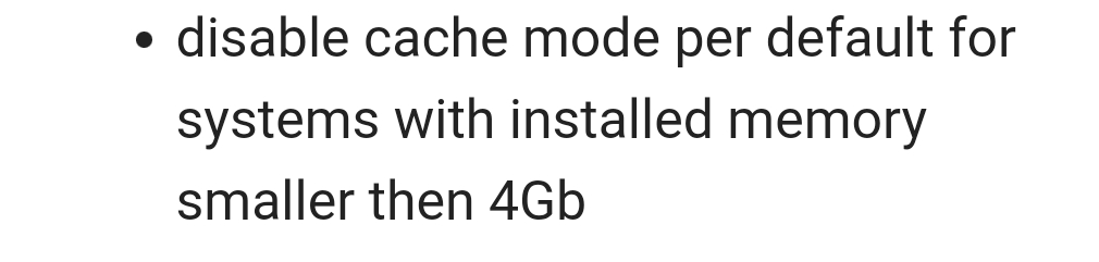

2GB is ok with small libraries <20000 tracks, 4GB will be a smoother experience in combination with Peppy.
I know that @nerd posted a table somewhere, but unable to locate it.
