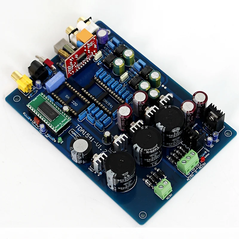

Yesterday I installed Peppymeter 2.1.0 on 4 different streamers, all with a 7.9 inch HDMI Waveshare screen and all with a Philips 1541A USB DAC.
Peppy works fine on all, except infrared does not work well with Peppy, the interface stops and does not continue.
unfortunately I didn’t make a log.

they are all raspberry pi 4 with the latest volumio v3.661 with a philips 1541A USB DAC.
with the plugins, now playing, rotary encoder II, infrared, gpio buttons (only for power on/off on gpio 3) youtube2, youtube cast receiver and spotify.
As soon as Spotify starts playing, the next song works well via the app or touchscreen.
if I use infrared for next, it goes to the next one, the next infrared push nothing happens and the interface stops, even via the app or touchscreen the interface no longer responds, sound still comes out but no longer goes to the next number.
The strange thing is that the spectrum works but the VU meters do not, see screenshot of the skin I used.
When I turn off Peppy, infrared works well and causes no problems.
in this case I turned off infrared because he prefers to have a peppy meter on his raspberry pi.
I can ask the owner if he would like to make a log with infrared enabled.
