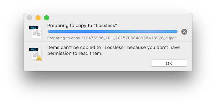

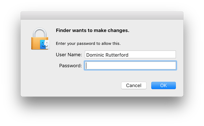

Hi Thanks - I was able to mount the USB disk on to hard drive this way. However I can not drag and drop anything on to the hard drive. It asks for a username and password to do this and when I put that in I get:
“Items can’t be copied to “Lossless” because you don’t have permission to read them.”
I can drag files off the drive to my desktop - just not the other way!

Hi I can mount the USB drive now - thanks but I am also getting insufficient privileges when I try and drop a file on to it (it’s ok dragging a file off to the desktop though). It also asks for my Mac username and password just prior to attempting to copy the file across.
I have tried formatting the disk to different formats - Mac OS Extended Journalled, ExFat and Fat 64 and no joy. I have also tried changing the permissions of the disk on my mac and through SSH when connected in Volumio.
Any ideas? I’ve been trying to do this for weeks.
