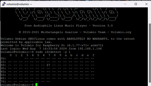

What kind of display are you using and how is it connected?
If it’s I2C, you can check the address by typing sudo i2cdetect -y 1
you should get something like this:
the number reported here needs to be the address on the config page. Width is the number of characters on the display multiplied by 5 and height is number of lines multiplied by 8 (e.g. a 20x2 display is 100 wide by 16 high)
Once you have that correct and saved, make sure that the Pages File corresponds to your display (or the closest less than your display), for the example above as there is no 20x2 example file, you would enter pages_lcd_16x2.py and hit save.

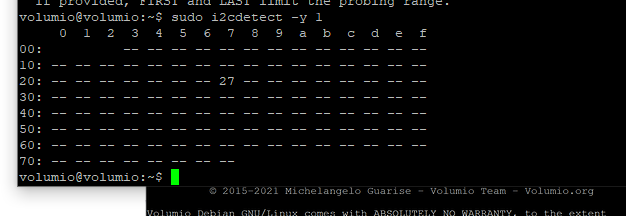

And i finally install the plugin from saiyato. Unfortunately, I’m having a hard time to work with the lcd1602 to get show display.
I use to detect for i2c. And it seems no problem with my wiring.
