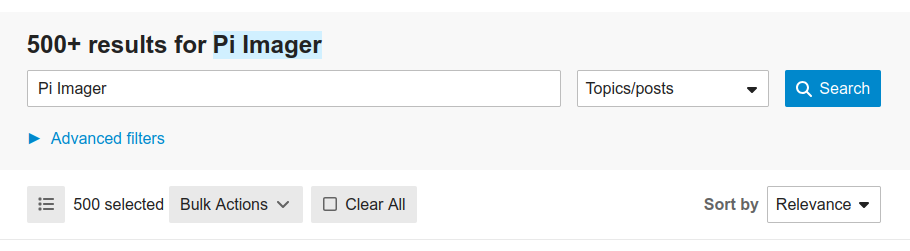

I must admin, I did not check every and single post from over 500+ returned from search. However every and single one I checked reported a problem as well as warning to be very cautious.
This leads me to a logical conclusion - a single exception does not invalidate a pattern. Still it is an exception worth noting.
Furthermore, every community user reporting an issue is required to provide the details as outlined here, no exceptions.
Maybe its enough to not use customization during preparing image. Nevermind.

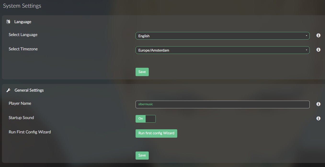

Hi @nerd

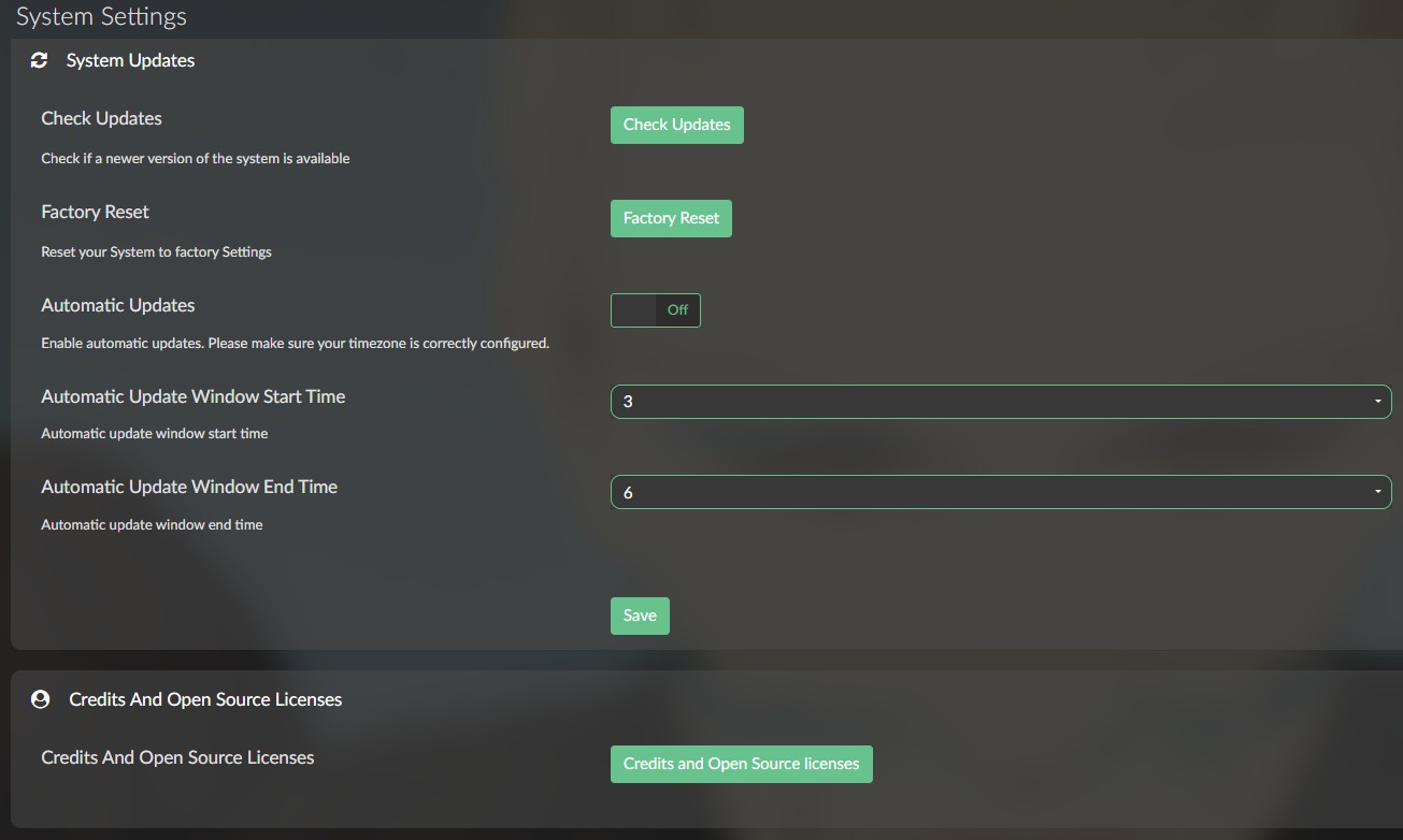

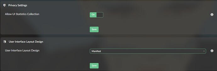

I’m not sure what I’m doing wrong. I wanted to try a fresh install using this method, but I don’t see the Install to disk option in Settings > System.
I’m on v4.071 on a Pi5. Here are screenshots of my System options.
Hey @SimonE,
Perhaps you did not boot from MicroSD (boot priorities). As such, install to disk whilst running from disk…
As a precaution - can you double check your Raspberry Pi revision code and share for inspection?
Hi @nerd ,
That’s it. I was not booting from SD. I see the option now.
My board is a c04170 (Pi 5B 4GB rev 1.0).
Many thanks!

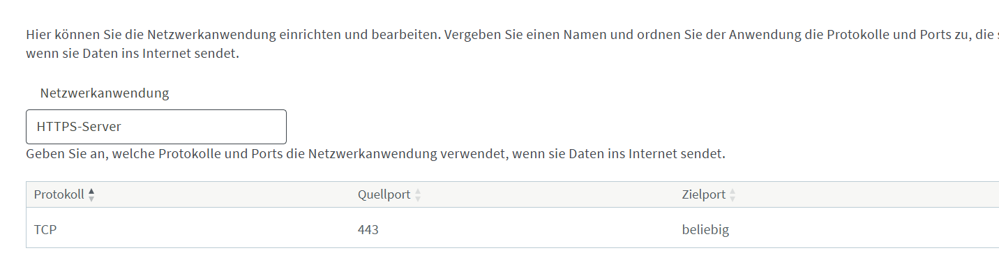

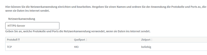

I just added port 443 in the FritzBox and restarted the Pi’s
Now i got a time delta of 0 !!!

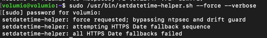

I think your date/time is not synced yet. You can wait a couple of minutes or set it manually via a ssh command.
sudo /usr/bin/setdatetime-helper.sh --force --verbose
Please look here:
this piece:
Check network connectivity to time sources:
Looks like something is blocking your connection.
If it still fails, please provide info as requested here:
