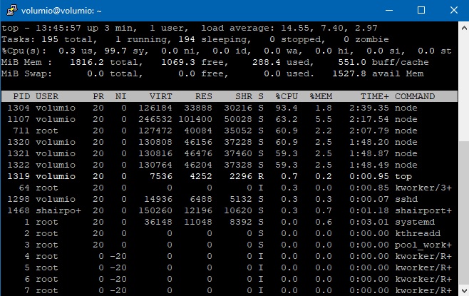

I am a new user, currently learning Volumio, and so far I really like it.
However, I have encountered a problem that seems to be the same as the one discussed in this thread: /74379/407
(Sorry, as a new user I allowed only two links in this post…)
After booting, I experience near full CPU load for about 5 minutes. This slows down the loading of plugins and the entire system.
Details:
-Raspberry Pi4B, USB boot, wired network, Volumino 4.084
-It does this even after a clean install
-I did not add media sources, no database indexing
-I tried USB3 NVME drive and USB3 card reader as boot device
-I tried booting from a USB2 port
-I tried with and without HDMI monitor
Always the same result:
About 1:40 after power-up, Live Log indicates Boot completed, but the top command shows near full CPU load until about 5:20. After that, everything returns to normal, about 1% load idle.
Here is the log created during the full CPU load phase:
http://logs.volumio.org/volumio/B2IFOzp.html
This log was created after the system had settled into its usual state:
http://logs.volumio.org/volumio/hRHmobI.html
Here is a screenshot of the top command.
volumio-top
Thank you!
Hi @Vaclav
I don’t think high CPU load for the first 5 minutes is anything too unusual, as long as it calms down after, which yours does.
There has been some work on lowering CPU use recently, but that might only be available if you update channel selection to ā€˜Test’ in ipaddress/dev

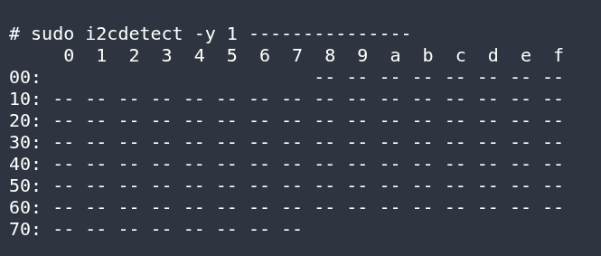

Hello everyone,
Immediately after upgrading to version 4.094
An error message appeared:
ā€œCould not stream to the selected output deviceā€¦ā€ Output device is Hifi Berry Digi+Pro, worked fine before the upgrade.
http://logs.volumio.org/volumio/5PRG3jP.html
Am I doing right by posting in this thread or should I post it somewhere else?
Regards Dmitry
@Dmitry_Tektonidi from your log
the RPI cannot find the WM8804 of your HAT on the I2C bus
please try to remove power, wait 30 seconds and apply power again
if it still doesn’t work, it’s most probably a HW issue

Tonight, I simply booted up Volumio on the Raspberry Pi, waited 5 minutes, and launched Aurdirvana. No problem. Hooray for this forum!

Hello @SimonE
Thanks for replay! I’ve tried the fresh test release, same result.
With Touch and Now Playing plugins it is very unconfortable.
I have to wait minutes for diplay and controls. And If I add my
library it’ll be more sluggish…
I hope it will be fixed.
Regards
