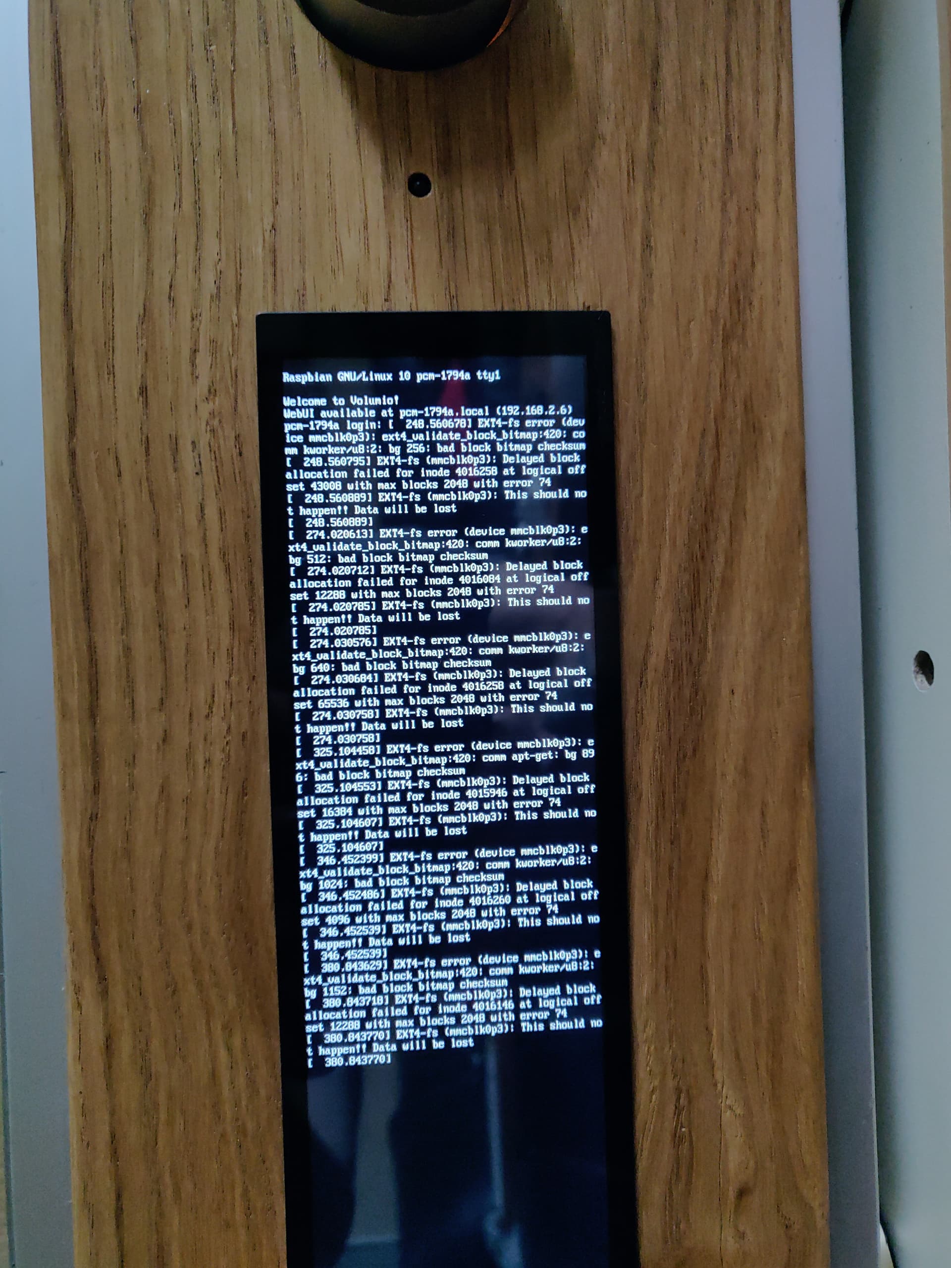

@nerd Bought a new 32 GB SD card, flashed v3.694, installed no modifications or plugins at all.
zip file for the time unpacked and used raspberry pi imager and formatted sd card also with imager.
edit: No need anymore…a new SD card broke after flashing 3 times :thinking:

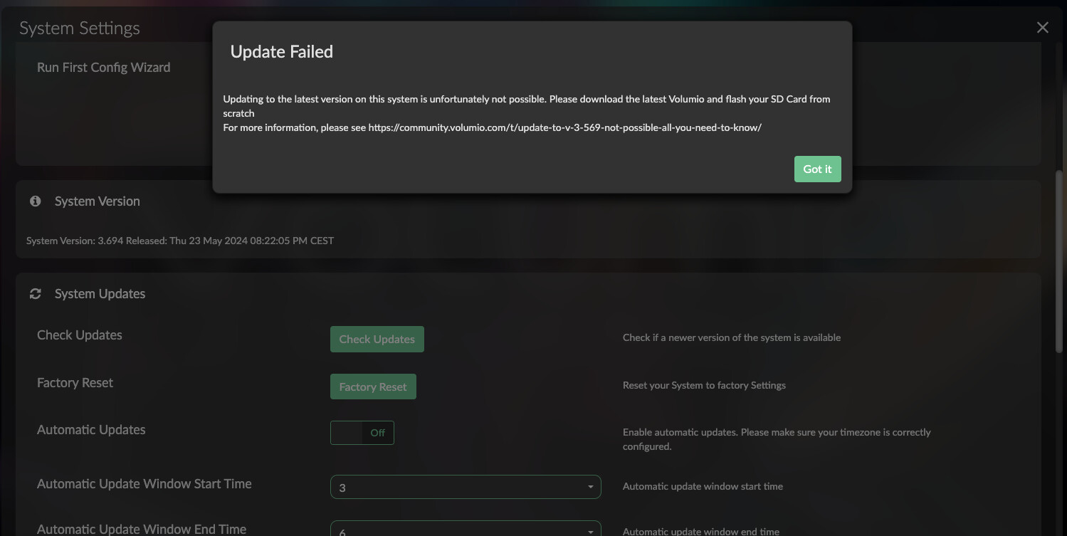

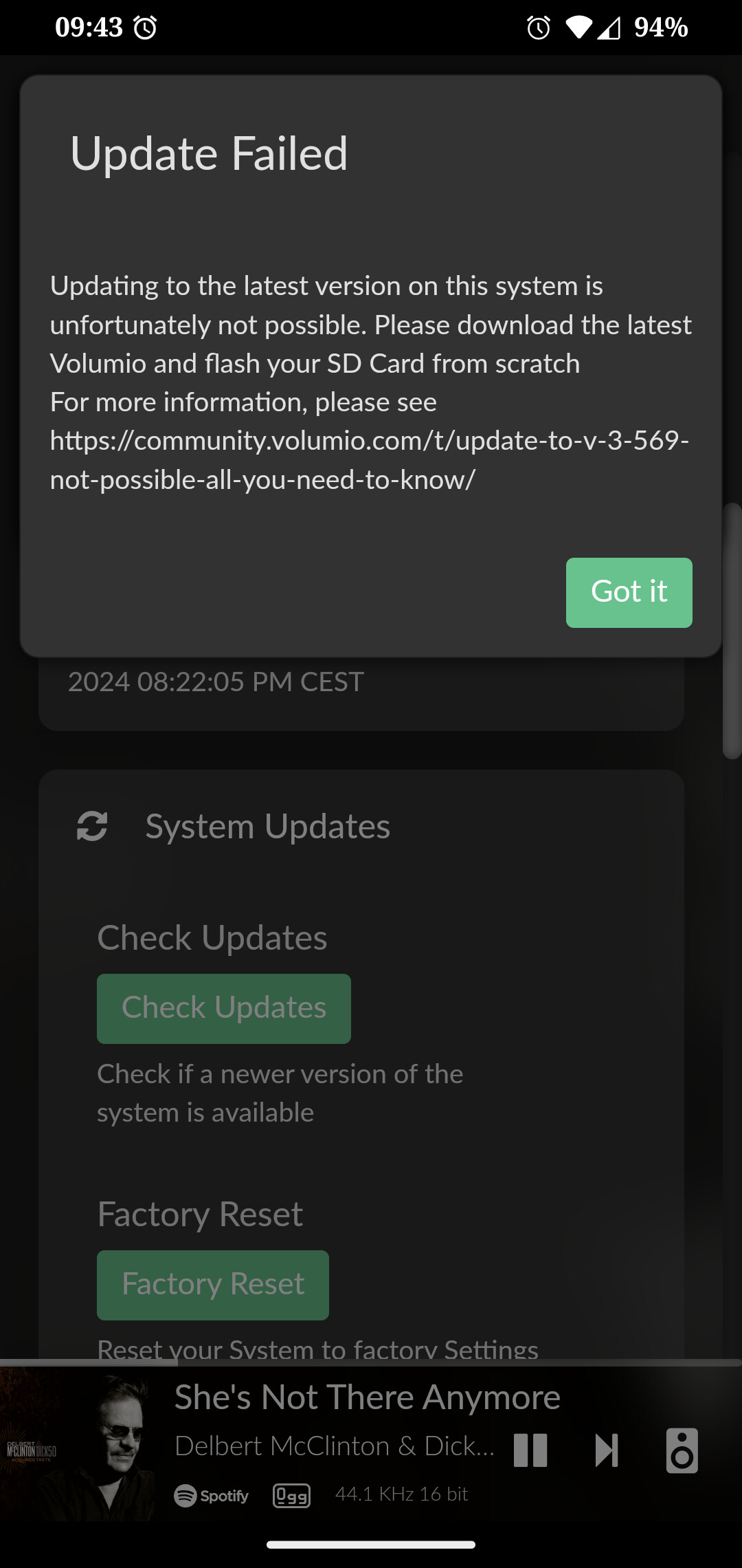

When I try to install plugins I also get this weird problem with interface connection.
If l make modification and see this on the screen as soon as l try to install FusionDSP, fot example.
update not possible, after clean install.
log
http://logs.volumio.org/volumio/yyBBcUp.html
This is very unfortunate development. What is the exact brand and type? Logged NCard 29.1 GiB suggests Lexar which as manufacturer is quite solid.
The source stream database seems to have issues for quite some time. We are looking for an alternative source, however this will take some time.
philips UHS-I microSDHC Card, FM32MP46B, class 10.
ultra speed 32gb.
