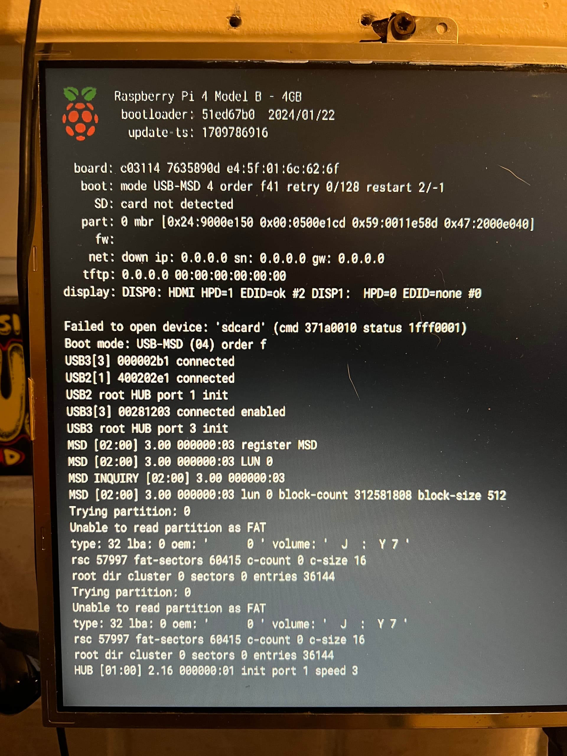

Okay, here’s what happened…
OTA updated from 3.691 to 3.694…
  • TBS - No problem.
  • RPi4 with SSD USB 3.0 - After updated, it wouldn’t restart automatically. Need to shut down and turn it back on then working with no problem. (see picture)
  • RPi5 with 1TB NVMe - No problem.
Andy

Well, we know what is happening, we still do not know why. If the same will happen with your setup in the future a full debugging from ground-up will be needed.
raspberry pi 4: 8GB USB stick updated from v3.691 to 3.694.
did not want to reboot automatically, turned it off and then performed an update but would not start again, turned it off again and then booted up properly and all oke.
