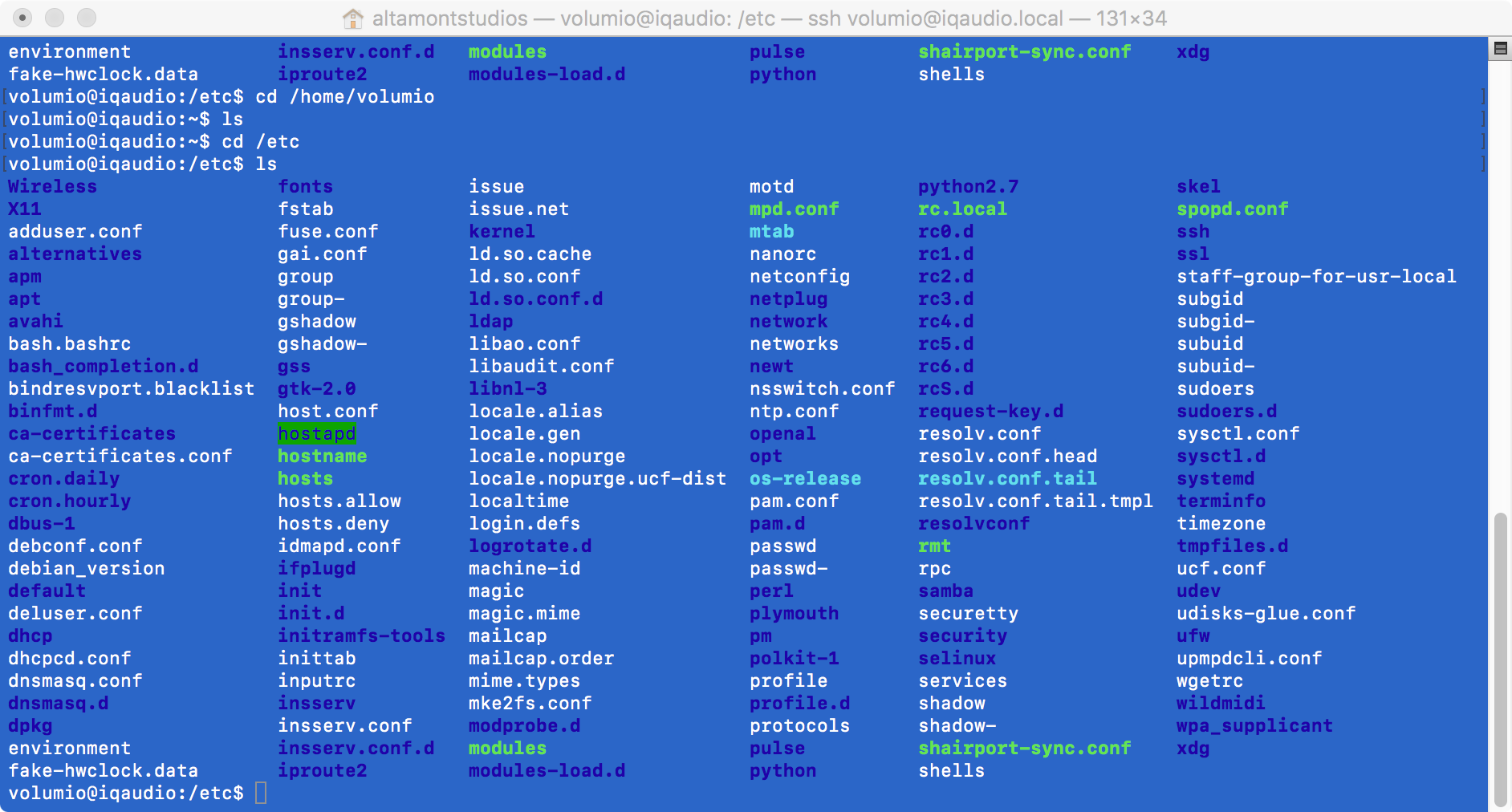

the plugin is supposed to create a /etc/asound.conf file in order to use a dmix device… Are you sure you use the last version ? I checked with a pine64 and usb dac and a rpi2 with iqaudio…
Pretty sure I’m using the latest plugin. See attached images.
I never had a doubt :wink: . I’m investigating now on my allo boss player… I keep you informed… :slight_smile:
