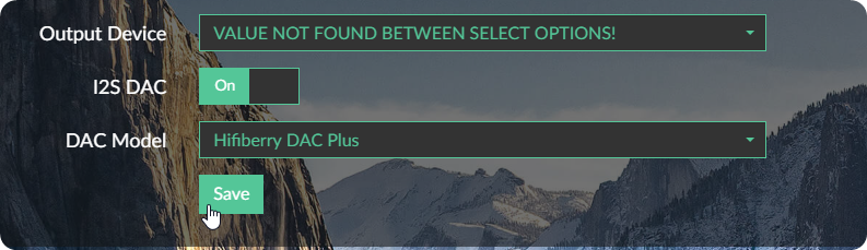

Installation was without any problems pretty fast actually, but I got a strange error choosing my output device so I made a fresh install to reproduce it:
I’m not able to play any music(spotify, local stored mp3s) because I get the error “failed to open audio output” after a reboot I there was my hifiberry set as output device but if I open the dropdown menu only audio jack and HDMI are shown.
tried now for some time to bring it to work, but no success. I have an Raspberry 2 with a Hifiberry DAC+. I tried this on an 0.99x release and now on the 1.0 release from Oct. 3.

Now Hifiberry Dac+ is set as ouput device, but in the dropdown menu are still only audio jack and hdmi as an option. If I play music I get no sound and under alsamixer my hifiberry is not available either
