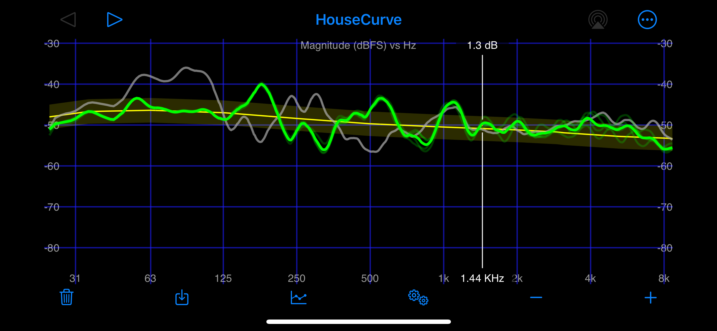

Thanks. So I did bump the curve slightly.
Here’s the After:
Not perfect, but a lot better.

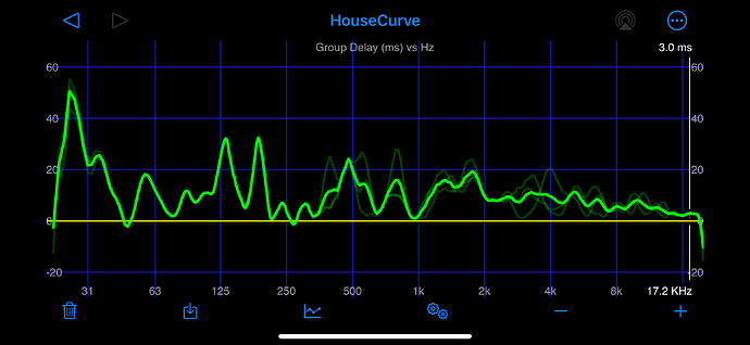

Here’s the “before” group delay:

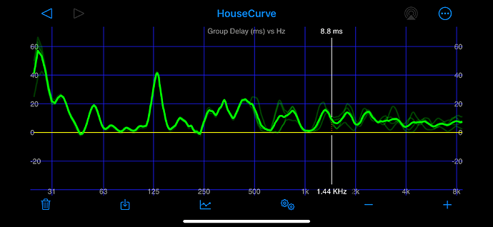

And here’s the After (to 8k):
So, i guess my subs are rather slow/delayed at 25-30 Hz, but not sure why there’s a large spike at about 128 Hz, or what I can do about that could it be the crossover point needs moving on the subs?
The group delay looks pretty normal. The ramp up on the left is, I think, because the system works harder / room fights you - most systems show this. The spike at ~128 is probably a room mode. The magnitude plot looks ok though, so maybe not something to worry about. Moving the sub/main crossover might have an effect.
I usually get “after” measurements closer to the prediction. The trick is to try and use exactly the same mic locations. Regardless, if your ears are happy, then job done :slight_smile:
