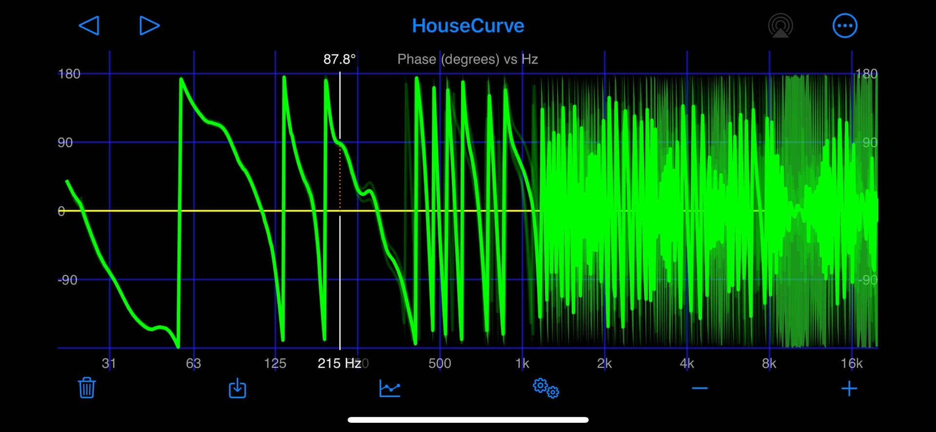

My question is regarding phase. Here is the ‘before’ phase chart - it looks like a terrible mess to me - what does it mean?
Thanks Mike, glad you’re getting decent results. You could add more bass by changing the target curve, maybe add a bit of a bump below 100 Hz?
Your phase plot looks pretty normal for a room measurement. They’re always messy. I mainly use them for checking sub/main alignment. Some more info on plots here. The group delay plot is a bit more useful. It basically shows where phase isn’t smoothly sloping downwards. The peaks in the group delay indicate areas of interest - room modes, driver alignment issues, etc.
