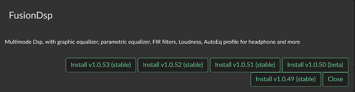

@balbuze Hello,
what is the FusionDSP version on Pi version of Volumio? I have the Rivo and no longer a Pi to check. thank you. Cenk
Almost @balbuze , but from a different country and native tongue.
He’s most likely looking at Baton Twirling, secret pleasure ![]()
Yes, all devices run FusionDsp v1.0.53
