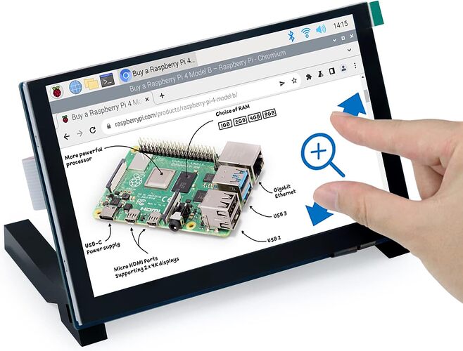

So im using a 5 inch DSI Screen with my PI 5, but it doesnt turn on, its just black
Does anyone know what to do?
Heres the screen:
And heres the cable im using:
maybe you can help @gvolt
Assuming “/boot/config.txt” and “/boot/userconfig.txt” are unaltered you could try adding
dtoverlay=vc4-kms-v3d
dtoverlay=vc4-kms-dsi-7inch
to “/boot/userconfig.txt”.
That didnt work ):
I have just found out (by accident lol) that the touchscreen works! (idk if it worked before your fix)
But the screen is still Black/Off
i just plugged it in and out again and now it shows the boot console, but then its going black again
Stop the Touch Display plugin.
Then execute
sudo bash -c 'cat << EOF >  /etc/X11/xorg.conf.d/99-vc4.conf
Section "OutputClass"
    Identifier "vc4"
    MatchDriver "vc4"
    Driver "modesetting"
    Option "PrimaryGPU" "true"
EndSection
EOF'
Start the Touch Display plugin again.
