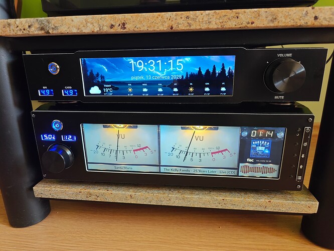

after a 10 minutes wait, when killing the power connection:
volumio@rpi5-ws840:~$ date && sudo hwclock --show
Fri Jun 13 19:31:59 CEST 2025
2025-06-13 19:31:59.285404+02:00
volumio@rpi5-ws840:~$ ntpq -p
     remote                                   refid      st t when poll reach   delay   offset   jitter
 0.debian.pool.ntp.org                   .POOL.          16 p    -   64    0   0.0000   0.0000   0.0005
 1.debian.pool.ntp.org                   .POOL.          16 p    -   64    0   0.0000   0.0000   0.0005
 2.debian.pool.ntp.org                   .POOL.          16 p    -   64    0   0.0000   0.0000   0.0005
 3.debian.pool.ntp.org                   .POOL.          16 p    -   64    0   0.0000   0.0000   0.0005
 86-80-166-233.fixed.kpn.net             158.255.145.140  3 u   24   64    1  16.2134  -2.9280   1.3703
-host-miq.as15435-c.v4.dfn.nl            .kPPS.           1 u   43   64    1  16.2702  -3.1083   0.7230
 mail.roundowl.tk                        192.171.1.150    2 u    3   64    1  13.6713  -1.1942   1.3282
 connected.by.freedominter.net           10.1.105.4       2 u    1   64    1  15.8647  -0.6890   1.2937
 connected.by.freedominter.net           10.1.105.4       2 u    -   64    1  18.2509  -1.0765   4.5065
+185.244.24.70                           94.198.159.10    2 u   42   64    1  13.1345  -0.5130   1.3202
*ntp2.as215248.net                       .PHC0.           1 u   30   64    1  15.3063  -1.5306   0.3811
-ntp01.cobytes.io                        94.198.159.10    2 u   42   64    1  11.2546   0.1308   1.6912
 v6-4.forfun.net                         .STEP.          16 u    -   64    0   0.0000   0.0000   0.0005
 ht.jnd.ovh                              .STEP.          16 u    -   64    0   0.0000   0.0000   0.0005
 2001:1af8:4700:a052:2::116c             .STEP.          16 u    -   64    0   0.0000   0.0000   0.0005
 ntp1.ams.nl.hojmark.net                 .STEP.          16 u    -   64    0   0.0000   0.0000   0.0005
 connected.by.freedominter.net           10.1.105.4       2 u   55   64    1  17.7020  -2.2791   0.6783
-mail.novg.net                           131.188.3.220    2 u   27   64    1  10.7123  -1.2414   0.6371
-ntppool1.time.nl                        .TMNL.           1 u   41   64    1  17.7761   0.9542   3.9751
-hosted.by.xyphen.it                     192.87.106.2     2 u   41   64    1  15.4903   1.6052   3.1138
-auth-qupra-ams-nl.ebgp.fi               61.233.105.6     2 u   40   64    1  10.6405  -1.1389   1.3766
+time1.panq.nl                           192.171.1.150    2 u   31   64    1  10.6405  -0.3088   0.2701
+ams.ns.sysn.net                         125.199.53.76    2 u   40   64    1  10.6922  -1.0352   0.3593
volumio@rpi5-ws840:~$ dmesg | grep -i "rtc"
[    0.461711] rpi-rtc soc@107c000000:rpi_rtc: trickle charging enabled at 3000000uV
[    0.466901] rpi-rtc soc@107c000000:rpi_rtc: registered as rtc0
[    0.468280] rpi-rtc soc@107c000000:rpi_rtc: setting system clock to 2025-06-13T17:30:55 UTC (1749835855)

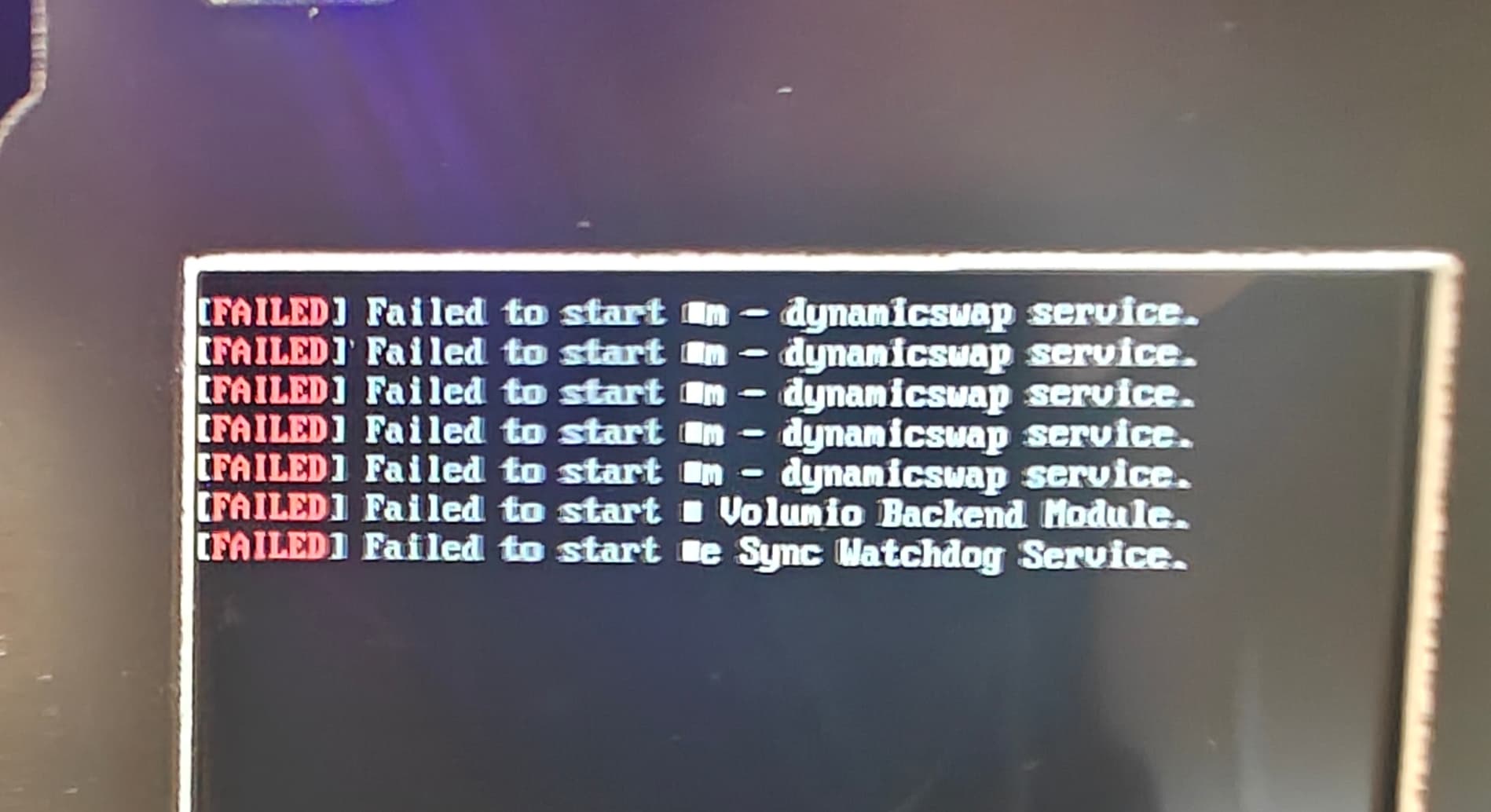

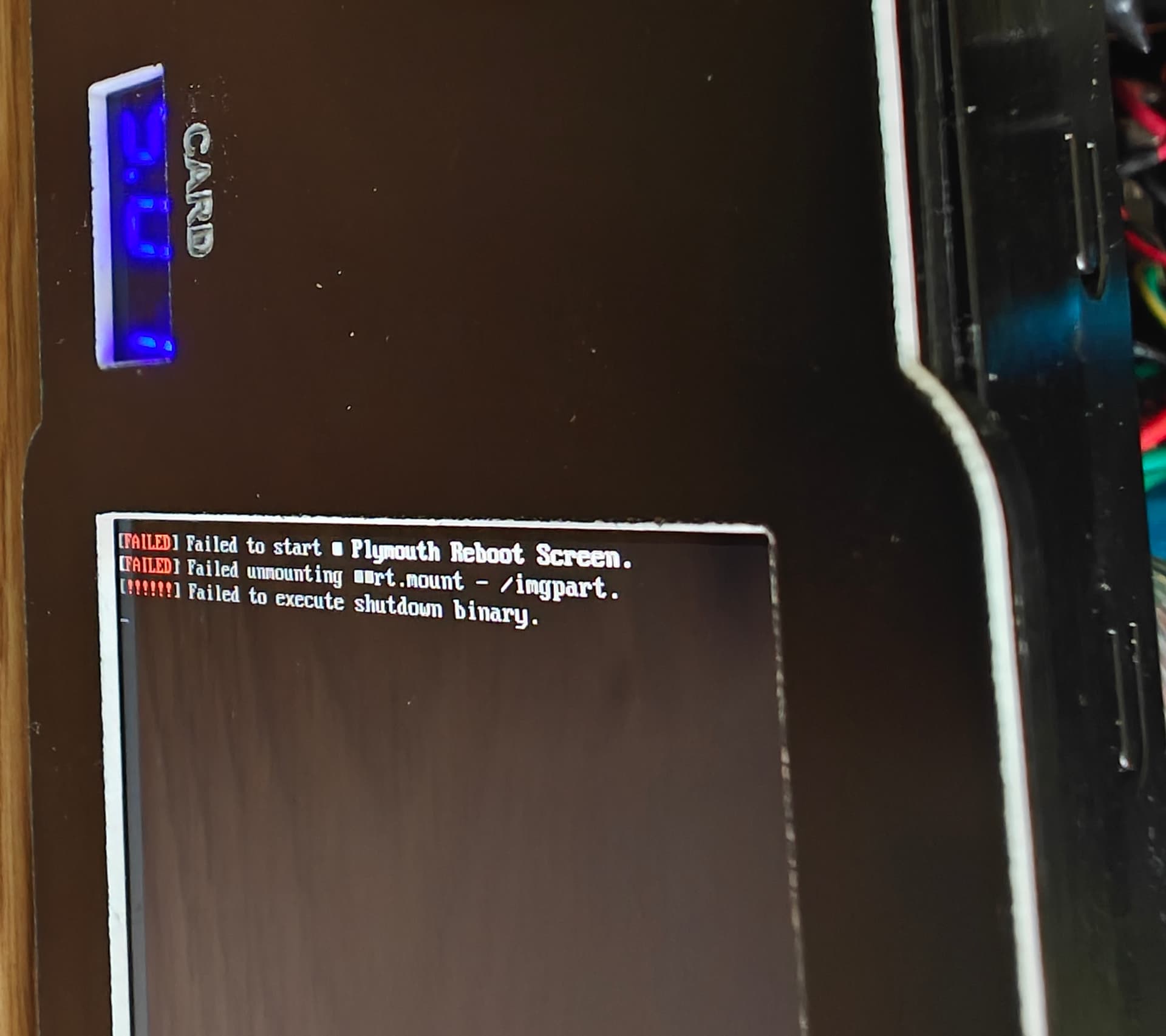

How I love this forum! Great and humorous people! but because of your auctions, my disk crashed.
Ah, the joys of technology—the forum giveth, and the forum taketh away! :laughing:
One minute, you’re laughing at top-tier humor, the next, your disk decides to go on a spontaneous vacation. Failed to start Plymouth? Sounds like your Raspberry Pi just rage-quit on life. Failed unmounting rt.mount? Guess it’s holding on for dear life. And that shutdown binary? Well, it’s clearly on strike.
But hey, at least you got some good laughs out of it—consider it the price of admission! :laughing: Now, let’s see if we can bribe your Pi back to working order!
Hey @Gelo5,
As trivial as it may be - did you unplug the RTC battery?
NVme disconnected. (RPI5)

Hey @Galo5,
Following up on your NVMe-related crash. Since your setup uses:
  • nvme0n1p1 - bootpart (vfat)
  • nvme0n1p2 - imgpart (ext4, rootfs overlay)
  • nvme0n1p3 - datapart (ext4, holds configs, etc.)
Here’s what you could try:
Recovery steps (from microSD rescue boot)
  1. Boot from a known-good microSD Volumio image
    Ensure NVMe is connected and detected.
  2. Run filesystem checks:
sudo fsck.ext4 -f /dev/nvme0n1p2   # imgpart
sudo fsck.ext4 -f /dev/nvme0n1p3   # datapart
(Optional, if suspecting boot issues)
sudo fsck.vfat -v /dev/nvme0n1p1
  1. Mount partitions for manual inspection:
mkdir -p /mnt/img /mnt/data
sudo mount /dev/nvme0n1p2 /mnt/img
sudo mount /dev/nvme0n1p3 /mnt/data
  1. Verify critical files:
  • /mnt/data/configuration.json
  • /mnt/data/...
Also make sure the upper/ and work/ directories inside /mnt/img are valid and not corrupt.
Once that’s done and everything checks out, power down, remove the microSD, and cold-boot again from NVMe.
If any logs or files look suspicious, feel free to post them here and I’ll help walk through them.
Whatever, let it be Galo5 :partying_face:
I removed the NVme drive and sent it back,
but thanks for your help.
Hey @Gelo5,
Ah, Galo5 it is then!
Sad to see the NVMe go before we could properly dissect it. There was potential for a legendary deep dive into corrupted overlayfs chaos
But alas, the patient flatlined before autopsy.
We’ll remember it fondly:
  • As the card that took dynamicswap.service down with it,
  • That unmounted /imgpart with vengeance,
  • And brought shutdown binary to its knees.
Gone, but not fsck’d.
We’ll get ‘em next boot.

after OTA update from 4.010 to 4.012 I see multiple player restarts while searching a title in my Tidal Title list.
http://logs.volumio.org/volumio/VknbLNf.html
Best regards,
Robert
OTA 4.011 to 4.012
Pi4B, SD card, 7" RPi display, Topping D10s USB DAC
Logs http://logs.volumio.org/volumio/sqV4250.html
Perfect!
Tested base functionality: BT connect, play here, Multiroom, local and network drive playback, web radio, infinity search.
Plugins: Touch Display, now playing, Spotify, Bandcamp, SoundCloud, IR remote, backup and restore, system info.
Good morning,
Just installed 4.012 via OTA - went without problems.
Reboot from installer/GUI still doesn‘t work.
BT remote still is connected but doesn’t work. Maybe it’s more a triggerhappy issue, not BT.
(HW) Config:
Pi5,
Raspi 2 Display (DSI),
NO BT remote :slight_smile:
Testing:
  • “Now Playing” plugin works
  • Rotary encoders are both working
  • BT remote is NOT working (connected but no signals detected)
Regards,
Ralf
