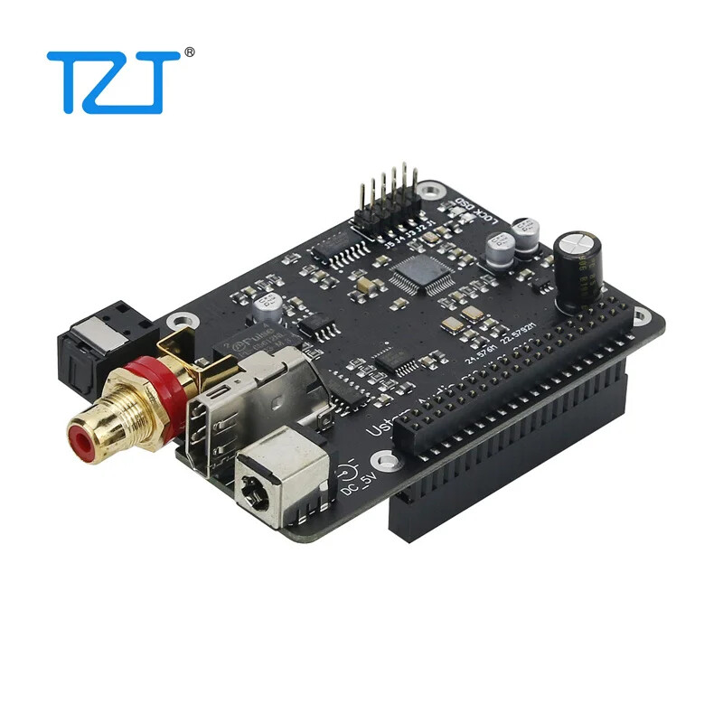

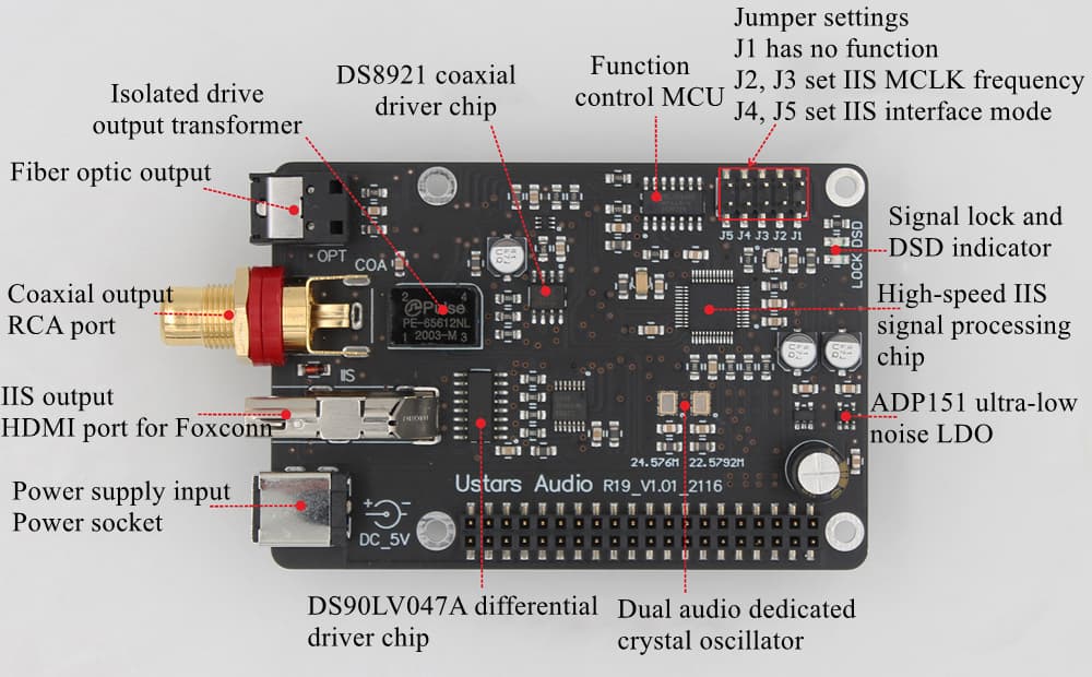

The board is from Aliexpress:
And using playback option of “Audiophonics I-Sabre ES9028Q2M” as per the item’s ad.

Hey @RedEyeNinja,
Thanks for both detailed logs and testing across hardware (Pi5 and Pi4) and output types. Here’s what I found from your two logs and your test matrix:
1. Pi5 8GB with NVMe - Log: A9LmhBF
  • You’re using the “Audiophonics I-Sabre ES9028Q2M” profile.
  • The board is a generic TZT/Ustars clone of an ESS-based HAT.
  • Based on the log and your matrix:
    Findings:
    • PCM up to 96/24 plays cleanly over i2s/HDMI and SPDIF.
    • 192/24 on i2s shows playback active but no actual output to DAC. This could suggest either:
      • The HAT silently rejects 192kHz over i2s, or
      • The driver (snd-soc-i-sabre-q2m or overlay) is misreporting capability.
    • DSD fails on i2s when switching between DSD tracks. Initial track plays silently, next causes dropout. Classic sign of broken DSD DoP handshake or buffer negotiation failure.
    • All SPDIF playback OK, which aligns with the DAC likely handling SPDIF separately via onboard receiver.
    Suggestions:
    • Consider trying “Generic I2S DAC” profile for further isolation. Many clone HATs diverge from Audiophonics’ true GPIO mappings or kernel expectations.
    • Also try toggling “DSD Direct” vs “DoP” modes if selectable.
    • Confirm that “Mixer Type” is set to None, to prevent software volume interference.
