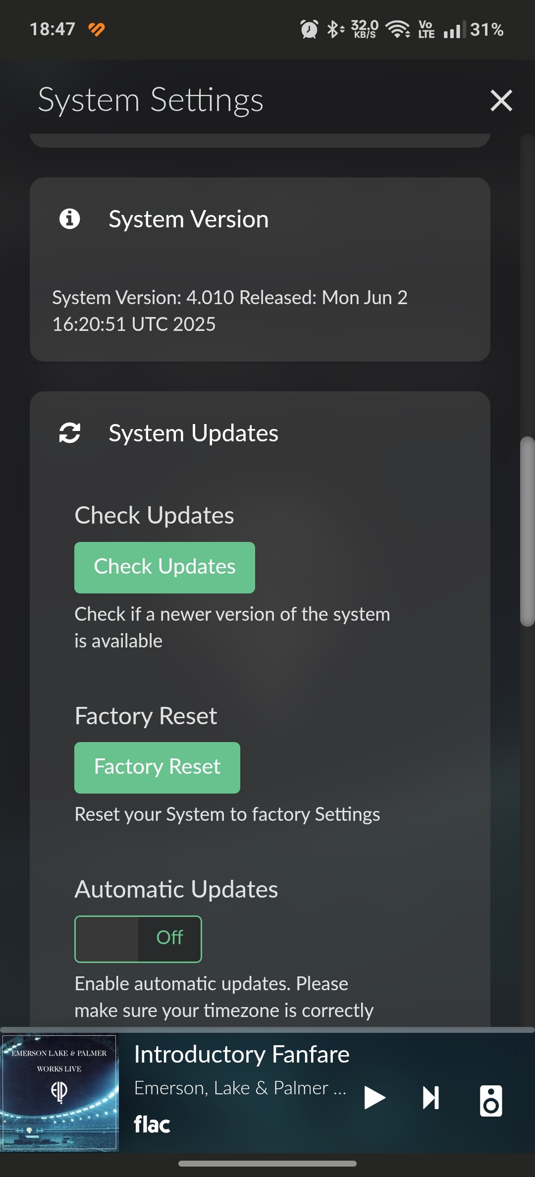

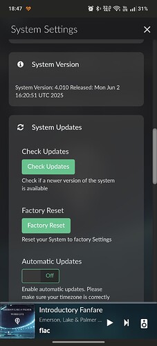

OTA update - without problems.
Hehe - first
I turn on the raspberry - and here I see: new software available! Beta has arrived!
Updated Via OTA from Alpha - without problems.
Pi5
NVME
Music stored on NAS (1800 ripped CDs)
Cambridge Dacmagic 200m
Spotify and YouTube music plugins
I used Backup and Restore as it saved a lot of time with settings and the large NAS of albums
Steve

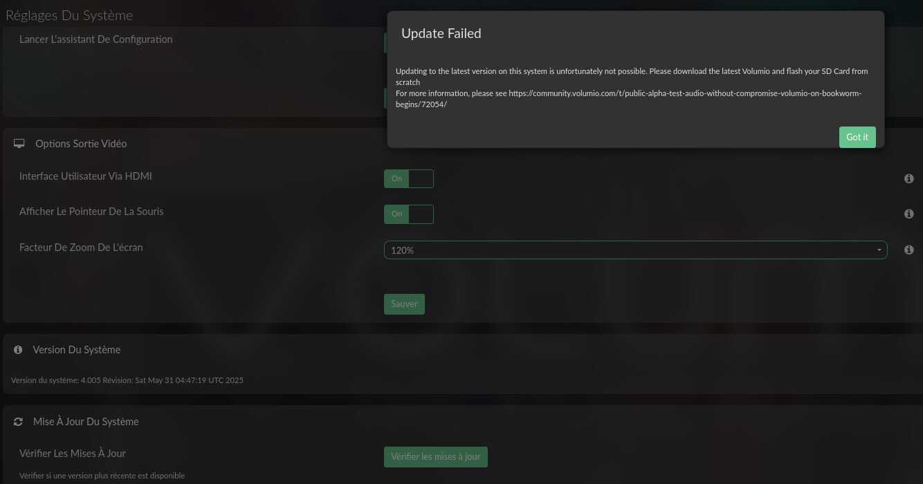

I‘m not sure what I‘m doing wrong but I do not get 4.010.
System offered me an upgrade from alpha 4.005 to 4.008, which I have installed right now but now the system is „up to date“ ….
No beta available for me :frowning:
Thanks for a hint!
Regards,
Ralf
Hey @rkorell
Volumio now includes a Release Channel Selector, allowing you to easily choose which update stream your device follows:
  • Stable – Default, production-grade releases
  • Test – Pre-release builds with staging fixes
  • Alpha – Experimental builds for early testing
You can find the selector at:
http://<volumio_ip>/dev
Screenshot from 2025-05-29 13-29-28
Nothing extra is needed – just visit /dev and select your preferred update channel.
Dear @nerd ,
sorry for being this blonde…
Yes - this should be known by me…
Thanks for tutoring!
Ralf
@SimonE
Did you select test as update channel, as your summary shows V4.008?
No! I’m still on Alpha channel. Fixing it now.
OK, this is my second system (this one is really on 4.010!)
This is a fresh flash
Logs http://logs.volumio.org/volumio/xxxxx.html
Hardware Pi4B, HDMI output.
Tested network drive, Touch Display, Now Playing, Spotify.
All good!
Dear @nerd , team,
if one selects the right update channel, OTA updates will work as desired :slight_smile:
