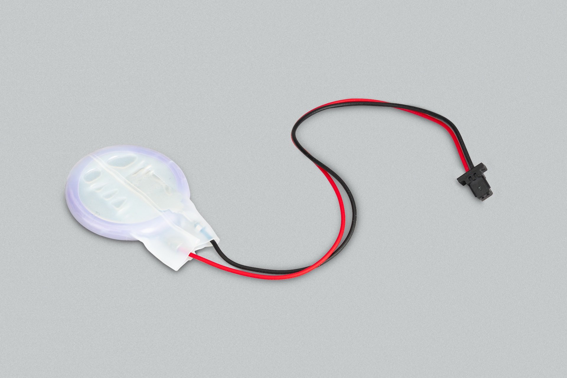

Hi @nerd and @Wheaten !
I just found this on raspberrys own site, is this not working?
Add a backup battery
Lithium-manganese rechargeable RTC battery
The official battery part is a rechargeable lithium manganese coin cell, with a pre-fitted two-pin JST-SH plug and an adhesive mounting pad. This is suitable for powering the RTC when the main power supply for the board is disconnected. Since the current draw when powered down measures in single-digit µA, the retention time measures in months.
Note We do not recommend using a primary (non-rechargeable) lithium cell for the RTC. The RTC backup current consumption is higher than most dedicated RTC modules and will result in a short service life.
Warning Do not use a Lithium Ion cell for the RTC.
Enable battery charging
The RTC is equipped with a constant-current (3mA) constant-voltage charger.
Charging of the battery is disabled by default. There are sysfs files that show the charging voltage and limits:
/sys/devices/platform/soc/soc:rpi_rtc/rtc/rtc0/charging_voltage:0 /sys/devices/platform/soc/soc:rpi_rtc/rtc/rtc0/charging_voltage_max:4400000 /sys/devices/platform/soc/soc:rpi_rtc/rtc/rtc0/charging_voltage_min:1300000
To charge the battery at a set voltage, add rtc_bbat_vchg to /boot/firmware/config.txt:
dtparam=rtc_bbat_vchg=3000000
Reboot with sudo reboot to use the new voltage setting. Check the sysfs files to ensure that the charging voltage was correctly set.
it works have the same on my rpi5 :slight_smile:
Hey @ClaesM,
I thought I mentioned it, yet I did not.
Just to clarify for others following this thread: I didn’t mention the RTC battery charging capability in my original post for a good reason.
With confirmed issues when enabling the charge feature on the Raspberry Pi 5 RTC, such as:
  • RTC stops functioning when charging is enabled (dtparam=rtc_bbat_vchg=...)
  • Missing sysfs entries to confirm charging status
  • Battery not charging as expected
  • Compatibility problems outside Raspberry Pi OS
Things are improving, however I’m avoiding it in production setups for now. Please share your experiences.
Hi again!
Did you put dtparam=rtc_bbat_vchg=3000000 in config or userconfig?
Yes I did.
Also found that the given commands don’t work:
Went by:
/sys/devices/platform/soc@107c000000/soc@107c000000:rpi_rtc/rtc/rtc0
cat /sys/devices/platform/soc@107c000000/soc@107c000000:rpi_rtc/rtc/rtc0/charging_voltage
3000000
cat /sys/devices/platform/soc@107c000000/soc@107c000000:rpi_rtc/rtc/rtc0/charging_voltage_max
4400000
cat /sys/devices/platform/soc@107c000000/soc@107c000000:rpi_rtc/rtc/rtc0/charging_voltage_min
1300000
cat /sys/devices/platform/soc@107c000000/soc@107c000000:rpi_rtc/rtc/rtc0/battery_voltage
3078629
3079484

Hi there!
I thougt I would give it a try so I added your code above (rtc charging) .
I seems to work! Thanks!
Regads/ C
