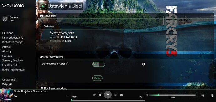

The Raspberry Pi 5 (Volumio 4.026) is connected to the Fritzbox router over Wi-Fi and at the same time a LAN cable is connected to the Raspberry Pi 5 (Volumio).
The Wi-Fi network settings disappear - in the Volumio network settings menu - there is no option to connect over Wi-Fi.
The LAN settings appear in the Volumio network settings. Only LAN connection works - Raspberry Pi (Volumio 4.026)
After disconnecting the LAN cable from the Raspberry Pi 5, Wi-Fi connection to the router returns - regardless of 2.4 - 5 GHz - WPA2 or WPA2/3.
The Volumio menu appears - networks - Wi-Fi settings - and the LAN settings disappear.

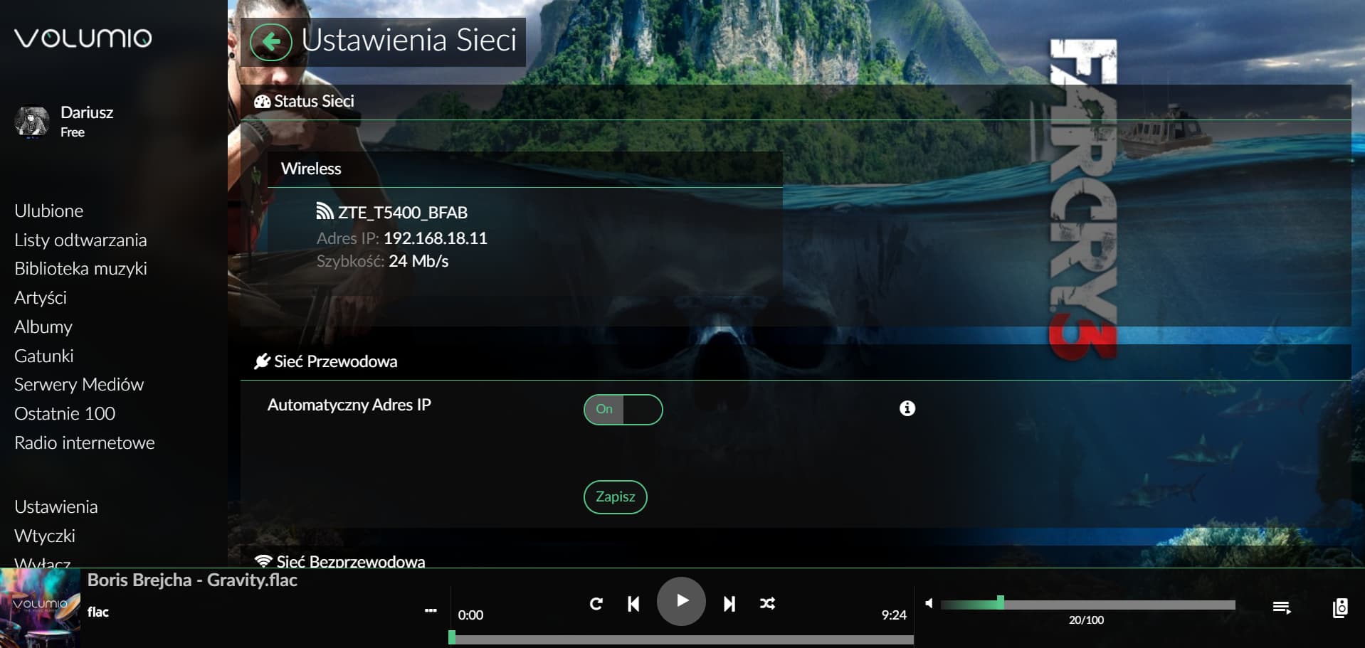

ok but the problem are the information settings over GUI when save data not work, I save data for connection via wifi disconnect LAN cable and not work via wireless connection this is the problem, also if I restard raspberry.
My personal opinion are both interface must be UP like old version and end user deactivate one of this,in alternative GUI must save data also if LAN cable are plug in.

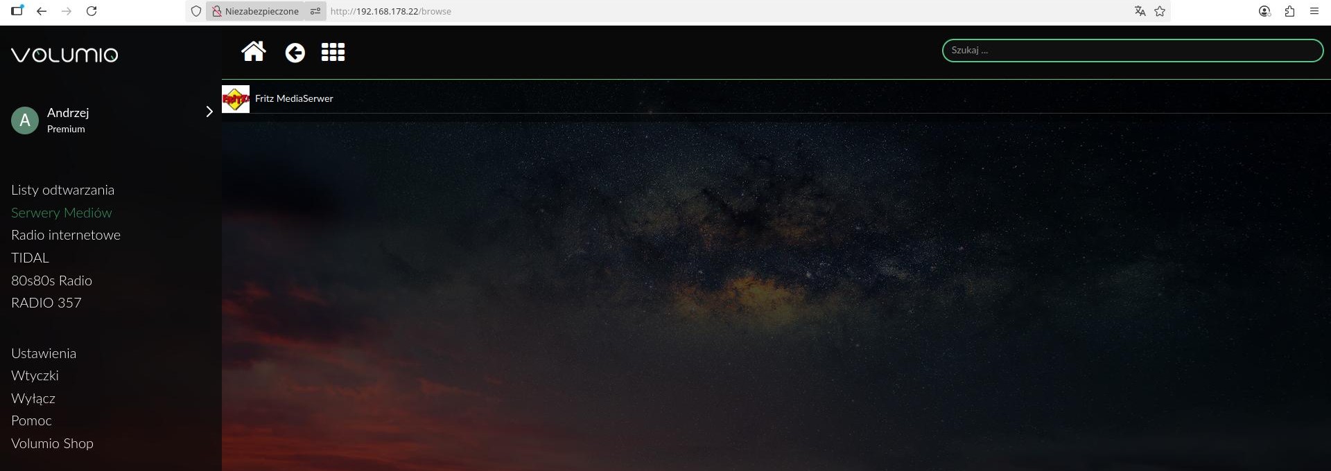

The “Media Servers” plugin in Volumio sees the Fritzbox – the “Fritzbox MediaSerwer” sees the drive connected to the Fritzbox.
After accessing this drive via the Media Server plugin, it sees the drive’s contents – directories and music files. I can play these files using Volumio without any problems.

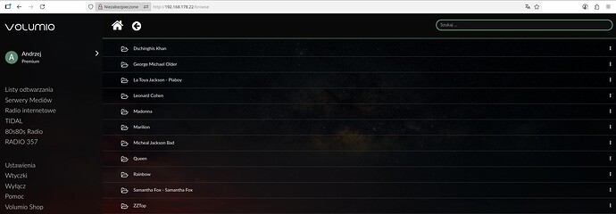

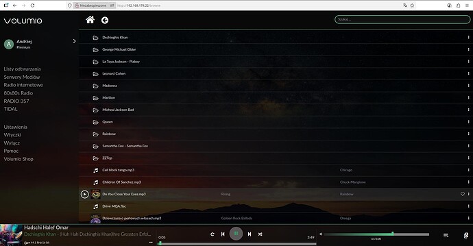

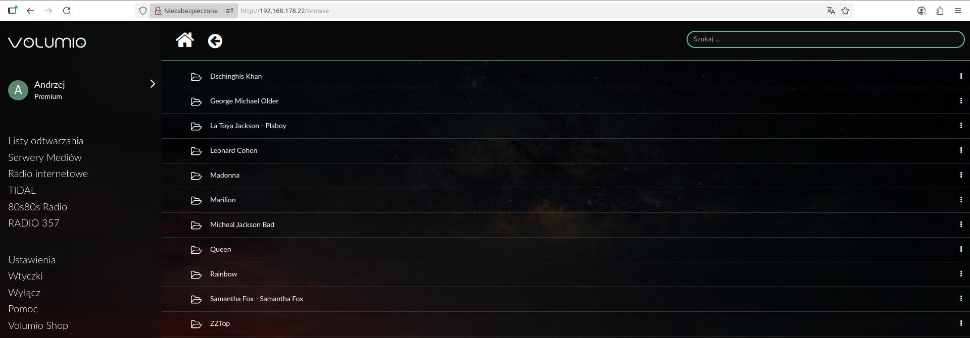

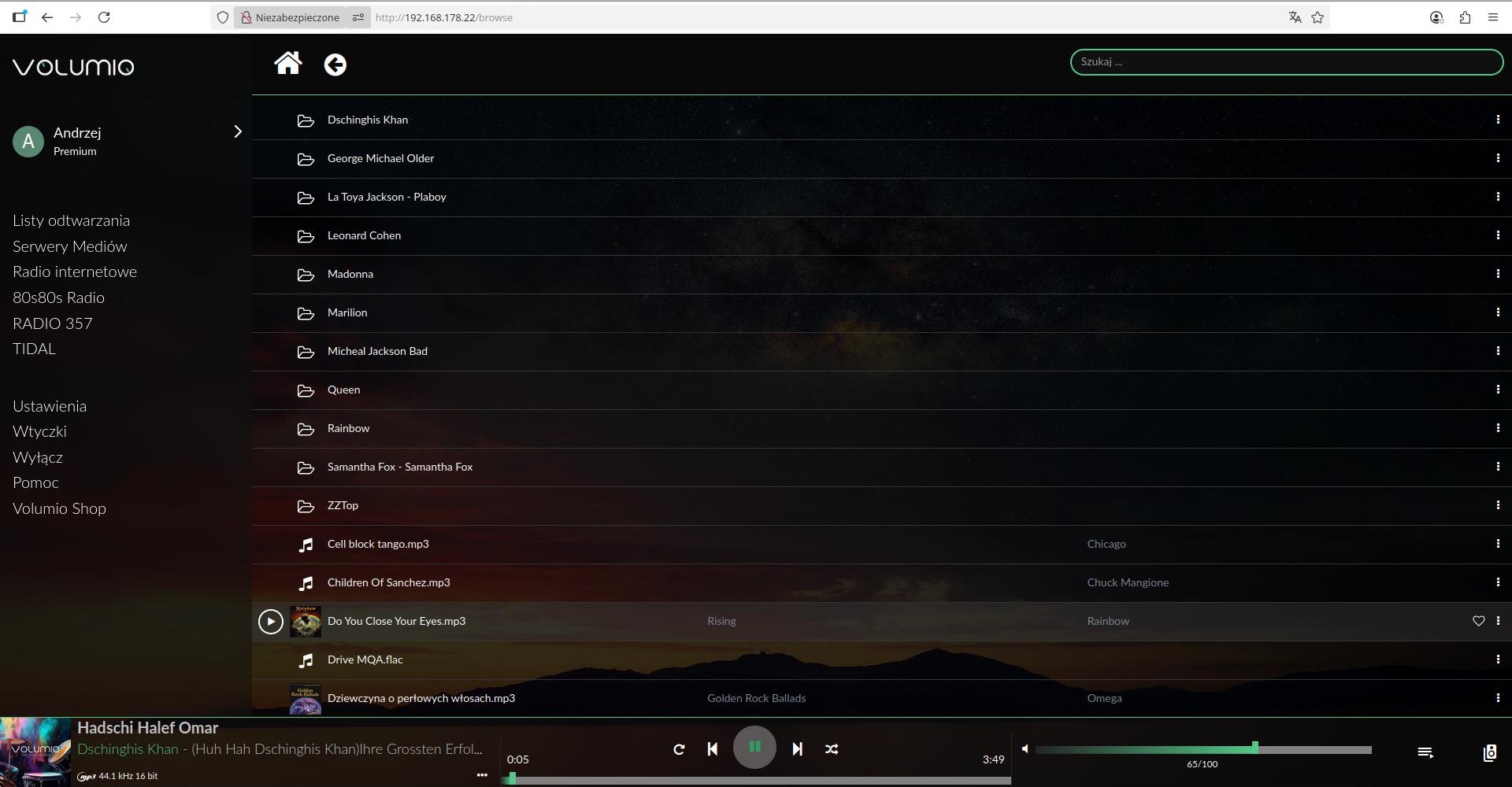

I found another bug when playing files using the Media Servers plugin.
The network drive (connected via USB to the router) has a root directory containing music directories and, separately, the music files themselves.
When selecting a music file from the root directory, the first file in the first directory is selected for playback. Instead of the correct music file.
For example, in the picture, I select the song “Drive MQA.flac” or “Cell block tango.mp3” for playback, and the first music file in the directory is selected: Dschinghis Khan
Example music directories and separate music files.
This problem was not present in version 3.832.

I have test several time and a little bug persist, if I start first time (fresh install) my raspberry PI 5 at network tab select my wifi network and GUI freeze (lan cable plugged in).
If I start up (fresh install) and not try to connect to my wireless router after finish power up go in network setting (LAN cable plugged in) select my network insert my wpa key SAVE it GUI interface freeze.
I unplug LAN cable but no connections to my router so I power off my Raspberry (GUI are freezed) and after restart finally (LAN cable sconnected) my wireles connections are ok.
