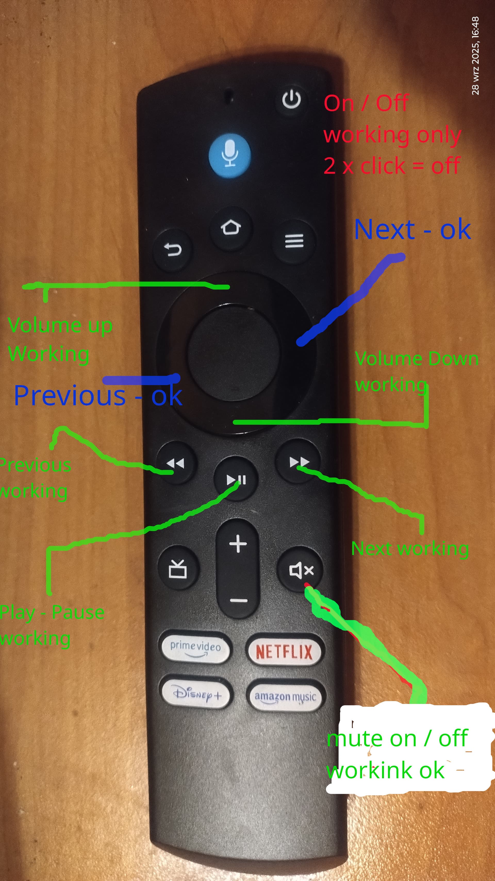

Raspberry Pi 5 - Volumio 4.028 - Bluetoothremote plugin
Remote control from the photo below.
In the file:
/data/INTERNAL/Bluetooth_Remote/triggerhappy.conf
After adding:
KEY_MUTE 0 volumio volume toggle
The mute on/off button works after restarting the Raspberry Pi.
The next keys work ok - links in blue in the photo - after adding entries as below.
KEY_LEFT 1 volumio previous
KEY_RIGHT 1 volumio next
