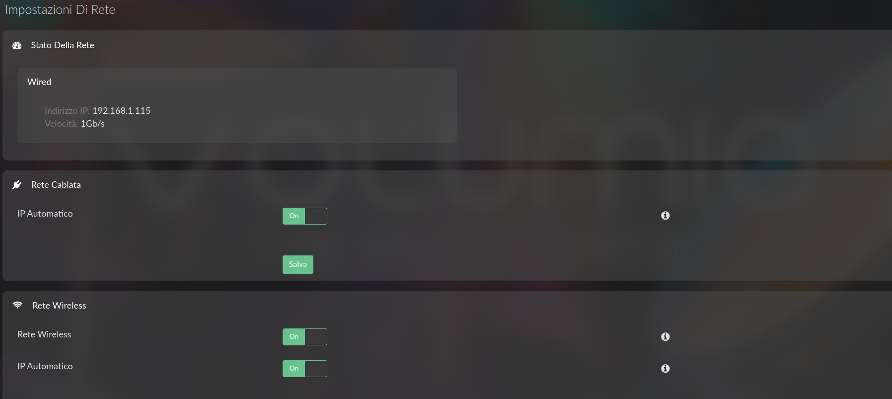

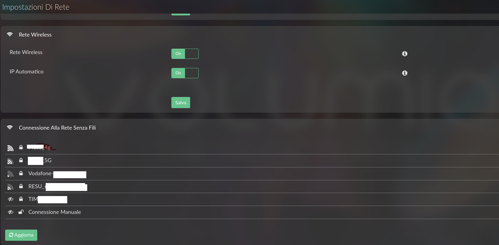

Hey @nerd ,
driver are loading correctly Volumio see all network 2.4 or 5 I think possibility this bug are related writing data from GUI in other board like Atom issue are present
In attached file from raspberry PI 5, below GUI first two are my network
Nerd_log.txt (10.2 KB)
regards
