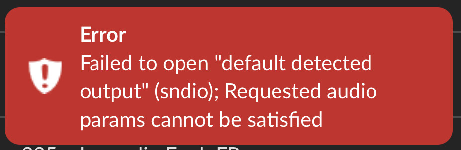

Since yesterday i get a message box when trying to start webradio after reboot
After going to play options and save the i2s device configuration without altering anything it saves the config and successfully starts the sound device.
After that everything is working until the next reboot.
Surprisingly this was not the case the first few days with v4.013
Pi3b
Allo Kali + Piano 2.1 in dual mono mode
Volumio v4.013

a few hours and some reboots later the issue solved itself and i cannot reproduce it any longerâŚ

oh sorry - i created and a uploaded a log but forgot to copy the link here
But as mentioned in the EDIT the issue disappeared after a while and i cannot reproduce

Hey @Josh2000,
Thanks for following up with the log link.
From the log contents, the playback error you encountered:
Failed to open "default detected output" (sndio); Requested audio params cannot be satisfied
is confirmed to be ALSA-related, and occurred because MPD could not route audio to the DAC during early startup.
Key findings:
Your DAC (PianoDACPlus) is detected properly as
card 2
, but MPD uses a complex virtual routing layer (volumioHw -> volumioOutput -> postMultiRoom
) and likely tried to initialize before the DAC was fully available in the device tree. -
The ALSA restore service failed:
alsa-restore.service: Failed with result 'exit-code'.
Exit code 99 typically means alsactl restore
ran before the card was initialized.
- Supply regulators AVDD/DVDD/CPVDD were not found for the DAC overlay, and dummy regulators were used:
pcm512x 1-004d: supply AVDD not found, using dummy regulator
This is expected on some DAC setups and not fatal.
- User fix (âre-saving I2S DAC in playback settingsâ) retriggers the overlay binding and resets ALSA state, which is why it worked.
Conclusion:
This looks like a cold-boot race condition in ALSA device readiness on the Bookworm kernel (6.12.27-v7+
). It resolved itself later likely due to changes in boot timing, SD card I/O delay, or power variance.
We need to keep an eye on this condition as it suggests a kernel regression of sorts.
