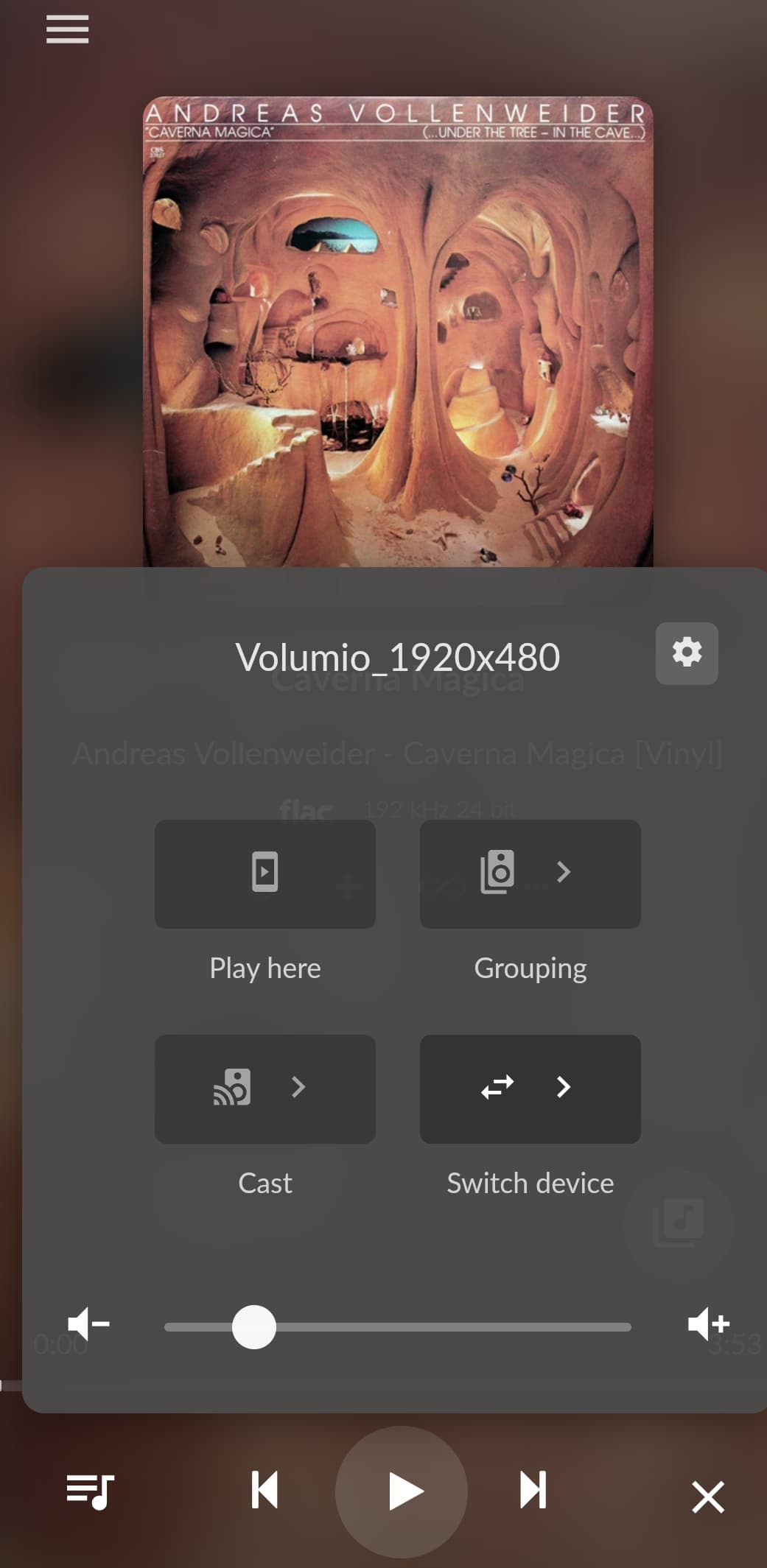

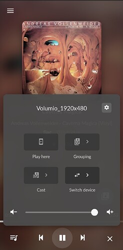

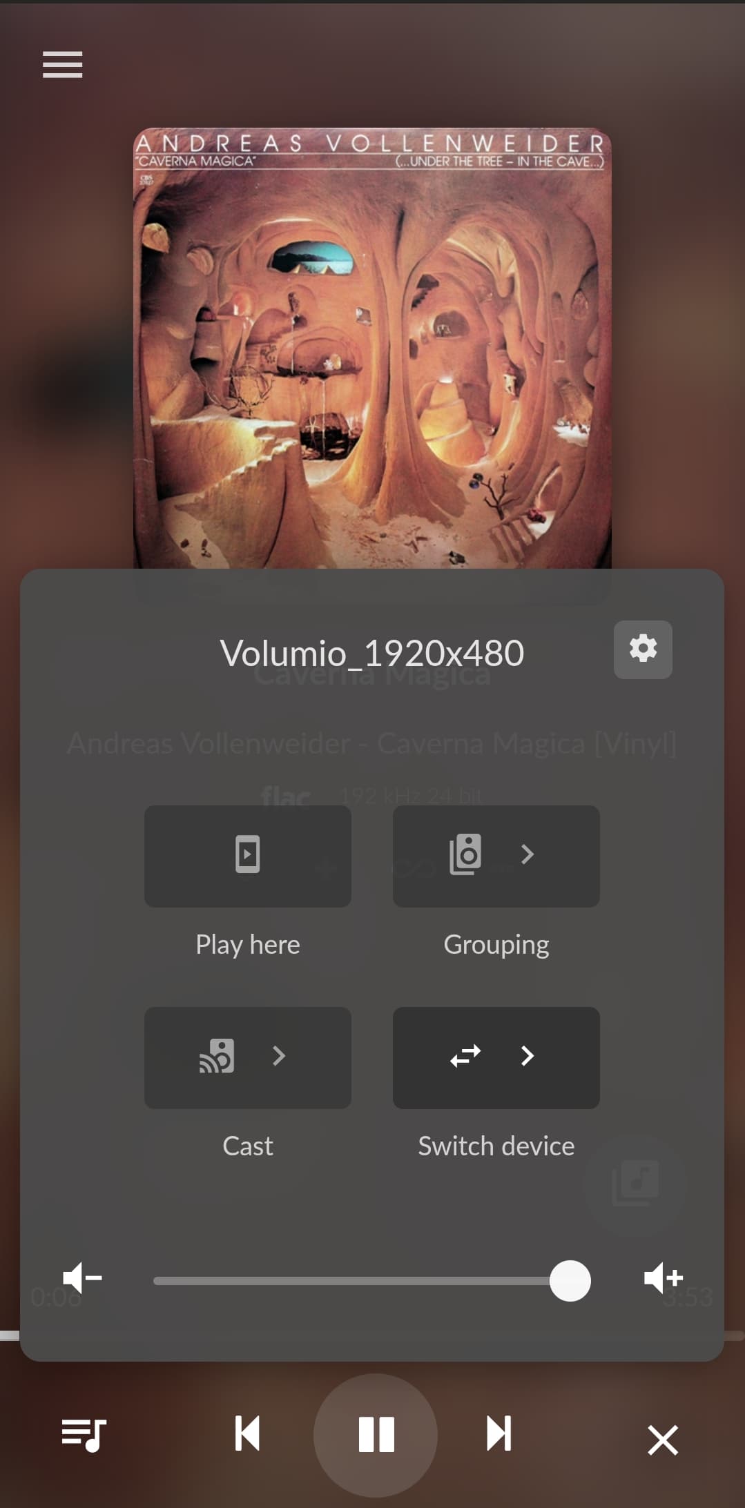

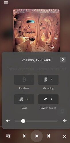

after starting Voumio:
after pressing Play:
I think it’s the same with @balbuze
Hey @Gelo5,
Does the behavior remain the same after disabling all plugins that interact with the audio path and performing a full power off cycle (complete energy starvation)?
I’m wondering if this might be residual state stored in EEPROM.
Hey @nerd
after disabling all plugins: the same situation.
