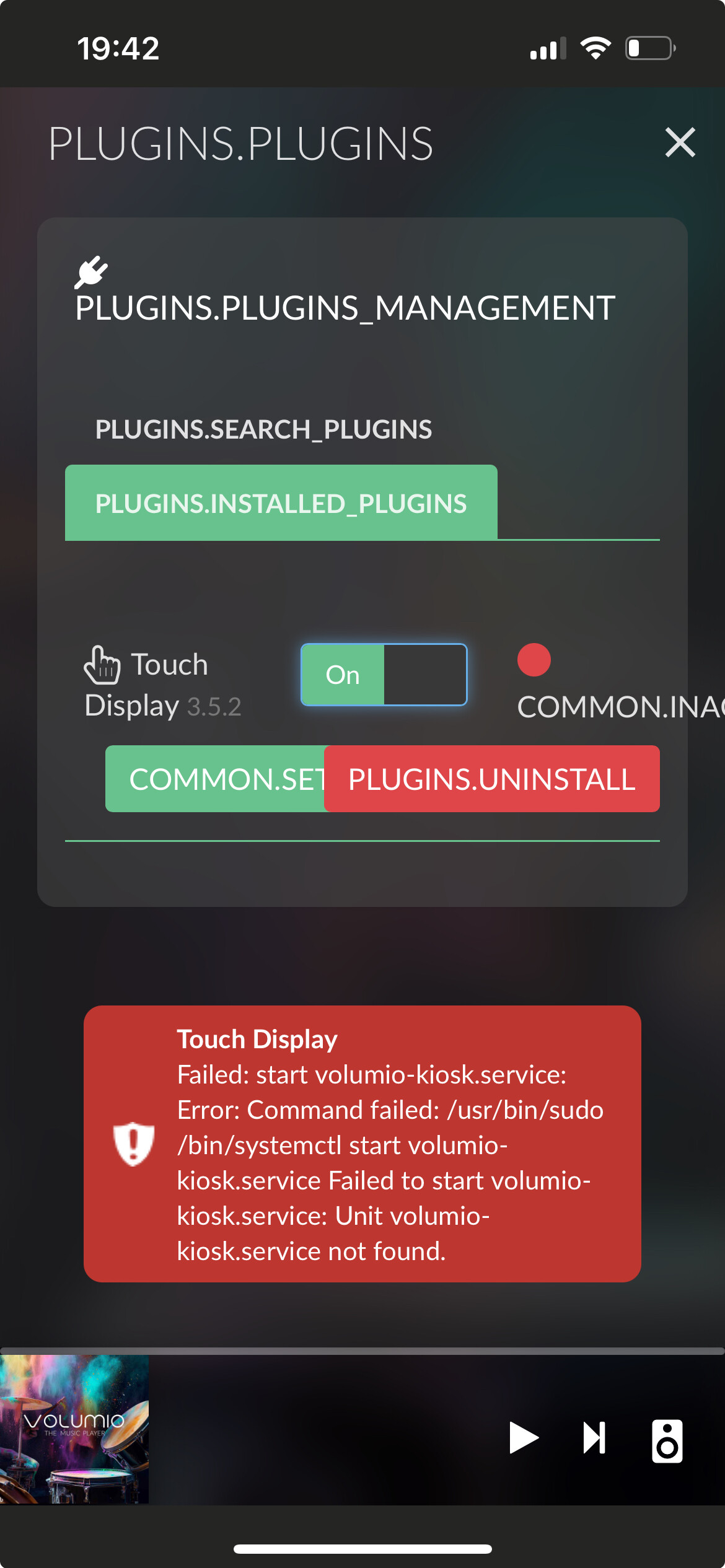

When i try to install touch display plug-in o have this
Plugin appear as installed but when in want to enable it
http://logs.volumio.org/volumio/xks2YMm.html
Ps
Now it is working …

Hey @Lintbf,
Thanks for your update, and glad to hear the Touch Display plugin is now working.
Regarding Qobuz Connect in version v4.002:
As clearly noted in the ALPHA changelog, Qobuz Connect is currently not available in the ALPHA builds. This applies to all current ALPHA versions, including the one you’re now using.
