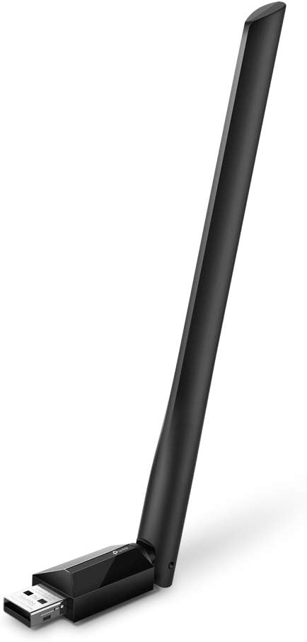

Playing with several wifi dongle with this new version, but no joy. BTW do you think if i got my hands on this would it work out of the box or possibly with the Userconfig.txt tweak.
