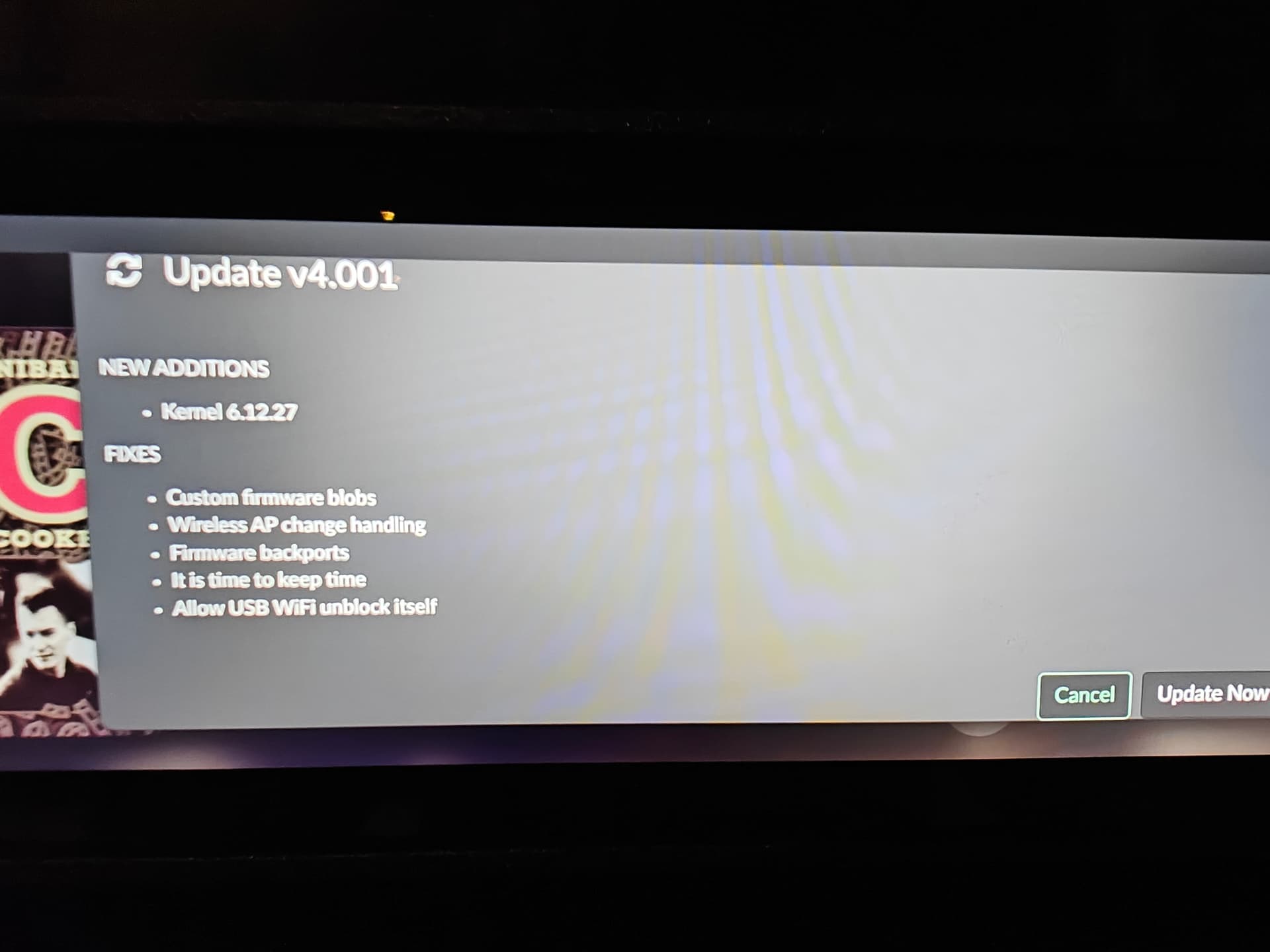

Good news,
Audiophonics evo sabre v 2.0.1 is available in bookworm now!
Test and feedback!
Thank you @olivier_audiophonics
Is this a new alpha or is it jist asking to update to the existing stable?
PLEASE SEE Public Alpha Test: Audio Without Compromise - Volumio on Bookworm Begins - #534 by nerd
Ok! I’ll let it update.
@RedEyeNinja The advice is not do that until the version is officially communicated/ released as @nerd wrote
