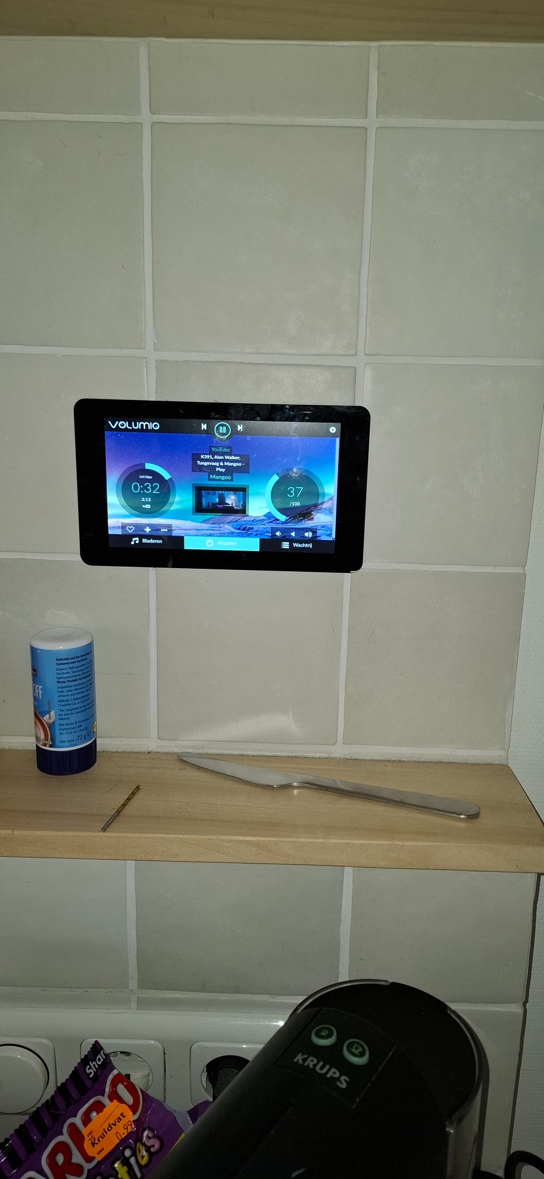

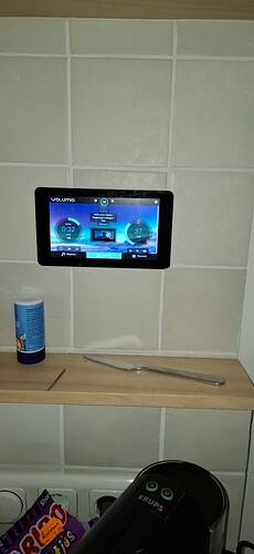

Dear @nerd , team,
today my volumio proposed next update (didn‘t see an announcement here but may missed it)
Update (OTA) to 0.069 has again worked without any problem - reboot still worked directly.
(HW) Config:
Pi5,
Raspi 2 Display (DSI),
BT remote &
Testing:
- Spotify plugin, works (my only use case).
- Touch display (and corresponding plugin) works
- Rotary encoders are working
- BT remote is working
- WiFi is working (can access from laptop / phone).
- “Now Playing” plugin works
Great work, again!
