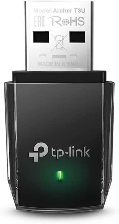

    V0.069 and WIreless adapter, TP-Link Archer T3U [Realtek RTL8812BU]:

I see the driver is loaded, however unable to configure it. It either won’t scan the network or disables WiFI in the network settings.
If I add to /boot/config.txt:
dtoverlay=disable-wifi
Reboot, then it appears I can connect, however the network indicator (green LED) won’t blink.

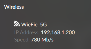

Looking at the connection speed it seems to be connected:
But after a reboot, the connection is gone. Device disappeared from the network.

@Wheaten that is something I noticed as well, it is the same with an EDUP 802.11ac device, the usual blue led is not showing either. This will probably be a driver (setting?) issue.
