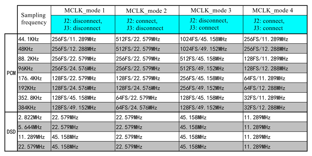

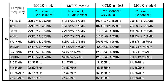

Hey @RedEyeNinja,
DSD Playback Dropout
Your observation that DSD playback stops after a few tracks, followed by white noise or silence, is fully supported by the uploaded log:
  • ALSA reports underruns:
    ALSA lib pcm.c:8424:(snd_pcm_recover) underrun occurred
  • MPD indicates stream processing failures:
    player: Decoder is too slow; playing silence to avoid xrun
  • I²S interface issues are suspected:
    i2s: warning: unexpected frame size, possible clock mismatch
These are consistent with an unstable master clock or format transitions the DAC and Volumio stack cannot recover from cleanly.
Why This Is Happening
The Ustars Audio R19 board is not supported by any existing Volumio device-tree overlay. Its HDMI-style I²S output is non-standard, and there is no known kernel-level support or documentation available to configure it properly.
Jumper-controlled MCLK modes cannot signal the kernel to adapt clocks dynamically, which leads to issues when switching between PCM and DSD or between DSD sample rates.
This Is Outside Alpha Scope
The Volumio Bookworm Alpha is focused on ensuring base functionality and hardware compatibility that aligns with the upstream Linux kernel.
Boards like the Ustars Audio R19:
  • Are not part of the officially tested hardware
  • Lack upstream kernel support
  • Do not ship with a dtoverlay or standard identification
Requests for support of such boards should begin with the upstream kernel or manufacturer.
Volumio Can Still Assist
If you’re willing to proceed:
  • Please start a dedicated thread on the Volumio forums for the Ustars Audio R19.
  • Once that thread exists, we can help with:
    • Reviewing high-res photos or board scans
    • Pin-mapping the HDMI-style I²S connector
    • Drafting a minimal dtoverlay for testing
    • Guiding through manual clock and driver configuration
This avoids diluting the scope of the Alpha testing thread and provides a clear path for reproducible testing and community feedback.
Suggestions
  • Use coaxial or optical for PCM up to 192 kHz
  • Use I²S with fixed jumper settings only for DSD playback in DoP mode
  • Avoid switching formats mid-playback
  • Increase buffer sizes in Playback Options to reduce underrun risk

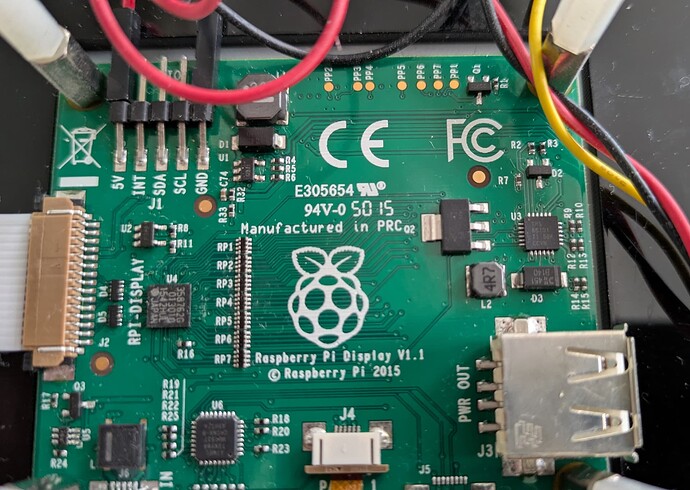

Hey @SimonE,
Thanks again for the thorough testing and follow-up - and for confirming that the restored userconfig.txt and volumioconfig.txt put things back to a stable state for audio, even though the screen still blanks after a restart.
You’re right: given that the exact same behavior occurs with your older v3.812 SD card, and that a full power cycle reliably restores the screen, this is now pointing very clearly to a hardware-related issue, not a software regression in the Bookworm-based 0.067 build.
Help Me Replicate and Investigate
When you have a moment, could you please collect the following hardware details, using the method from this Volumio community guide?
Guide: Identifying Your Raspberry Pi Board on Volumio – A Comprehensive Guide to Revision Codes
I’m specifically looking for:
  • Exact Raspberry Pi board revision
  • Official touchscreen PCB model and revision (should be printed on the back of the display control board)
  • Whether you’re using:
    • Original ribbon cable
    • GPIO power for the display
    • Or USB power splitter variant
This will help me try to replicate your setup here when I have the time (no promises - things are quite full during ALPHA).
Summary
At this stage, I am treating the issue as hardware-level:
  • Most likely due to early DSI init race or voltage holdover on older display hardware.
  • The workaround - full power cycle - is valid, safe, and confirms nothing is wrong with Bookworm Volumio itself.
  • Your logs show all plugins, audio routing, and network mounts behaving correctly after cold boot.
If you decide to replace the screen later, I’d love to know if the problem resolves entirely.
Thanks again for your help improving stability testing at this level - and glad to hear the system is solid overall.

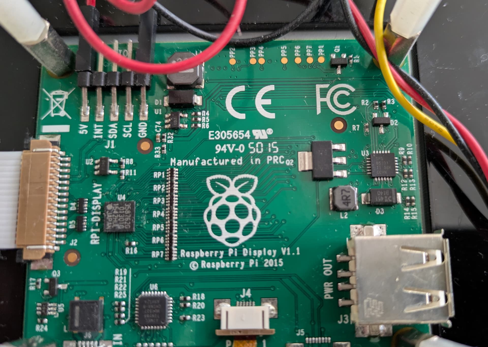

Hi @nerd,
Important to mention that after several attempts, a usercofig.txt of …
dtoverlay=vc4-kms-dsi-7inch
lcd_rotate=2
Ends up with a grey lit screen even after power on/off. All music and plugins work.
With
lcd_rotate=2
display_hdmi_rotate=2
Display (and everything else) works properly after power on/off.
Contents of /proc/cpuinfo
processor : 0
model name : ARMv7 Processor rev 3 (v7l)
BogoMIPS : 270.00
Features : half thumb fastmult vfp edsp neon vfpv3 tls vfpv4 idiva idivt vfpd32 lpae evtstrm crc32
CPU implementer : 0x41
CPU architecture: 7
CPU variant : 0x0
CPU part : 0xd08
CPU revision : 3
processor : 1
BogoMIPS : 270.00
CPU architecture: 7
CPU variant : 0x0
CPU part : 0xd08
CPU revision : 3
processor : 2
BogoMIPS : 270.00
CPU architecture: 7
CPU variant : 0x0
CPU part : 0xd08
CPU revision : 3
processor : 3
BogoMIPS : 270.00
CPU architecture: 7
CPU variant : 0x0
CPU part : 0xd08
CPU revision : 3
Hardware : BCM2711
Revision : c03112
Serial : 10000000a65e7bfe
Model : Raspberry Pi 4 Model B Rev 1.2
Contents of /proc/device-tree/compatible
raspberrypi,4-model-b brcm,bcm2711
Touchscreen info:
Raspberry Pi Display V1.1 2015
E305654 94V-0 5015
It is the original ribbon cable and it’s using GPIO power.
I’m in no hurry as the workaround is not a problem for me.
Thanks again,
Simon
