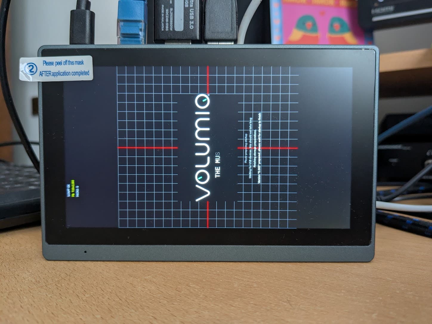

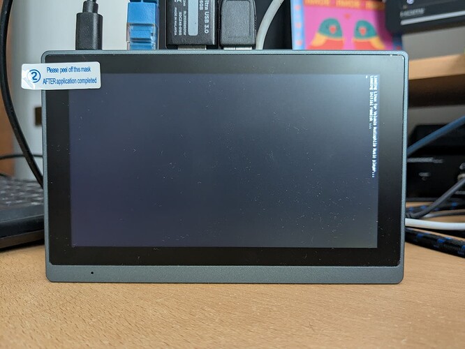

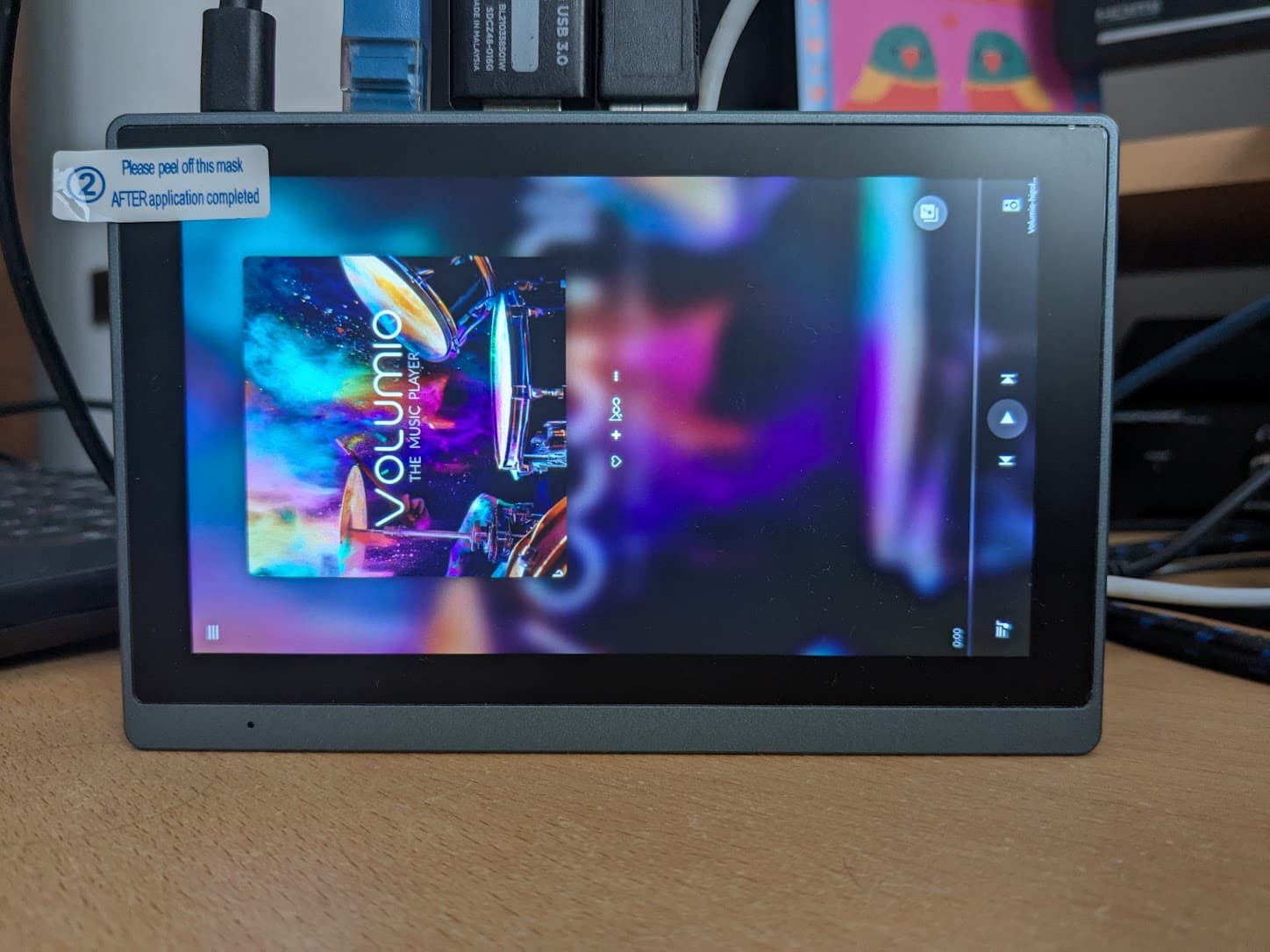

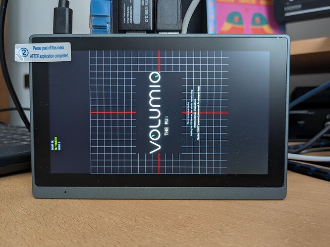

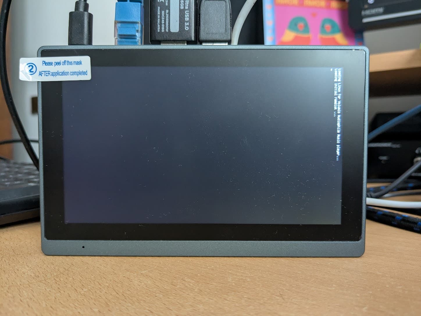

Higole 2 Pro
volumio v0.065
Onboard screen
boot images :
1st Conf wizard
network page empty!
Network
No wifi scan when hotspot enabled.
A manual wifi should be available in this case.
Eth cable mandatory…

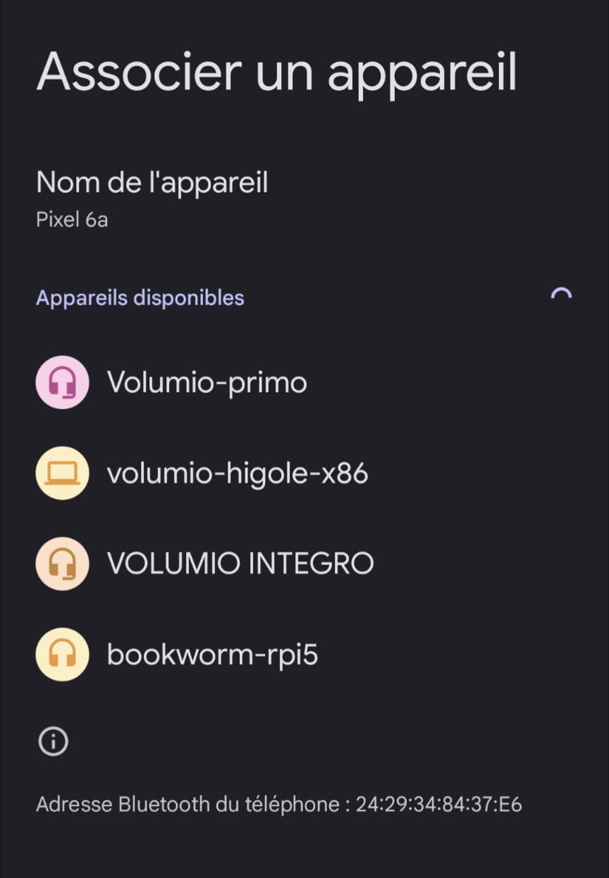

Audio
Internal audio ok + HW mixer auto configured
BT
ok but no volume control from volumio
Appears as a computer
Sources
Radio ok
Qobuz ok
