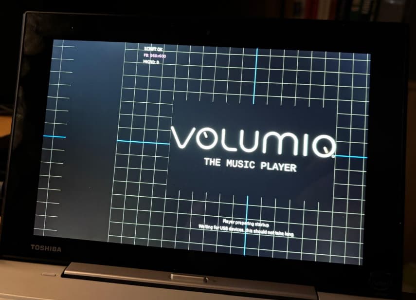

Tested with V0.065
Hardware:
  • Manufacturer: TOSHIBA
  • Model: 0700 / Type2 - Board Version /
  • Atomā„¢ Z3735F
  • SanDisk Corp. Ultra Fit 15GB
  • 10.1inch Capacitive Touch Display, DS1-1, 1920x1200 (WUXGA)
  • iFi Zen DAC V2
  • Internal Sound card

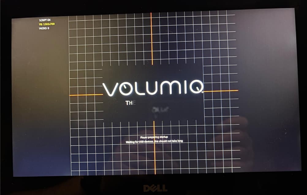

Tested with V0.065
Hardware:
  • Brand: Dell Latitude 3189 (x86)
  • Native resolution: 1366x768 (WXGA Wide)
  • Connected: eDP-1
  • Rotation: 0Deg
  • iFi Zen DAC V2

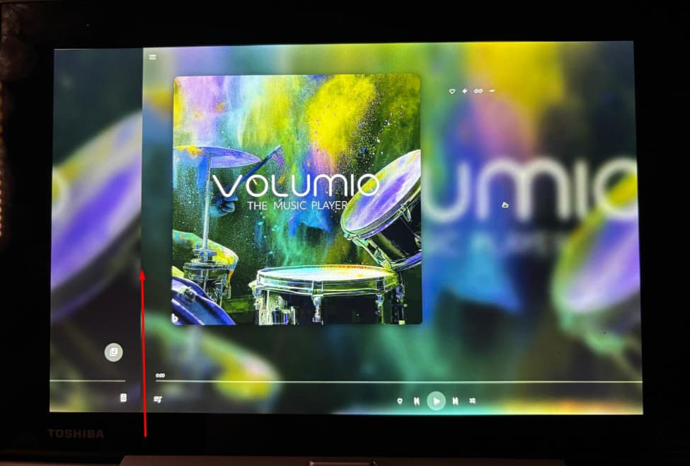

Display shift - this is very interesting indeed. Can you share logs and dmesg form this system please?

Hey @Wheaten,
And there is the silence - I think I will need to locate the exact panel details. No error in panel init = Front Porch in kernel module source is shifted - interesting!
