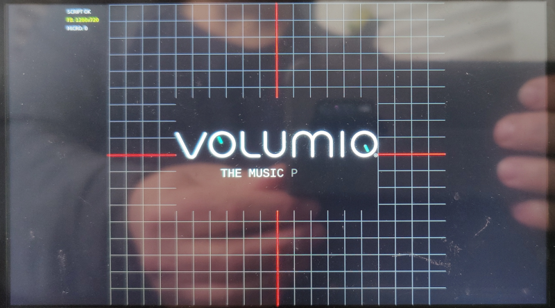

Have tried
video=DSI-1:720x1280M@60,rotate=270
As per your post.
Doesn’t change anything…
Ralf
Hey @rkorell,
Not sure what the issue could be.
Please share config.txt, volumioconfig.txt and userconfig.txt from /boot
Will try to reproduce over this weekend.
hI!
I have same setup and I only put this in my userconfig, nothing else. No other changes in other files.

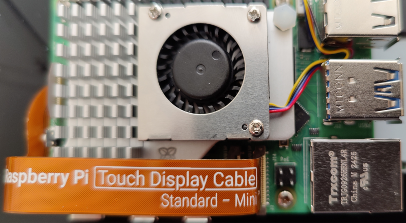

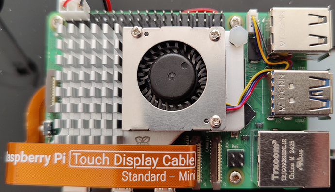

Something worth investigation. On Raspberry Pi 5 there are two physical DSI connectors. Can you access and confirm, which one is coupled with the DSI ribbon?
DSI-port 1.

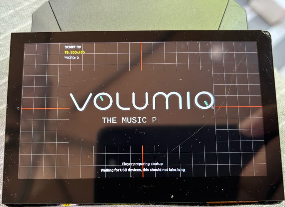

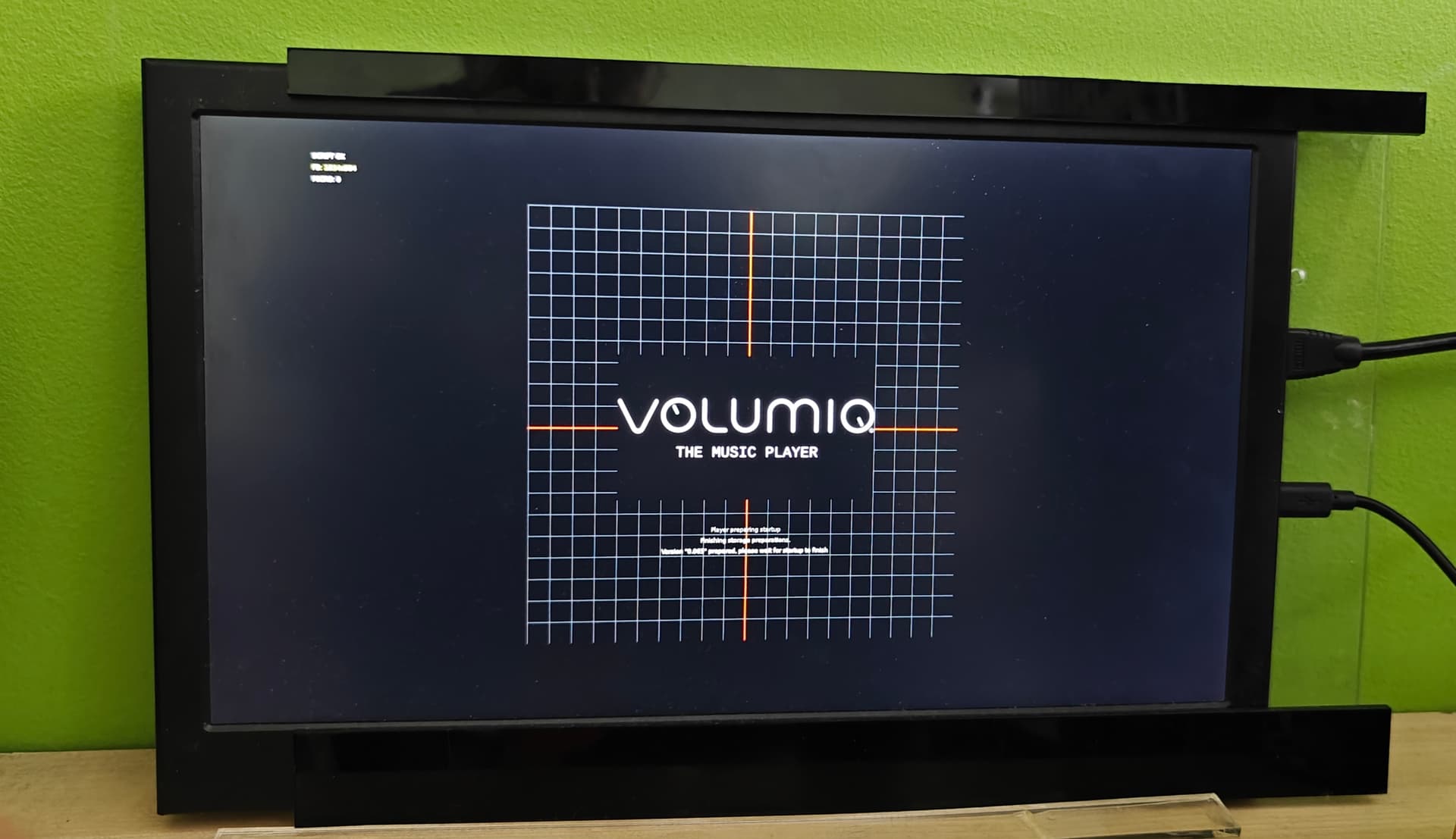

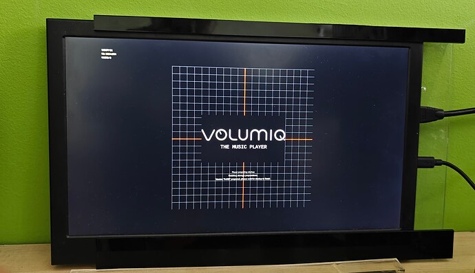

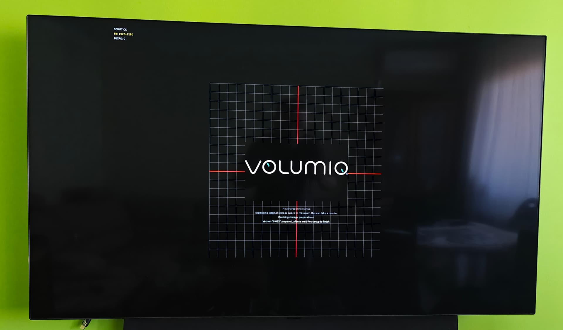

RPi4, HDMI, no HAT
1.3840x2160 (userconfig empty - displays as 1920x1280??)
2.1920x1080 (userconfig with monitor data. If it is empty it does not fill the entire screen)

Hey @Gelo5,
Thanks for the details and photos. A few notes to clarify what you’re seeing:
userconfig.txt.userconfig.txt is empty, the display service likely defers to a lower fallback resolution (e.g., 1920x1280) and fills what it can. Once you explicitly set a modeline or force a mode, the screen area behaves as expected.We’re evaluating a responsive background layer for HDMI displays - especially with touchscreen plugins - but for now it’s expected behavior on high-res external screens.
