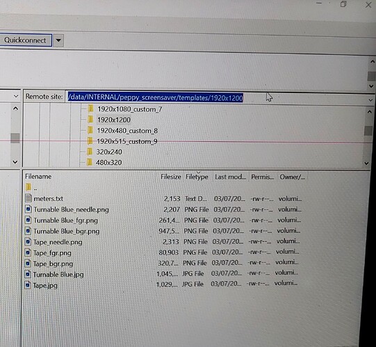

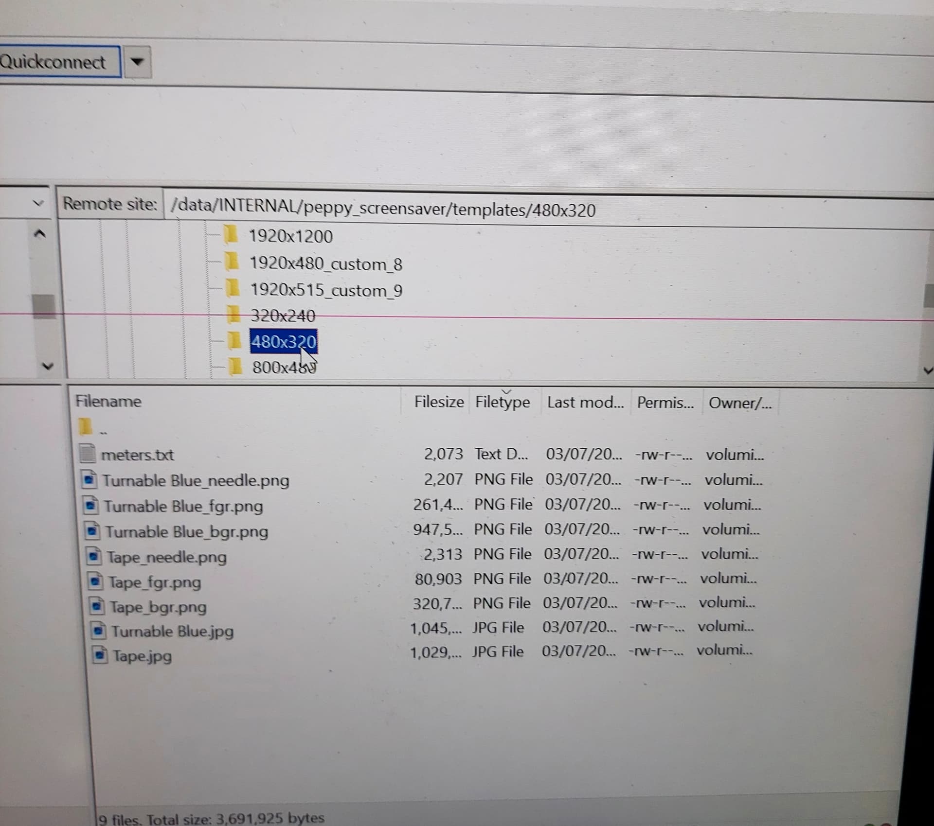

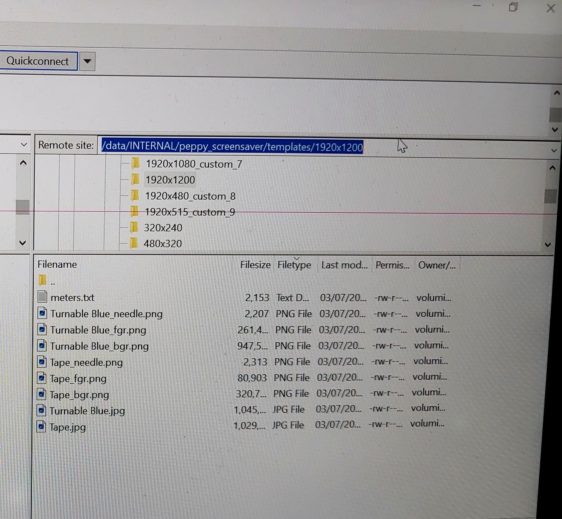

I tried following the approach of extracting files in /data/INTERNAL/peppy_screensaver/templates, but the 1920x1200 resolution does not appear in the peppymeter section.
I attempted modifying the 480x320 resolution file, but the display appears incorrectly sized/fitted on the screen.
I probably went wrong somewhere in the process.

unpack, copy the entire file named: 1920x1200_Gelo5 00-99… (do not rename to 1920x1200).
Thank you very much. i have done it. Please update it for me when you have time.

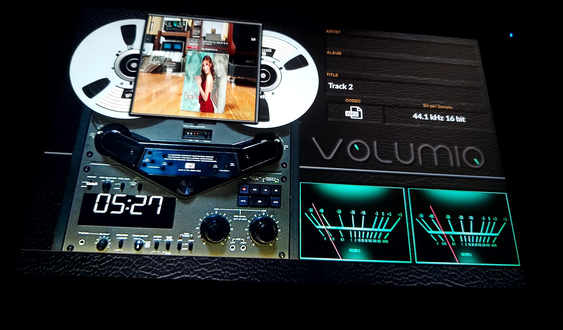

Change meters.txt (on tape skin - time is too high)
meters.zip (814 Bytes)

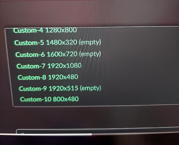

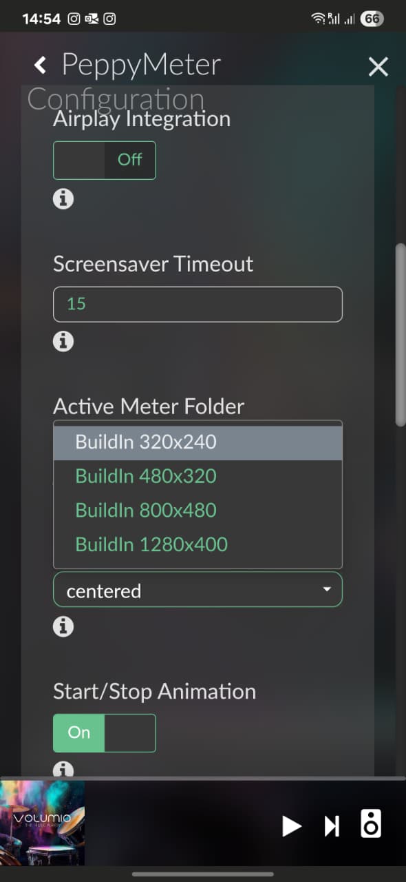

i installed plugin but 1020x600 not showing in
Gelo5
September 2, 2025, 10:18am
3467
Hi, @AntooZ
There are no skins for this resolution (1020x600). The closest one is 1024x600
45 SKINS 1024x600

@Gelo5 sorry it was a typing error, my display 7 inch 1024x600 resolution, i installed plugin as per the instruction , but in the settings there is no option to select (custom 1024x600)
AntooZ
September 2, 2025, 10:48am
3469
@Gelo5 rpi 4b 4gb , Volumio 3.832, peppy 2.2.1
Gelo5
September 2, 2025, 10:51am
3470
I don’t understand. How can that be? There is no built-in one either?
AntooZ
September 2, 2025, 10:56am
3472
is there anything i missed?
Gelo5
September 2, 2025, 10:57am
3473
