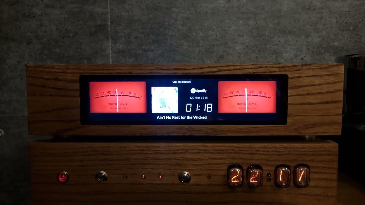

Thank you Master @Gelo5 for help and all advicess:
I’ve both up and running.
Peppymeter 1.3.9 beta
I instaled FusionDSP and tried with Spotify 4.0.4 plugin - meter not moved
I reinstalled Spotify to 4.0.3 plugin and meter moved… like Jagger -the same like here :
Project with PeppyMeter Screensaver Plugin for VOLUMIO v2.9xx and 3.0xx buster - #2365 by Gelo5
Turn off Fusion, reboot Volumio PM works fine.
