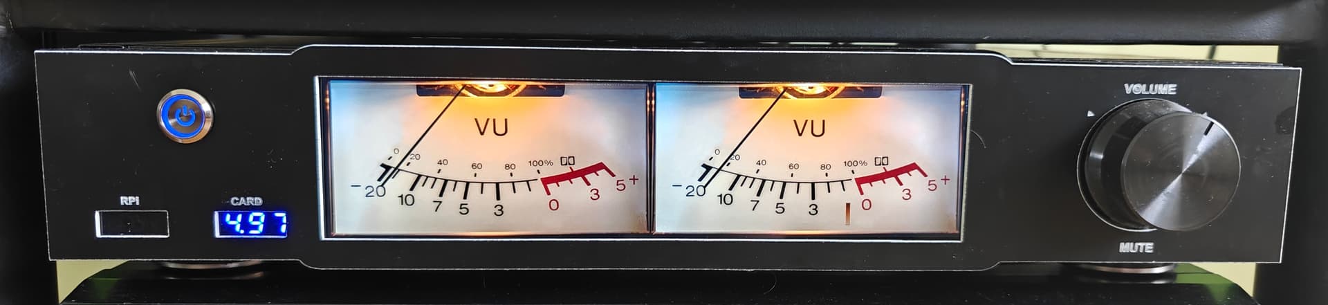

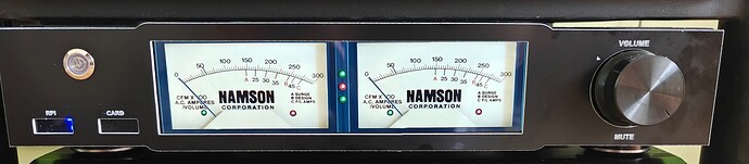

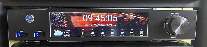

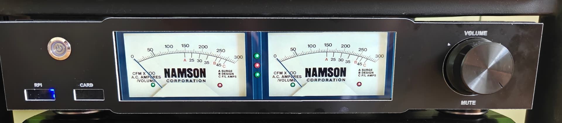

Thanks for the quick reply.
Can’t explain what happened, but after three more reboots I was able to store the settings and now have a working screen🙂
I am running a 3b+ and the screen is very similar to this one without the casing and has a Wisecoco sticker on the back: 8.8” HDMI
Next step is to install the now playing plugin and restore my old settings.
Have a great day.
I have the same screen. Just set the TouchDisplay to rotate 90 degrees. userconfig - empty
(RPI5).
ps. only the boot screen (logo) is rotated during startup

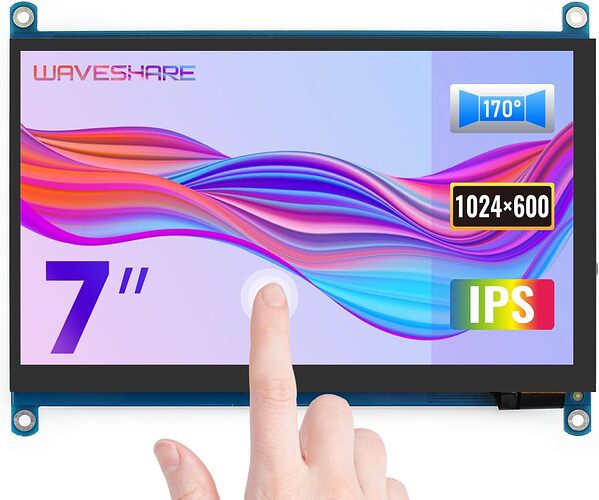

Hello everyone,
I just got into the topic of volumio and need some assitance with my setup. I bought a raspberry pi 5 with the waveshare 7" touch display.
This one to be specific:
I installed volumio (version 3.816) and the touch display plugin (version 3.5.1). The visuals are working via HDMI. My problem is that the touch display doesn’t work. I really tried to get this on my own and read almost the whole discussion in this community but couldn’t fix it. Here are some further information:
cat /boot/config.txt
### DO NOT EDIT THIS FILE ###
initramfs volumio.initrd
gpu_mem=128
gpu_mem_256=32
gpu_mem_512=32
gpu_mem_1024=128
max_usb_current=1
[pi5]
usb_max_current_enable=1
[all]
include volumioconfig.txt
include userconfig.txt
dtoverlay=hifiberry-digi-pro
cat /boot/userconfig.txt
hdmi_group=2
hdmi_mode=87
hdmi_cvt 1024 600 60 6 0 0 0
hdmi_drive=1
Can somebody help me troubleshoot this?
Thanks in advance

I was actually able to fix it myself. At first I thought it was a compatibility problem with the touch plugin, because I have seen a lot of posts about this. It wasn’t. Here is how I troublehooted it:
Possible Troubleshooting Steps
  1. Check if kernel registers inputdevice. Search for “input: … as /devices/…”
dmesg | grep -i input
  1. Check if usb-device is listed
lsusb
  1. Check if X11 rejects the touch inputs or not.
cat /var/log/Xorg.0.log | grep -i touch
It should look something like this if it works
bash-5.0# cat /var/log/Xorg.0.log | grep -i touch
[  1063.986] (**) WaveShare WS170120: Applying InputClass "libinput touchscreen catchall"
[  1063.986] (**) WaveShare WS170120: Applying InputClass "Touch rotation"
[  1064.050] (II) event0  - WaveShare WS170120: is tagged by udev as: Touchscreen
[  1064.050] (II) event0  - WaveShare WS170120: device is a touch device
[  1064.080] (II) XINPUT: Adding extended input device "WaveShare WS170120" (type: TOUCHSCREEN, id 6)
[  1064.142] (II) event0  - WaveShare WS170120: is tagged by udev as: Touchscreen
[  1064.142] (II) event0  - WaveShare WS170120: device is a touch device```
  1. Check if driver is installed. Search for “hid_multitouch”
lsmod | grep hid
  1. Check if the kernel-event-subsystem of your device gets the inputs via “evtest”
sudo apt-get install evtest
evtest
Select your device. It opens up a “listener” and shows any traffic coming from this device. I didn’t recevice any on my PI 5. So my issue was way deeper than the Volumio touch display plugin.
Solution
My Waveshare 7" HDMI touchscreen was detected by Volumio and listed correctly in lsusb and dmesg, but the touch functionality didn’t work — evtest showed no input events. The issue was resolved by adding hdmi_force_hotplug=1 and config_hdmi_boost=10 to /boot/userconfig.txt, which forced proper HDMI initialization and allowed the touch controller to fully activate.
Cause
The Raspberry Pi detected the touchscreen’s USB interface and loaded the appropriate drivers, but the touch controller didn’t send any input events because the HDMI signal wasn’t properly initialized during boot. Many touchscreen controllers require an active HDMI handshake to fully power up or exit standby; by default, if no display is detected, the Pi disables HDMI output, preventing the controller from completing its initialization.
Adding hdmi_force_hotplug=1 forces the Pi to enable HDMI even without a detected display, and config_hdmi_boost=10 strengthens the signal to ensure stable communication — together, these settings triggered proper HDMI activation, allowing the touch controller to start correctly and send events to the system.
