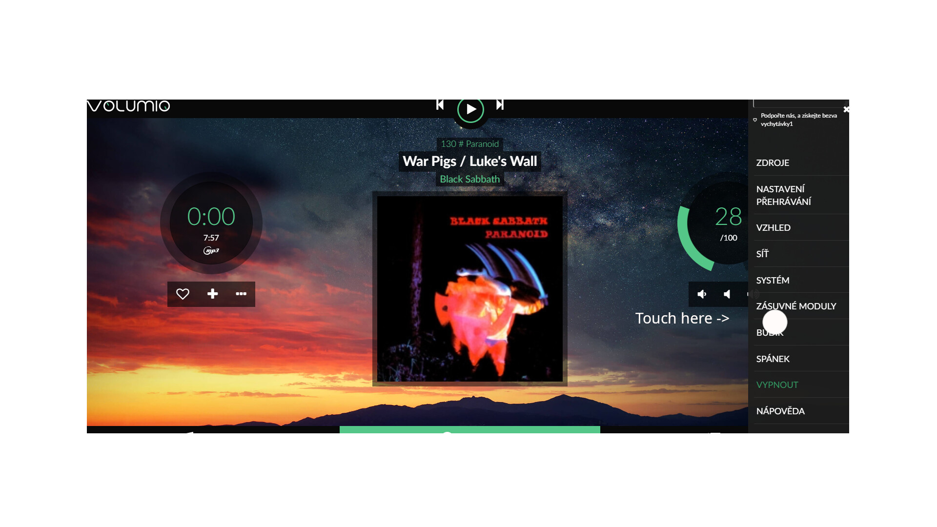

It seems that the rotation of the sensor does not correspond to the rotation of the screen. Are there any commands to rotate the sensor (by 180)

The display is now active and almost functional. It behaves as if the resolution was different. It just responds to touch in a different place than it should.
