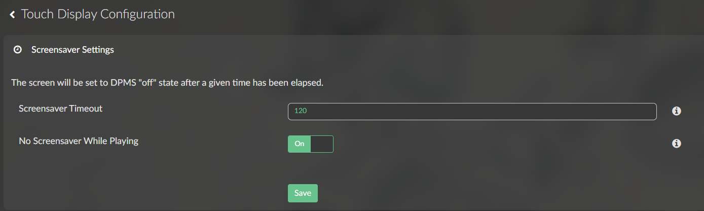

Is this possibly the screensaver? Does the display stay on with “Screensaver Timeout” set to 0?
I have set it to 0 already for the screensaver.

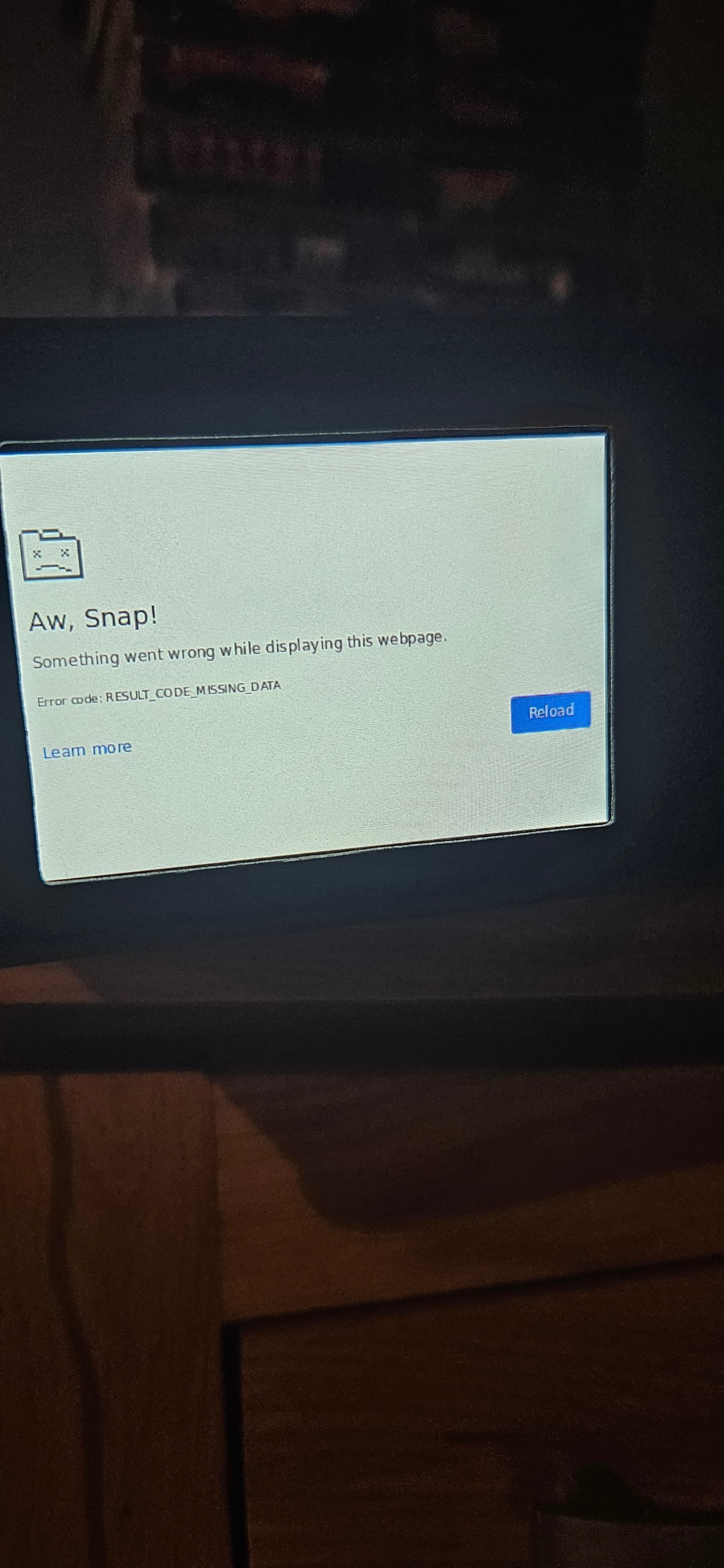

Update, enabling the gpu memory settings worked for a bit longer but hanged and got this message when touching the screen

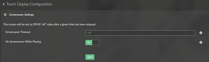

I have just edited the title of the thread to add my second question. How can I program the Raspberry to turn the LCD off after an arbitrary time, say one hour? Then how can I turn it back on? It has touch screen so it should be listening to a touch event. Or playing music might wake it up. Any suggestions? Thank you!
The touch display already has that feature build in.
Then when you start playing music it will become active again.
