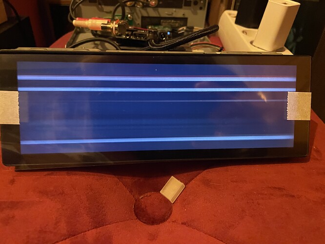

Regarding your previous entries in “/boot/userconfig.txt”:
Did you set framebuffer_width=1024 on purpose or should it be framebuffer_width=1280?
After dtoverlay=vc4-kms-v3d-pi didn’t help I suggest to remove hdmi_timings=400 0 100 10 140 1280 10 20 20 2 0 0 0 60 0 43000000 3.
Thanks for the hint at framebuffers…
I have now commented out the hdmi_timings, unfortunately this fashion resulted in this screen…
You might try the “hdmi_timings” line alternatively to “hdmi_cvt”.
BTW: Where are the values you are using with “hdmi_timings” from?
I’ll try these parameters as well;
I got the settings for hdmi timings from the notes for waveshere 7.9" display because on the dealer page "compatible with Raspberry Pi (waveshare) is/was noted, otherwise unfortunately no info about display except 1280x400 HDMI ISP model available
