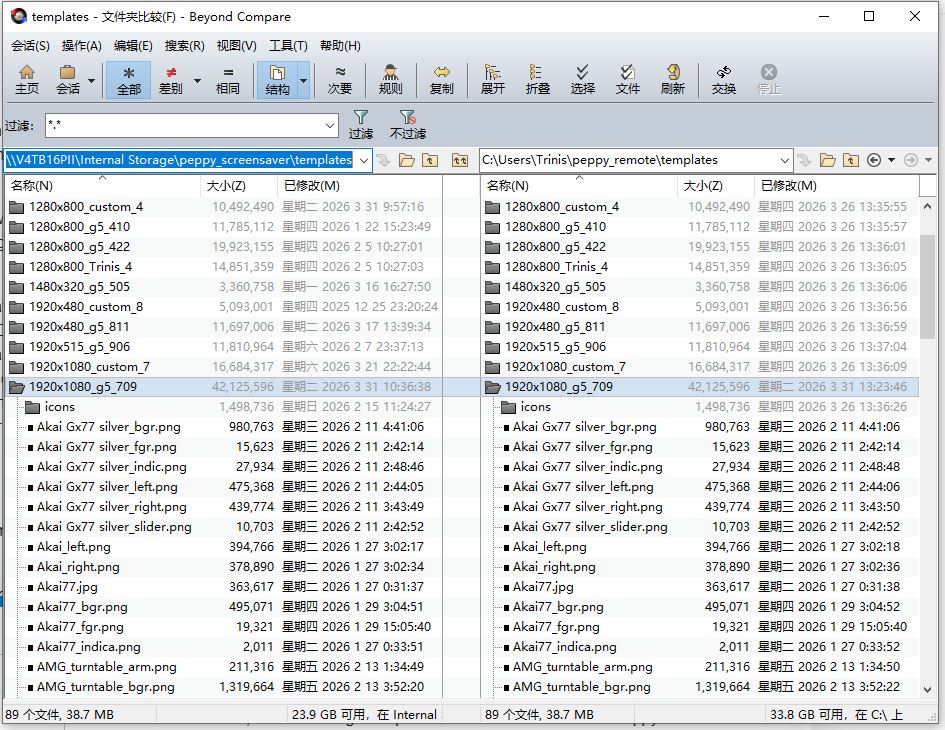

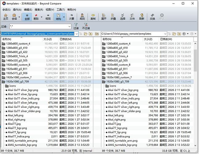

Previously, I used WinSCR for uploading, but it wasn’t very efficient. I’ve meticulously refined many templates, cleaning up font size and position, bitmap artifacts, and smearing marks in the background to make them as aesthetically pleasing and comfortable as possible. Therefore, I need to update multiple times across multiple devices and two system templates on each device. I use Beyond Compare (available for Mac) for file synchronization, which clearly shows the latest changes. On Windows, I can synchronize to other devices using the template on the NAS as the standard. For Volumio, I need to modify the permissions of /data/Internal Storage/peppy_screensaver/templates to 777(The folder /data/Internal Storage/peppy_screensaver is owned by Volumio), allowing me to update templates as efficiently as on Windows. Therefore, I’m wondering if it’s possible to add a switch in the PeppyMeter screensaver settings to enable/disable updates via SMB (777-644), or even a simpler logic where entering the settings enables updates and exiting disables them.
What do you think?

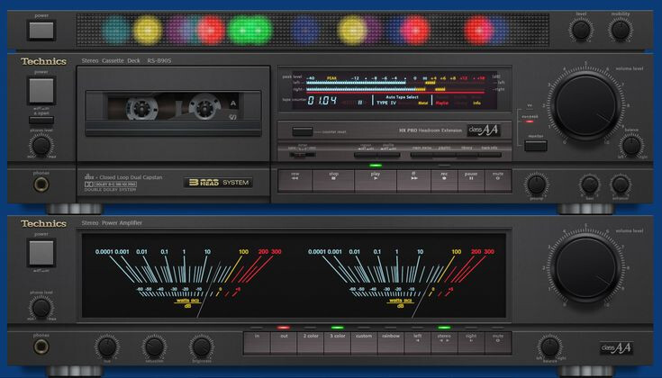

Excellent stuff possible with this plugin. I use AIMP a lot and was wondering if there was a way to port / recreate skins like this? These skins are made by users in Russia, probably not too keen in open sourcing the designs :frowning:
They have about 500+ skins
https://aimp.ru/?do=catalog&os=desktop&id=0
It’s possible, it’s not terribly difficult, but… Peppymeter can’t use linear and circular meters at the same time (@nerd :crazy_face:)
Those were just samples among many. Most of the skins are just one 1 main component, with UV or Spectrum but not both. Also the deck components can be independently hidden in AIMP.

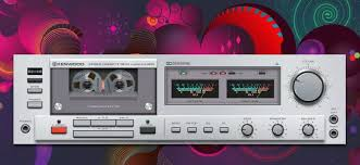

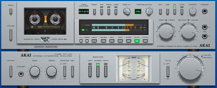

Better example with just main component.
