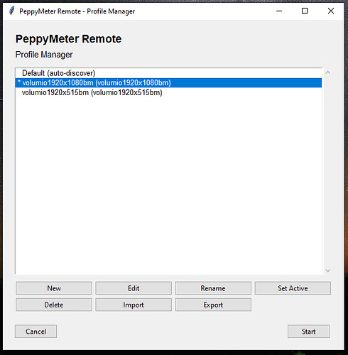

Multi-Profile Support
The remote client now supports multiple profiles. Each profile is a complete configuration - server, display, templates, spectrum, debug. Entirely independent.
Why? Because some of you have more than one Volumio box. Some of you want a kiosk display in the kitchen locked to one theme and a desktop window in the office following the server. Some of you just like having options. I do not judge. I enable. @Gelo5 - you know who!
The config file has been upgraded to version 2. Your existing config.json is auto-migrated on first run. You will not notice. That is the point.
From the command line:
peppy_remote --profile “Living Room”
peppy_remote -p workshop

The configuration wizard has been completely rewritten. Both GUI and CLI versions.
GUI: When you edit an existing profile, you get a tabbed view - Server, Display, Templates, Theme, Spectrum, Debug - click directly on what you want to change. No more stepping through six screens to change the decay rate. New profiles still use the linear step-by-step wizard because you presumably need to fill in everything.
CLI: Full profile manager at the top level. List profiles, create new, edit, rename, delete, import, export, set active. The edit menu now has 17 items including trace_wizard for debugging the wizard itself, because debugging a debugger is the natural conclusion of this project’s trajectory.
Both wizards now support SMB mount from inside the theme selection step. If your templates are on the server and the share is not mounted, the wizard will mount it for you so you can browse and select themes. This works on both Linux and Windows.
Profile Export and Import
Export a profile to a JSON file. Copy it to another machine. Import it. The file is human-readable and editable so you can adjust template paths before importing on a different platform.
Cross-platform transfers (Windows to Linux or vice versa) will flag path warnings on import. Fix the paths in the editor or in the JSON file. The client does not guess - it warns and lets you decide.
