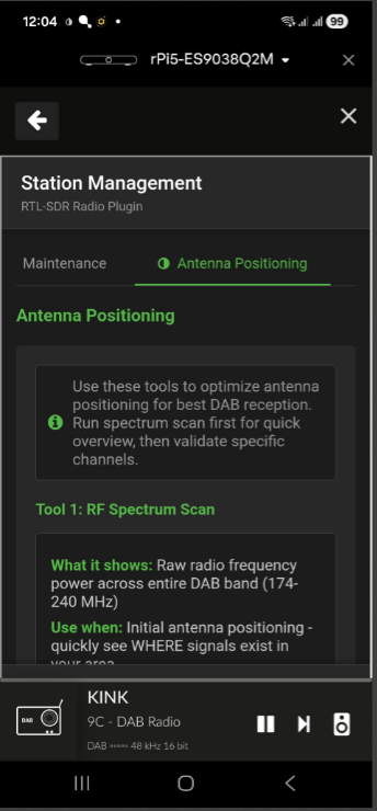

I finally received my dongle and installed the plugin yesterday. DAB+ reception is great, FM not so much (I did not search for the best spot to place the antenna anyway, so it’s fine for me).
The only thing I noticed: The MOT Slideshow does not show up on my display. I either get artwork looked up on the internet, or the default dab icon.
In my car, I do see the slideshow on the different stations. What could I do wrong here?
Thanks in advance, and keep up the excellent work :+1:
Hey @gfloener,
Welcome - glad DAB+ is working well for you.
MOT Slideshow is part of the DAB specification and your car does receive it - but that is because your car has a dedicated DAB chip with licensed decoding technology built in. Companies like Gracenote provide this to automotive manufacturers under enterprise licensing agreements.
How much does that cost? Gracenote charges streaming services around $5,000-7,500 per month with 5% annual increases and exclusivity requirements - you cannot combine their data with any other source. Automotive OEM licensing is custom negotiated per-vehicle, and car manufacturers pay significant fees for the privilege.
This is not available to open source projects. Our decoder (dab-cmdline) focuses on audio extraction. It does not decode MOT slideshow data.
What we do instead: parse the DLS text metadata that stations broadcast (artist/title information) and look up artwork via Last.fm. This works well for music but depends entirely on what text the station transmits. If a station only broadcasts its name with no track information, there is nothing to look up.
If you are getting the default DAB icon more often than expected, check your Artwork Confidence setting in plugin settings. Lower values (toward 0%) will attempt lookups on more ambiguous metadata - you may get more artwork but also more false matches. Higher values are stricter. Start around 60% and adjust based on results.
You are not doing anything wrong - this is a fundamental difference between consumer hardware with licensed proprietary decoders and open source software using SDR.

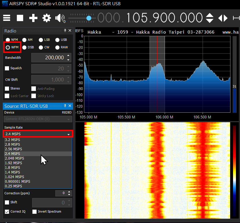

First, I tested FM reception on Windows 10 using SDR# and SDR++, and the results were very good.
When connecting the RTL-SDR to RPi 5 + Volumio plugin, I found that I had to increase the FM Gain to 80 or 100 in order to scan FM stations.
However, the scan results were not very accurate, so I eventually manually added the stations instead.
I am using a UGreen 25 cm USB extension cable (aluminum braid) connected to the RPi 5. Because my Pi is connected to a Waveshare 5.5" AMOLED display, and Volumio is also running from a USB flash drive, I suspect there may be significant interference.
Compared to using the same antenna on a PC, the FM audio quality on the Pi sounds amplified and distorted.
I tried various FM Gain settings, but it did not help much.
With the same antenna position, the audio quality on the PC is clean and undistorted.
I would like to ask whether the FM Gain setting in this plugin corresponds to the RF Gain in SDR# on a PC, or is it simply a percentage-based value?
In SDR#, RF Gain is shown in dB, and the maximum value is 49.6 dB.
I usually set it around 16–20 dB, which gives very good FM audio quality.
Additionally, when I enable Tuner AGC in SDR#, the audio becomes over-amplified and distorted, which sounds very similar to what I hear on the Pi. I am not sure whether Tuner AGC in this plugin is enabled or disabled by default.

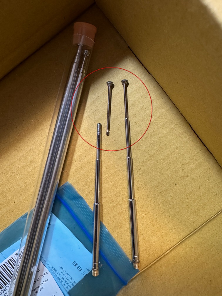

Finally, a reminder to everyone:
Do not pull the small antenna too hard when adjusting it.

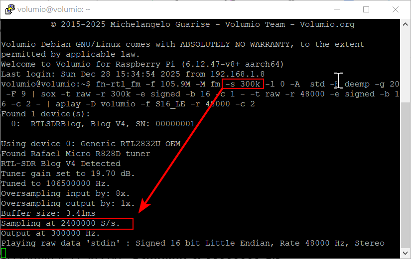

Hi ! @nerd
Thanks for the help !
According to the documentation at
https://manpages.ubuntu.com/manpages/jammy/man1/rtl_fm.1.html
the recommended parameters for wbfm are:
[-M modulation (default: fm)]
fm, wbfm, raw, am, usb, lsb
wbfm == -M fm -s 170k -o 4 -A fast -r 32k -l 0 -E deemp
raw mode outputs 2x16 bit IQ pairs
When using the original settings, I observed the following:
Oversampling input by: 8x.
Oversampling output by: 1x.
Sampling at 1368000 S/s.
Output at 171000 Hz.
With this configuration, high-frequency distortion and clipping occur.
After adding the -o 4 parameter
[-o oversampling (default: 1, 4 recommended)]:
Oversampling input by: 4x.
Oversampling output by: 4x.
Sampling at 2736000 S/s.
The audio becomes normal, with no high-frequency distortion.
After additionally adding the -s 200k parameter
[-s sample_rate (default: 24k)]:
Sampling at 3200000 S/s.
Output at 200000 Hz.
The sound quality feels even better.
However, I am not sure whether this would have a negative impact on slower hardware such as the RPi 3.
Additional notes
  • Adding -E deemp slightly reduces the boosted high frequencies,
    but it is not related to the high-frequency clipping issue.
  • On slower machines, -A fast seems to be recommended.
    On the RPi 5, however, I cannot hear any noticeable difference between -A fast and -A std.
  • When using -M wbfm, I experience intermittent playback that sounds like fast-forwarding. I do not know how to fix this yet, and currently it seems that only -M fm works reliably. ( Edit : if you use -M wbfm, the default -r = 32k, you have to change it to 48k to make it work )
Conclusion
High-frequency distortion is not strongly related to RF gain or de-emphasis,
but is instead related to the sampling rate (S/s).
By changing the oversampling factor to 4 (adding -o 4),
the sampling rate increases from 1,368,000 S/s to 2,736,000 S/s,
which greatly improves sound quality and eliminates distortion.
When the sample rate is increased from 171 kHz to 200 kHz (using -s 200k), the output changes from 171,000 Hz to 200,000 Hz,
and the sound subjectively feels even better.
There does not appear to be a stereo parameter, but at least the high-frequency distortion issue has been resolved.
Thank you!
Edit :
I found that 4× oversampling appears to be buggy.
If I use -s 240k instead of -o 4, the output shows:
Buffer size: 4.27 ms
Sampling at 1,920,000 S/s
Output at 240,000 Hz
With this setup, the sound quality is noticeably better than when using -o 4.
The following command gives me the best results so far:
fn-rtl_fm -f 98.1M -M fm -s 240k -l 0 -A std -E deemp -g 20 -F 9 |
sox -t raw -r 240k -e signed -b 16 -c 1 -
-t raw -r 48000 -e signed -b 16 -c 2 - |
aplay -D volumio -f S16_LE -r 48000 -c 2
This setup seems to provide the cleanest and least distorted audio on my system.

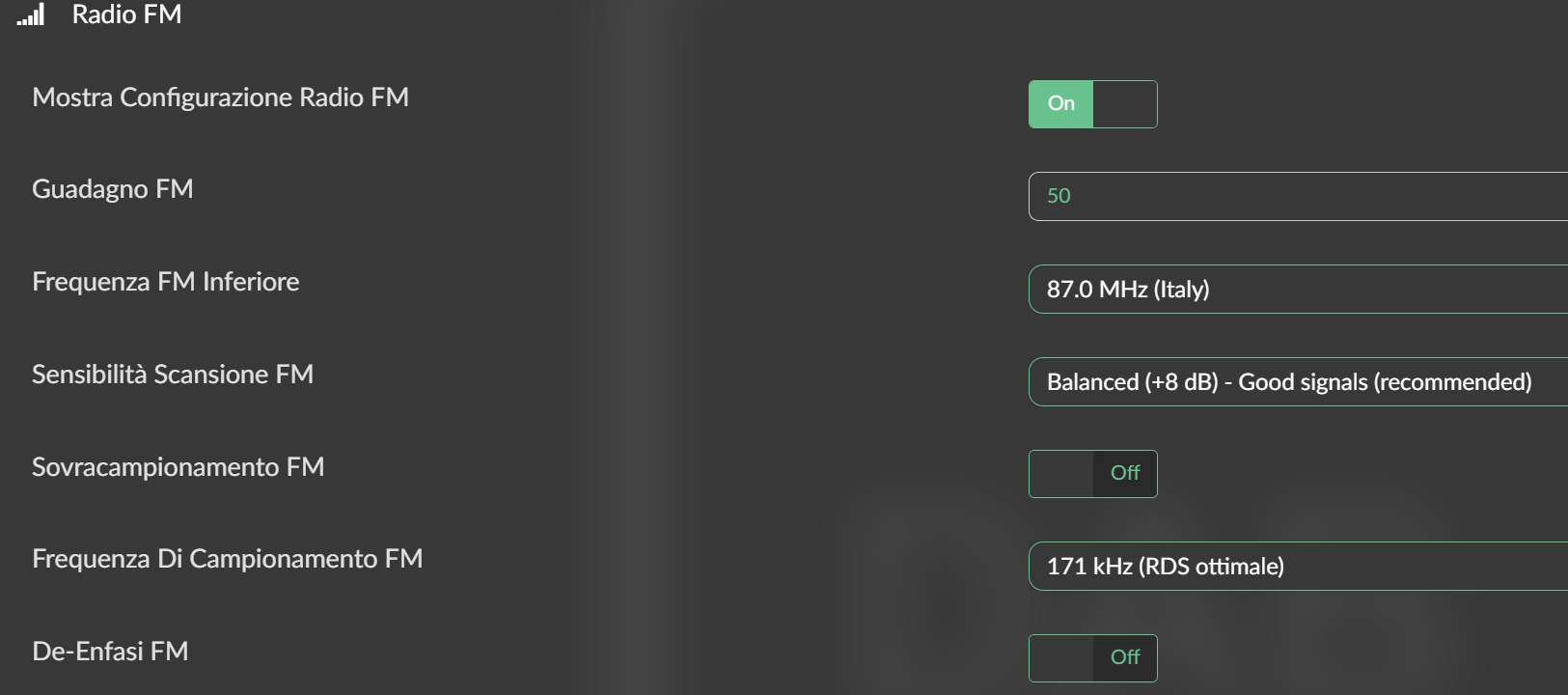

RTL-SDR Radio v1.3.6 - FM Audio Quality Options
New release with configurable FM reception settings based on community feedback.
What’s New
Three new options in FM Radio configuration:
Setting Options Default
FM Oversampling On/Off Off
FM Sample Rate 171k / 200k / 240k 171k
FM De-emphasis On/Off Off
Why These Settings?
User @dewen reported FM audio distortion in Taiwan that didn’t occur in UK testing. Investigation revealed regional differences in FM signal characteristics require different reception parameters.
The defaults are optimized for Europe/UK with weaker signals and full RDS support. Users in strong signal regions may benefit from different settings.
Understanding the Trade-offs
Setting Benefit Cost
Oversampling ON Reduces audio distortion Degrades RDS decoding
Higher sample rate Improves audio quality Reduces RDS reliability
De-emphasis ON Reduces high-frequency harshness None (standard in EU/Asia/AU)
RDS includes: Station name, radiotext, now playing info, signal strength indicator

From the SSH terminal, I can see “Sampling at xxxxxxxx S/s”.
In my testing, this value has a noticeable impact on audio quality. Higher generally sounds better, but if it gets too high (e.g. 3,200,000 S/s), noise starts to appear.
On SDR#, the default 2,400,000 S/s gives me the best balance of quality and noise.
Sample rate vs. reported S/s in my tests:
171 kHz → 1,368,000 S/s (oversampling ON → 2,736,000)
200 kHz → 1,600,000 S/s (oversampling ON → 3,200,000, noisy)
240 kHz → 1,920,000 S/s (oversampling ON → “Donald Duck” sound)
300 kHz → 2,400,000 S/s (oversampling ON → no audio)
To match SDR#’s 2,400,000 S/s,
300 kHz with oversampling OFF gives the cleanest result in my setup.
  • Oversampling: OFF
  • Sample Rate: 300k
  • De-emphasis: ON
  • FM gain: can be adjusted manually; I have it set to 20.
Could you kindly consider adding a 300 kHz sample rate option in a future update?
Thank you very much!

Hi @nerd ,
Finally, after trying several times, I realized the problem was the settings’ low sensitivity. By increasing the gain to 60 dB and the scan sensitivity to +3 dB (very sensitive), I was able to successfully complete the scan, finding over 40 stations.
The problem now is that the frequencies are all wrong, generally 100 kHz lower than the actual ones…
I looked in the code and found a scan interval of 125 kHz. This seems strange to me, since the channel spacing in Italy is 200 kHz (so at least in multiples of 100 kHz). Could this be the cause? By the way, when I run the command from the shell, I see that the actual spacing is different from the requested one (I think I read something within 40 kHz, but I don’t quite understand…).
I tried changing the value in the code, setting it to, for example, 50 kHz or 100 kHz, but the frequencies identified by the spectral analysis are always incorrect, I imagine due to the incorrect steps.
With programs like SDR Console and similar programs, scanning occurs differently and much more efficiently…
I’d also like to point out other things that don’t seem correct to me:
  • During playback, the station’s archived name is displayed on the screen, not the name taken from RDS.
  • It’s not possible to easily manually adjust the frequency; for example, it would be better to use the track - / track + buttons to adjust the frequency, perhaps in 5 or 10 kHz steps, which can be set in setup.
  • There’s no interface for manual tuning or manual scanning (simple, not in setup). I understand this plugin is heavily oriented toward DAB, but here (and probably in other countries too) DAB isn’t yet widespread, and the main source is FM.
    Thanks for the great work, best regards

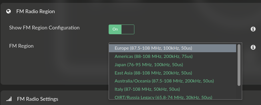

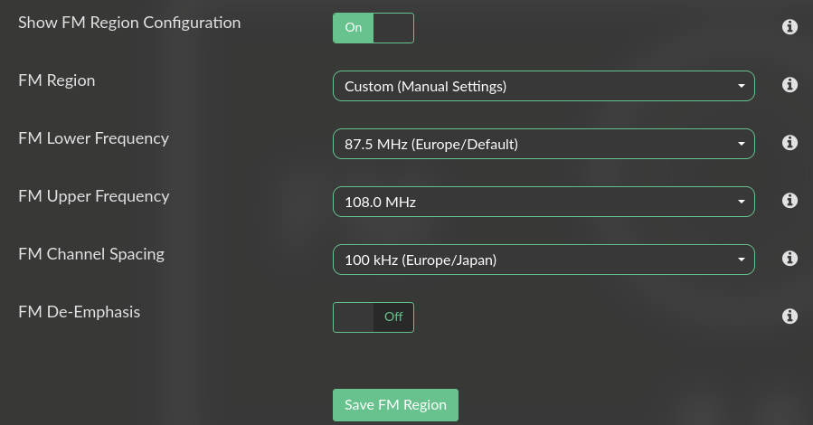

v1.3.8 - FM Regional Standards
This beta introduces FM regional presets for accurate station detection across different broadcast standards.
New Features
FM Radio Region section with 8 presets:
  • Europe (87.5-108 MHz, 100kHz spacing, 50us de-emphasis)
  • Americas (88-108 MHz, 200kHz spacing, 75us de-emphasis)
  • Japan (76-95 MHz, 100kHz spacing, 50us de-emphasis)
  • East Asia (88-108 MHz, 200kHz spacing, 50us de-emphasis)
  • Australia/Oceania (87.5-108 MHz, 200kHz spacing, 50us de-emphasis)
  • Italy (87-108 MHz, 50kHz spacing, 50us de-emphasis)
  • OIRT/Russia Legacy (65.8-74 MHz, 30kHz spacing, 50us de-emphasis)
  • Custom (manual override fields)
Selecting a region automatically applies the correct frequency band, channel spacing, and de-emphasis for your location. The scan will detect stations at their exact frequencies rather than rounding to 100kHz grid.
UI Changes
Settings are now split into two sections:
  • FM Radio Region - configure your broadcast region
  • FM Radio Settings - gain, sample rate, oversampling, scan
The Region section has its own show/hide toggle. When a preset region is selected, manual override fields are hidden. Select “Custom” to reveal them for non-standard configurations.
Bug Fixes
  • Fixed 50kHz frequency precision (Italy users: 95.75 MHz no longer rounds to 95.8 MHz)
  • Fixed frequency comparison logic throughout playback and favorites
Note
After changing region, a page refresh (F5) is required to update visible fields. This is a Volumio framework limitation.
Installation
Available via beta channel or manual install. After upgrading, clear FM stations and rescan to benefit from correct regional spacing.
